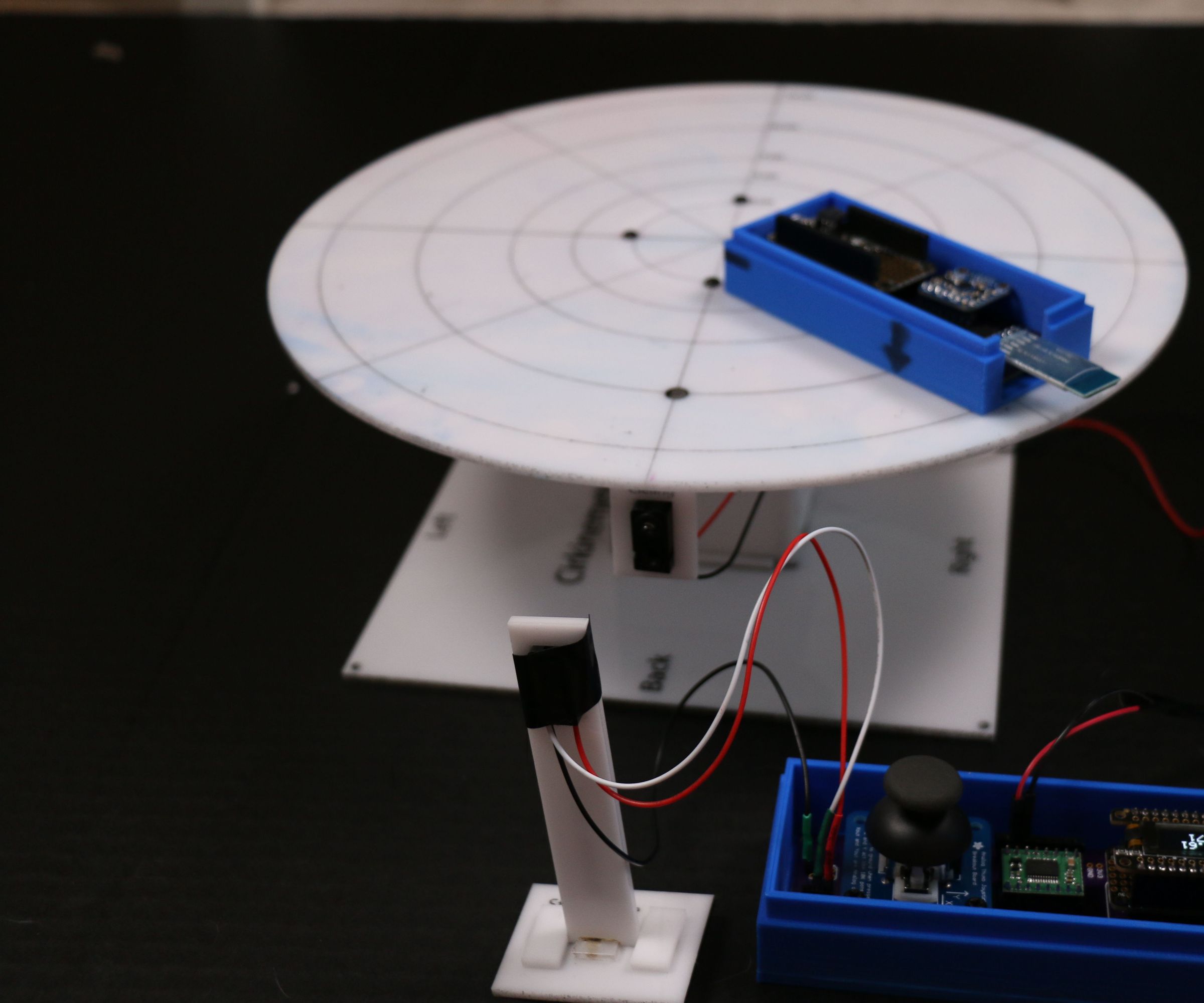

Step 7: 3D Printed Container/Assembly Tips
Finally, your E.M.F. Meter will need a container. The STL files for the two parts of the container are attached above. The model for the container and lid can also be found on thingiverse.
I receive prints by ordering them through 3Dhubs.com and use pla plastic. However, if you have 3d printer, yourself, feel free to use it (I can't guarantee personal printer quality).
This enclosure's screw holes are meant to fit the screw holes of the TFT featherwing, which are M2.5 screws.
When assembling the EMF Meter with its enclosure, make sure that:
  1. TFT Featherwing is screwed on TOP of the container (as seen in the image below)
  2. The ADS1115 featherwing is on the inside of the container
  3. The indent on the floor portion of the container is facing in the direction of the ADS1115 featherwing, as seen in two of the images.
