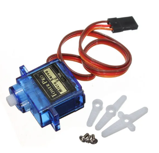

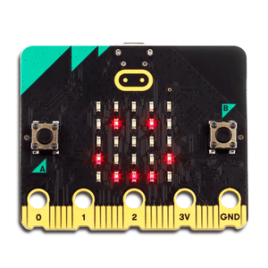

Micro:bit + servo SG90 + expansion board + 3 AAA batteries (4,5v) (or 5v power bank)

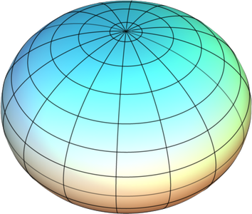

Step 4: The Earth Is Not Flat, But It’s Not a Sphere Either
Starting from the time it was established that the Earth is round, the alternative to representing it on paper was to preserve its spherical reproduction through globes. However, these illustrated spheres, due to their small size, were so lacking in detail that they had little practical use.
Maps, in fact, are not scale reproductions of reality but projections—representations that aim to be as realistic as possible of the Earth's irregular surface relief.
The geometric figure that best describes our planet is not a sphere but an ellipsoid, a shape obtained by slightly flattening a sphere at the poles. This deformation is caused by the Earth's rotation, as the equator, being farther from the Earth's axis, experiences a stronger centrifugal acceleration compared to regions near the poles.
The effect is similar to how a pizza chef stretches pizza dough by spinning it. The flattening is very slight—just 21 km. That might seem like a lot, but it’s negligible when compared to the Earth’s radius of over 6,300 km.

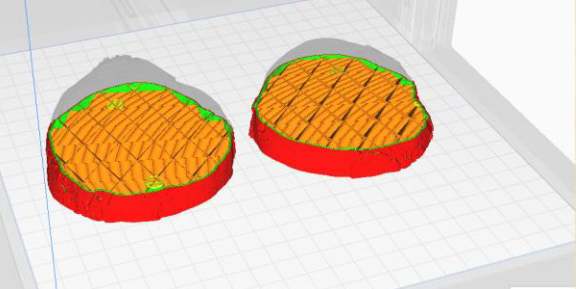

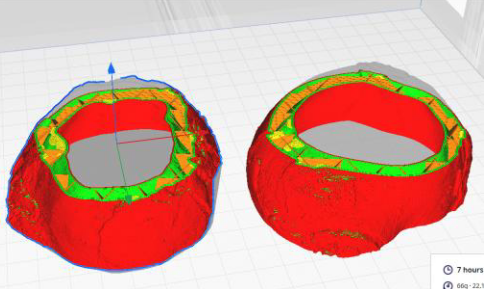

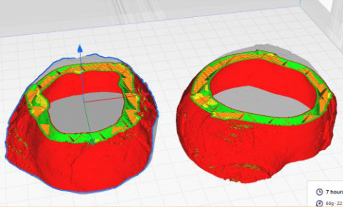

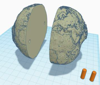

Step 7: Let's 3D Print the Geoid!
Problem Solving
Questions:
  1. Can I print the entire geoid?
  2. If I choose to print the two hollow halves, already available in .STL format, what precautions should I take?
Answers:
  1. Printing the entire model is not recommended. I can split it in half using Tinkercad (possibly aligning with the equator!) and then print the two parts to glue together afterward.
  2. Problem: The .STL file of the entire geoid cannot be imported into Tinkercad.
  3. Cause: The model is too complex or excessively large.
  4. Solution: Use an online tool to simplify and reduce its size (e.g., "Mesh Simplification").
  5. I can decide to enable support structures if no specific instructions are provided.

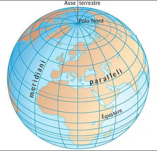

Step 8: Meridians and Parallels
The abstract figure of the "reference ellipsoid" is used to define projections that map each point on the ellipsoid to a point on the two-dimensional plane of a map. The first step in transferring data from the Earth's surface to a flat plane involves drawing a geographic grid that virtually wraps around the Earth's surface.
The grid consists of elements with two familiar names: meridians and parallels.
  1. Meridians are semicircles of equal length (about 20,000 kilometers) that connect the two poles. While theoretically infinite, by convention, 360 meridians are considered, one for each degree of the Earth's complete rotation.
  2. Parallels, on the other hand, are circles that connect points equidistant from the poles. They have different lengths but exist in pairs—one in the northern hemisphere and one in the southern hemisphere. Like meridians, parallels are infinite, but starting from the Equator, which is the largest parallel, 90 parallels are numbered in the northern hemisphere and another 90 in the southern hemisphere.
Every point on Earth is intersected by a meridian and a parallel that define its position. Each point can be identified using geographic coordinates:
  1. Latitude, which is the angular distance of a point from the Equator, measured north or south.
  2. Longitude, which is the angular distance from a prime meridian. By convention, the prime meridian is the Greenwich Meridian, near London, home to a famous astronomical observatory.
Each point on Earth is thus represented by a pair of angular coordinates.

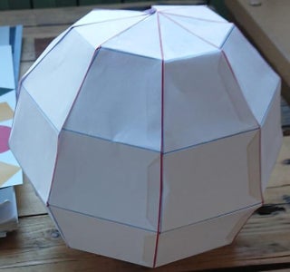

Step 10: Pencil, Paper, and Scissors!
Objective: Explore meridians and parallels creatively while developing analytical skills, using simple materials.
How can I create a (simplified) sphere using paper?
To build a paper sphere, it’s essential to consider its 2D development (the flattened version of the shape). Together with the students, we brainstorm which geometric profiles can be used to construct a sphere. These can include:
  1. Strips or bands arranged in a globe-like structure.
  2. Circular or petal-like segments that, when assembled, create a 3D form.
The individual parts can then be glued or taped together.
Steps to Experiment:
  1. Visualize the Shape: Begin by drawing simple shapes that can form a sphere when folded or assembled.
  2. Cut and Assemble: Use scissors to cut out the chosen profiles and experiment with joining them into a spherical shape.
  3. Refine the Structure: Test different patterns and learn from any imperfections.
Personalization with TemplateMaker.nl:
After experimenting with hand-drawn designs, introduce TemplateMaker.nl, a powerful online tool to generate geometric templates.
  1. Students can discover how parameters (like the number of strips or petals) affect the shape.
  2. The activity shows the value of customization and the impact of precise measurements in creating functional designs.
Ready? 1, 2, 3... Let’s experiment!

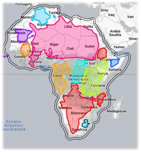

How many countries can we fit into Africa?
Using the website TheTrueSize.com, let’s place as many countries as we can within the African continent, orienting them as we like. Let’s fit them together like a puzzle!
From the document published at this link, we can realize a possible optimal solution... and just how large Africa really is!

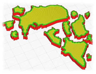

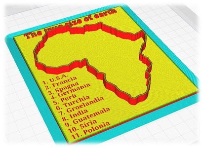

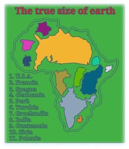

Step 13: Let's Create a 3D Printed Model That Showcases the Experience
PHASE 1: Save the image
Using the website TheTrueSize.com, place as many countries as you can within the African continent, orienting them as you like, but be careful not to overlap them in any way.
Take a screenshot of the screen and import the saved file into Inkscape.
PHASE 2: Trace the outlines
In Inkscape, using the PEN tool, trace the outline of Africa, then create an Offset (a parallel path to the original) by using the command PATH / LINKED OFFSET. With the NODE tool, you can drag the outline to create a new contour.
Using the PEN tool, trace the outlines of all the states that were placed. This time, only one outline per state is needed.
It is recommended to save an SVG file for each profile/state.
Important: during these operations, it is essential not to resize the background map.
STEP 3: Creating the 3D models
  1. Import the individual SVG files into Tinkercad.
  2. Build the game by adjusting the heights of the shapes and adding any custom text as needed.
  3. You can modify the height of each state profile and make any other adjustments to suit your design.
  4. Once all elements are assembled, resize ALL of them so that the largest model fits within the available printing area, while the smallest model remains proportional in size.
  5. After adjusting the sizes, export each 3D model as an STL file for 3D printing.
STEP 4: Simulate and Print
  1. Import the STL files into the Ultimaker Cura software without resizing them.
  2. Arrange the models optimally, creating different print sessions based on the colors you wish to use.
  3. Perform the prints and then assemble your geographical puzzle.
STEP 5: Some of the Activities to Do:
  1. Display the works and present the different solutions identified.
  2. Calculate the total square kilometers achieved.
  3. Exchange projects and try to reassemble them.
  4. Recognize the states based on their shapes.
  5. Use the pen tool to write the names of the states or their identification numbers.
