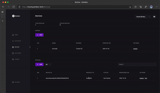

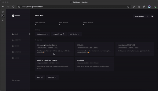

To get these, we need to create a project on the Grandeur Dashboard at https://cloud.grandeur.tech/. Here are the steps you can follow:
  1. Go to https://cloud.grandeur.tech/ and click on get access to sign up.
  2. Create a new project.
  3. Add a new model.
  4. Add a new device. Copy and save the device ID and token it returns.
  5. Add a new user. Copy and save the user email and password you used here.
  6. Pair the device we created in step 4 with the user we created in step 5.
  7. Go to settings, copy and save the API key from here.
  8. Generate new access key. Copy and save the access key and token it returns.
  9. Allow the origin http://localhost:8080 or whatever URL your webpage is served on. We'll see where to find this URL in the next step.
I have also attached all the steps in order in GIFs.
By doing this, you get access to use Grandeur as your communication broker.

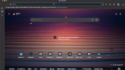

Step 5: Go Live
Compile and upload the ESP8266 program in your ESP8266 using Arduino IDE or CLI.
Start a local server to serve your webpage. If you have python 3, you can run this command in a terminal in your webpage's folder:
python3 -m http.server
If you have node.js, you can run this:
npx http-server
Open your browser and go to the URL that is displayed in your terminal after running these commands. This is the URL that you should add while allowing origin in the last step.
If everything works perfectly, your ESP8266 will connect to WiFi, and then to the internet, and start sending millis() value twice in a second. In your browser, you should see the wheel spinning and below it, the value of ESP8266's millis updating twice every second.
