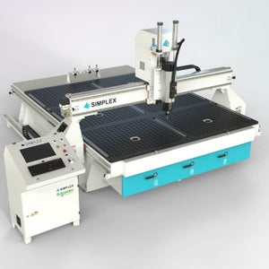

  1. CNC Router/Milling Machine: To cut your design with precision.

Step 3: Machining Your Coffee Table
3.1 Setting Up Your CNC Machine
  1. Material Preparation:
  2. Secure your 18mm MDF sheet on the CNC bed with clamps or a vacuum table.
  3. Set the machine’s origin point (zero) according to your design reference.
  4. Load the G-Code:
  5. Transfer the G-code from ArtCAM to your CNC router’s controller.
  6. Test Run:
  7. Run a test on a scrap piece of MDF to confirm proper settings and tool paths.
3.2 Cutting Process
  1. Execute the Cuts:
  2. Start with the outer profile, then proceed to the detailed engravings or inner cuts.
  3. Monitor the machine for any adjustments or issues.
  4. Quality Check:
  5. Once the machine has finished, inspect all cut parts.
  6. Trim any rough edges and perform any necessary sanding.
Tip: Always follow safety guidelines while operating CNC machines. Wear appropriate personal protective equipment (PPE) and ensure the work area is clear of obstructions.
