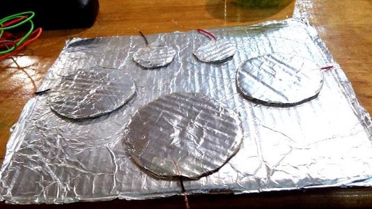

Glue all the foiled circles onto the foiled rectangle in an arrangement that suits you. You could try my arrangement.

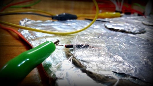

Cut the wires into short pieces with the conductor exposed at the edges so that the alligator clips from the makey-makey package can “bite on”. Use the cello tape to attach the exposed conductor of the wires onto each of the drum pads.

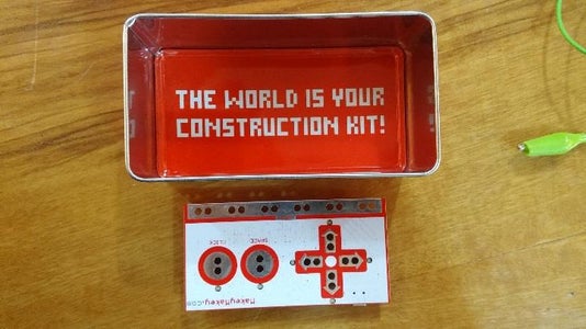

I know by now you have already ripped your makey-makey package open so no need to say it. We however need to get familiar with it before we proceed.
Here are some pictures of what to expect in the package. You can visit their website for more info. Here’s the link: www.makeymakey.com

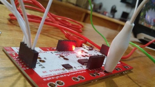

When you turn the makey-makey around, you will see some IC looking thingies and some black protruding input ports with letters written against them.
There are these white wires with aluminium conductors in the package – about 7 of them (I’m not sure of the number). Stick these white wires into the ports in any order.
Step 9: Making Electrical Connections: 2

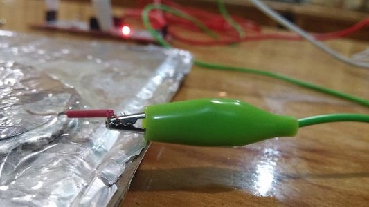

Take out the alligator clips and attach one end to the white wires. Now clip the other end of the alligator clips to each of the wires we earlier taped to the foiled circles, remember?

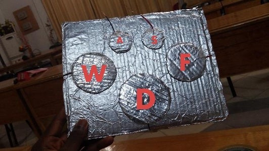

The clipping has to be done in a certain order. Remember that the input ports we connected the white wires to have letters written against them so the program we will be running on PC might play the wrong instruments if we get the order wrong.
Hence:
W = snare 1
D = kick
F = snare
S = hat 2
A = hat 1

Step 13: Bad Drum. Bad, Bad Drum!
If more than one drum pad plays the same sound, then my friend you have paid the price for your creativity. But like I said, your friendly neighbourhood coder is going to teach you a workaround.
Remove all the wires and clips on the affected drum pads and apply another layer of cello tape. The cello tape must cover the entire surface of a single drum pad and try not to let it touch another pad.
Glue a new layer of aluminium foil on top of the new cello tape layer.
Fix the wires and clips back like we did in the previous steps. I’ve repeated some images here to show what I mean. If you look close enough, you would notice the layers I talked about in this step.
