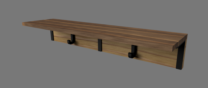

Step 1: Plan Out the Shelf
Sence I was making this from recycled materials and I knew the space that I was going to mount the shelf I was able to make a mockup in Fusion 360 before cutting any material.

Reassemble the shelf with the 1 1/2" screws and brackets and grab whatever number of hooks that you would like to use. I chose to have two on the face to hold my pants and jacket, and one on the side to allow me to hold a heavy bag. Pre-drill and screw in the hooks into whatever place you wish.
