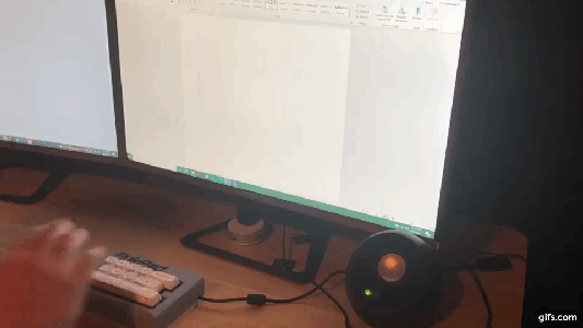

A month or two ago, I was browsing Instagram and saw the post in the screenshot. It was what appeared to be a photoshopped keyboard that only contained the letters necessary to tell someone off. I thought it was funny and decided to build a real, functional version. This is the result!
It does, indeed, work. Plug it into a computer's USB port and it will show up like any other keyboard. Other than the important letters, there is also a space key, a backspace key, and an enter key. The enter is actually a "+" meant for the numpad, which I used because I design the case with the wrong measurement for a normal enter key (2u instead of 2.25u).

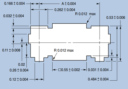

I designed the enclosure in Autodesk Fusion 360. The top plate, where the key switches mount, is integrated into the enclosure. The biggest challenge here was the shape of each key switch hole and its spacing, along with the holes for the stabilizers. You can find more information about those at the following links:
https://null-src.com/posts/keyboard-design-cheatsheet/post.php
https://geekhack.org/index.php?topic=64287.0
https://switchandclick.com/stabilizer-guide/
https://user-images.githubusercontent.com/13644/66226900-eb1e3e00-e6a9-11e9-80fa-fce8996ba06b.png
In my case, the switch holes are just square and that worked fine.

And you're done! Now you've got a keyboard that only has the letters that you really need.
