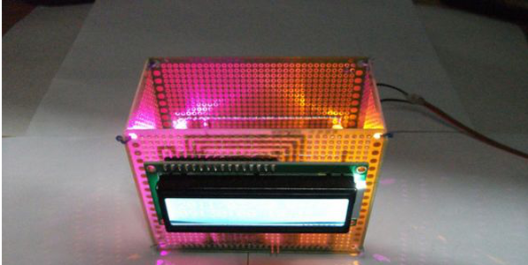

when the time of the integral clock,besides that the sound buzzer will alarm,on the right and left inside of the pen holder, the purple and yellow LED will flicker to remind the time coming.The light from the hole looks very soft and beautiful. In order to avoid influencing the sleep, the buzzer will sound between 7:00——24:00,and other time only uses the light to remind time.

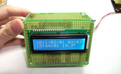

Step 1: Display Main Information
The main information of display as the picture shows “2011/09/12 W→<6> 20:05;09 27.4°” The “ W “ is the abbreviation of week and W→<6> means Saturday.

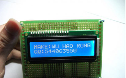

Step 2: Display Personal Information
If only display this kind of information, maybe you will feel boring. So I use the principle of switch display to show more information. The above picture is the one: to display the name of the maker and QQ number in order to show the permission.

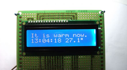

Step 3: Display Temperature
It will show the real temperature and some remind words with English, such as hot,cold,and warm,freeze to dead~~~

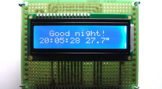

Step 4: Display Time Remind Words
To display the remind information of time,such as Good Morning。。。Good noon。。。Good afternoon and Good night!

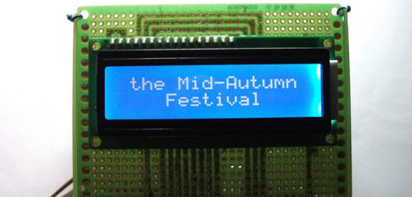

Step 5: Display Chinese Tranditional Festival
And then will show some Chinese feature and display the Chinese traditional festival,such as the Spring Festival, Mid-autumn Festival, Chinese Valentine’s Day and so on. It can only display with English.We can think it as a combination of Chinese and western feature.

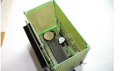

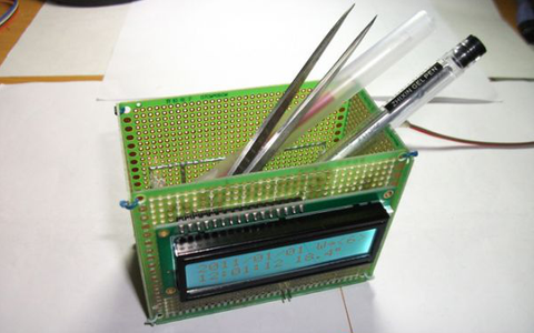

Step 6: Interior Structure
Use Prototype Paper PCB to surround into a rectangle shape and put the device inside.So we have a lot of space to put pens and the shape of pen holder also comes out.
Step 7: Exterior Structure

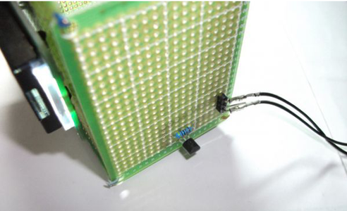

The DS18B20 temperature chip should be welded on the outside of that “ pen holder” and the device inside will heat more or less.
Step 8: Show the Picture When LED Flicker
