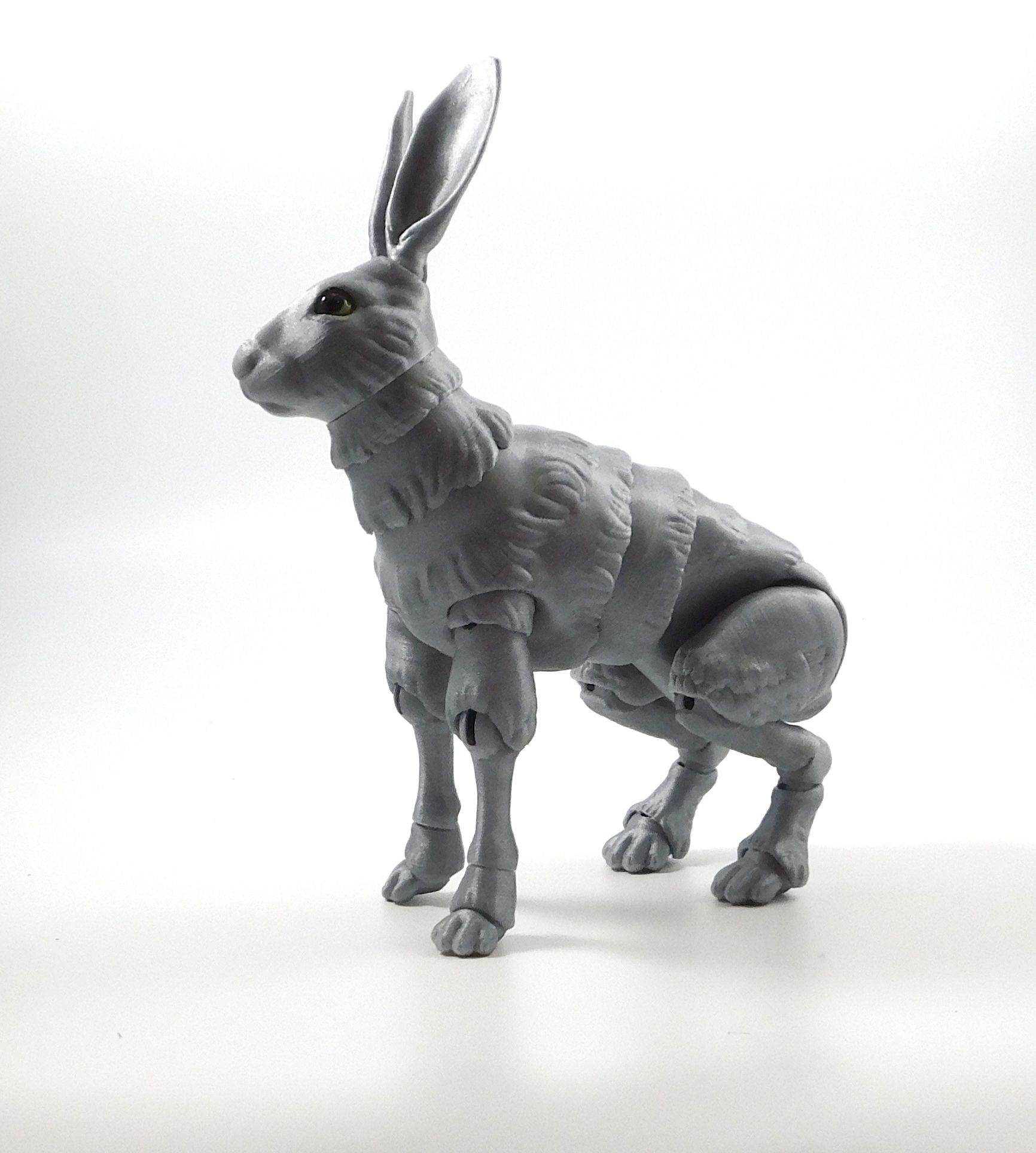

My personal fascination with hares started when I borrowed a copy of Kit William's Masquerade from my local library. It was the early 80's and I was 7 or 8. I marveled at the art and the beautiful golden hare crafted by Williams, both made a huge impression on me and still influence my work today. Recently, I decided wanted my own hare but for it to be more than a picture or a static sculpture, something that I could interact with and that would incorporate an array of my design skills. Of course my love of the clockwork driven automatons from past centuries can be seen in the styling. Maybe also this hare would feel at home in places like Wonderland or Oz?
The Fabled Hare is a ball jointed doll (also known as a BJD) and strung together with elastic cord. It has a face plate which is attached by magnets and removable. All feedback (especially from ball jointed doll makers and owners) is most welcome. I don't not own any BJDs and am not an experienced doll designer, so this was worked out using observation and what common sense I have. I'm sure there are better ways to do things.
This doll isn't jeweled, made of gold or magical but I hope it is something people will enjoy.

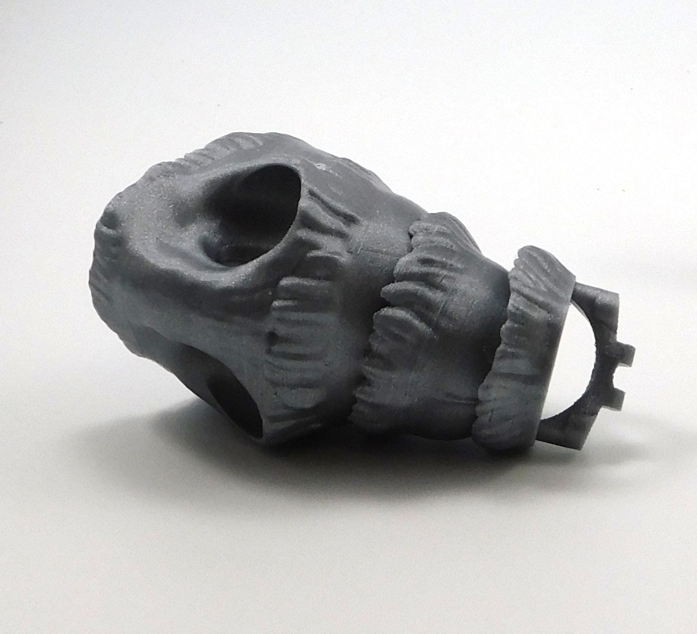

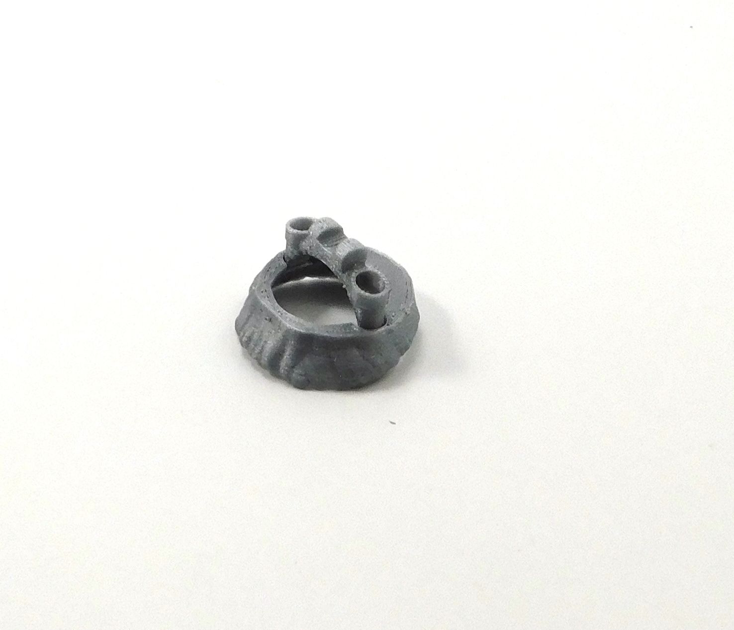

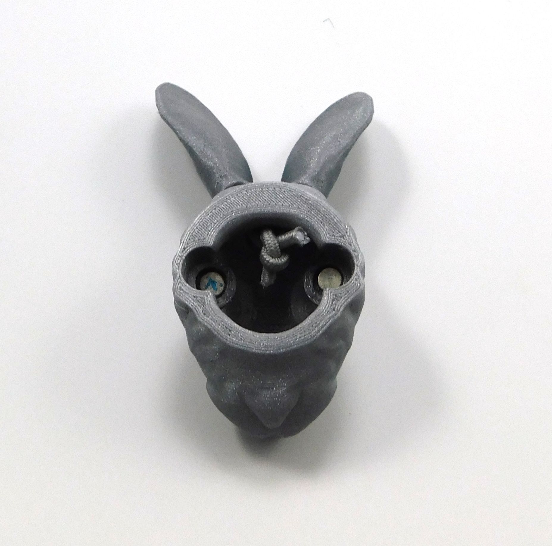

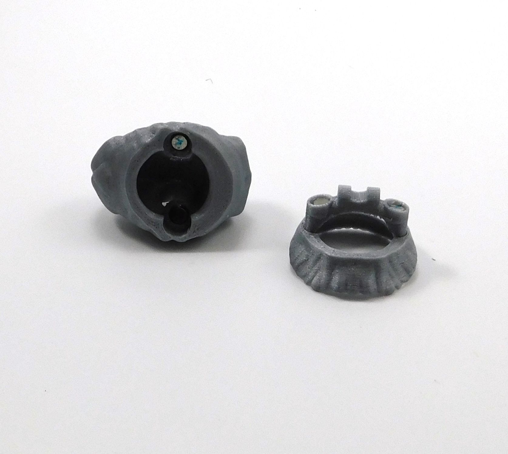

Step 3: Fitting the Magnets and Hook
To complete this step you will need:
- 4 x 6mm x 2mm (or smaller) magnets
- Glue
- magnet_hook.stl (printed)
- neck_upper.stl (printed)
- head.stl (printed)
Do the following
- Glue the magnet hook into the slots in the neck_upper part. Ensure it dries.
- Pair off the magnets
- Take the first pair of magnets and glue one magnet into a holder on the magnet hook and glue it's mate (ensuring the that pole direction is correct) into the corresponding slot in the hare head.
Make sure this is orientated so the upper_neck.stl is facing the right way as shown in the first picture. - Repeat for second pair
- Once dry, you should be able to secure your hare head to the upper neck using the magnets. I forgot to take a picture at this point and therefore am including one a little further along in the process. Sorry!

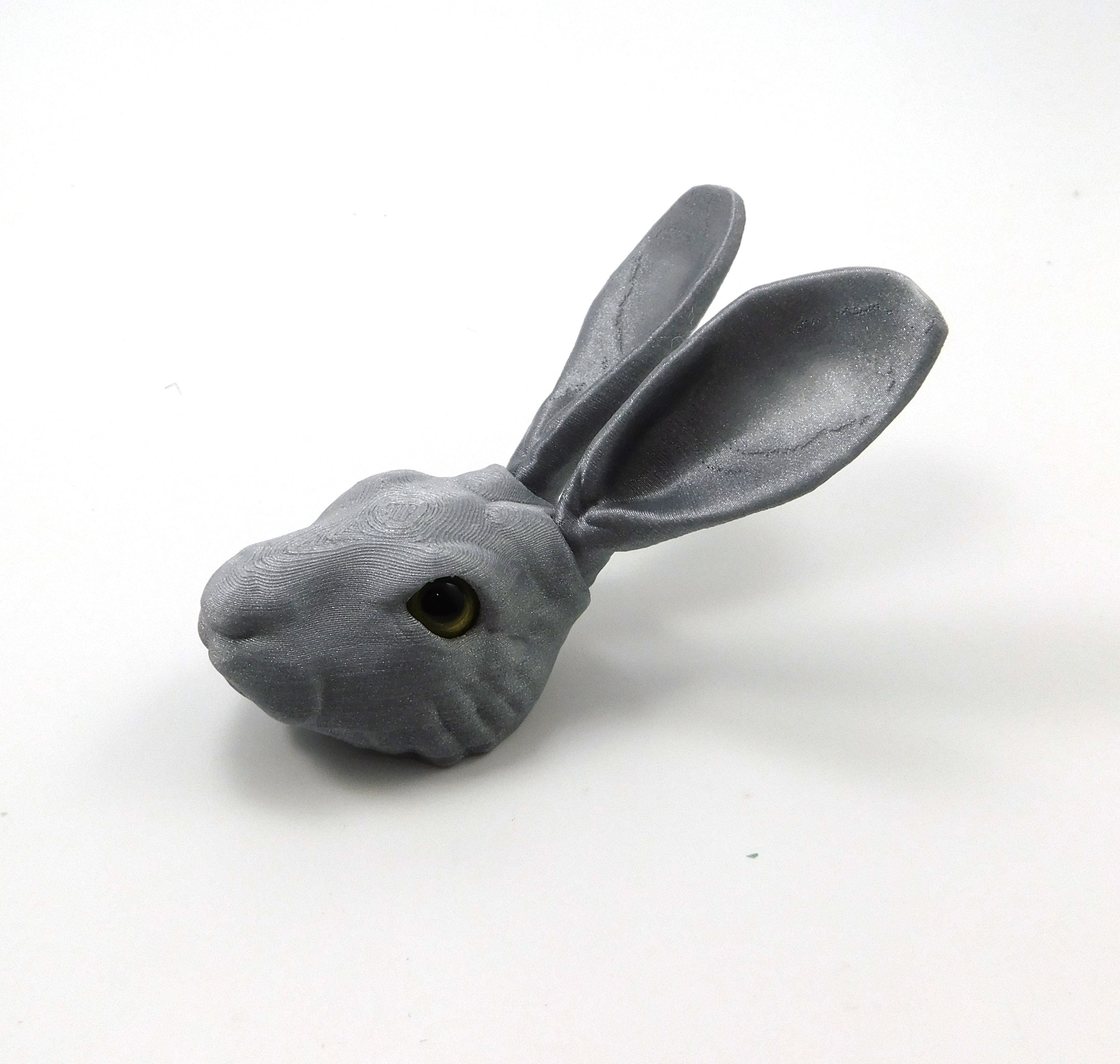

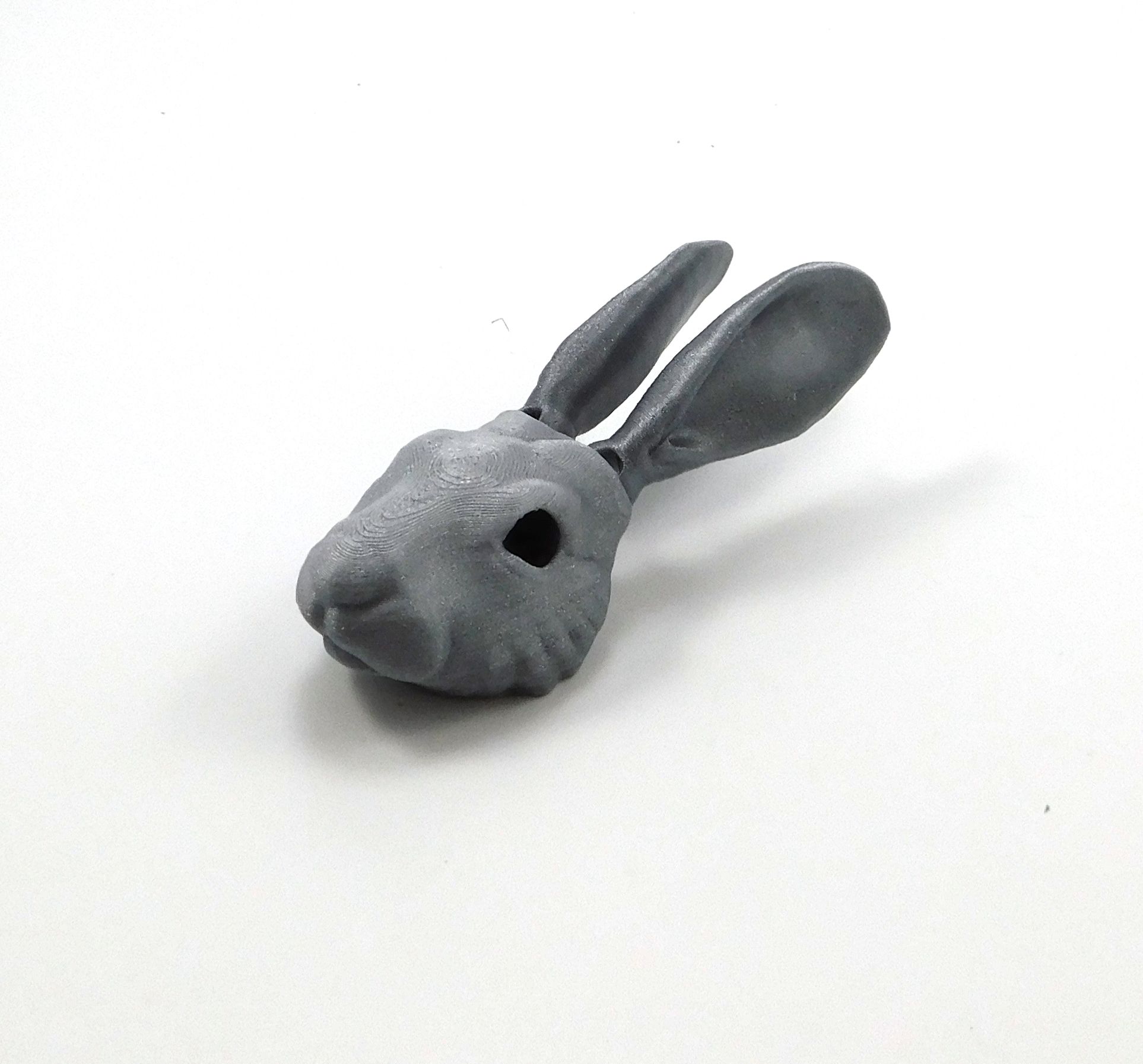

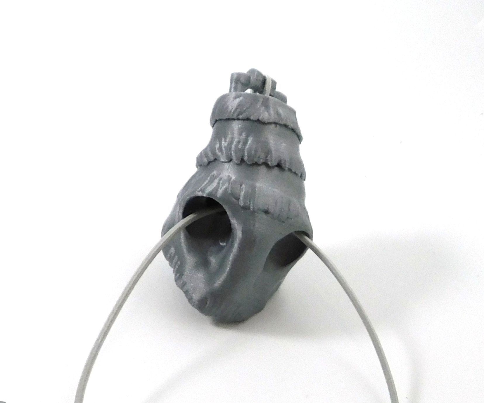

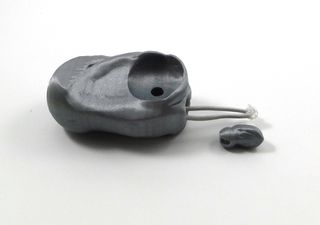

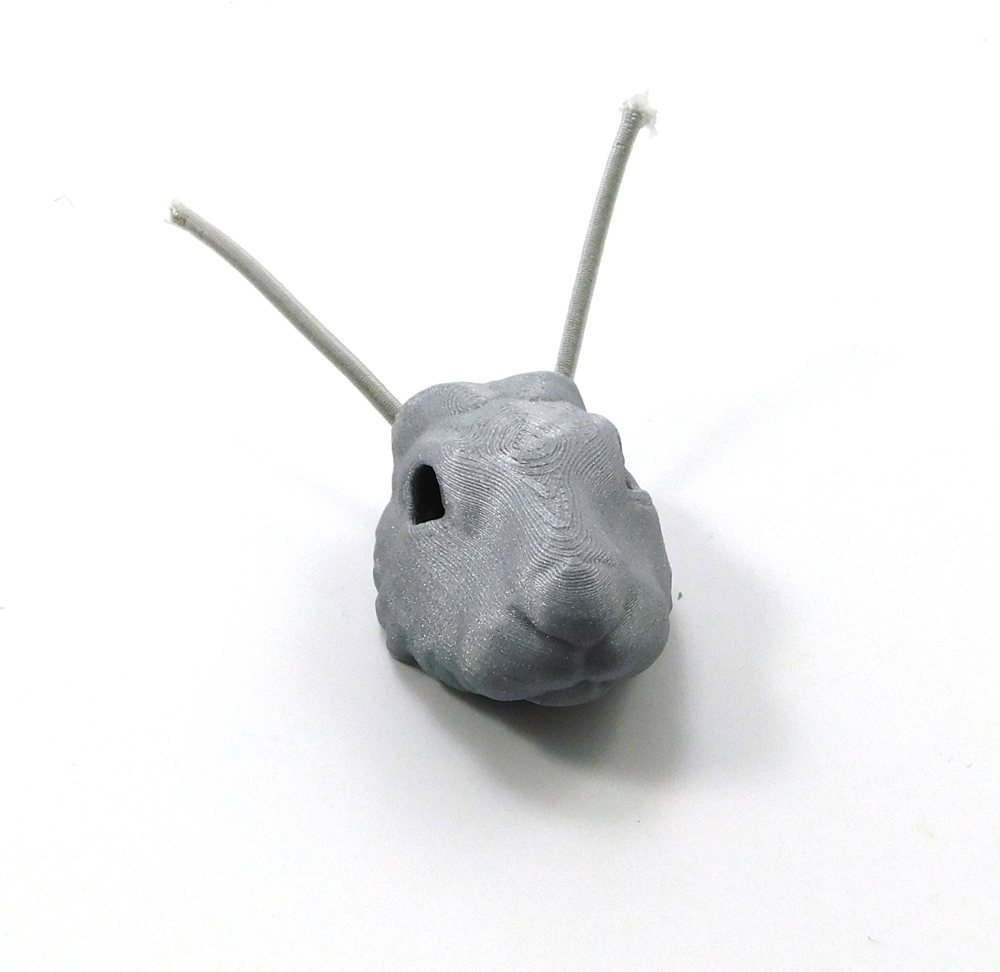

Step 4: Stringing the Ears
Note: If you have very large hands, you may want to fit the eyes first!
You will need:
- Elasticated cord(6 1/2 inches/16.5 cm worked well for me)
- ear_right.stl(printed)
- ear_left.stl(printed)
- hare head
- small needle nose pliers or some hemostats (this is a very close work and these will help pulling cord through)
- Thread cord through one ear hole, through the head and through the other ear hole
- Thread the ears as shown and tuck the cord ends through the ears so they can be tied.
- When pulling the cord to tense, take into account it should not be too tight. We want the ears to hold up straight but also the lay back and not "kick" up.
- Knot the cord securely and trim the ends closely. There isn't much room inside the head for excess cord.

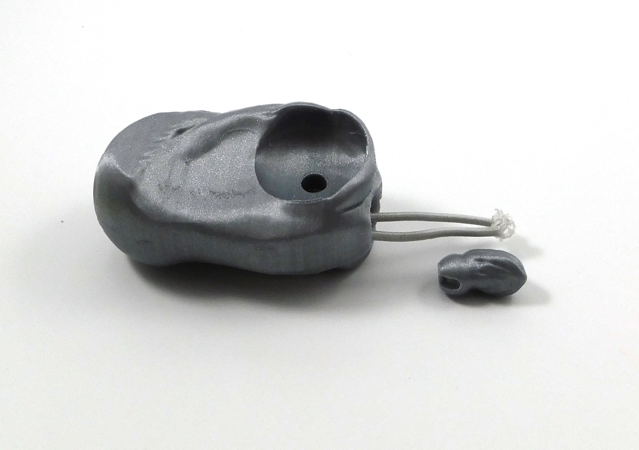

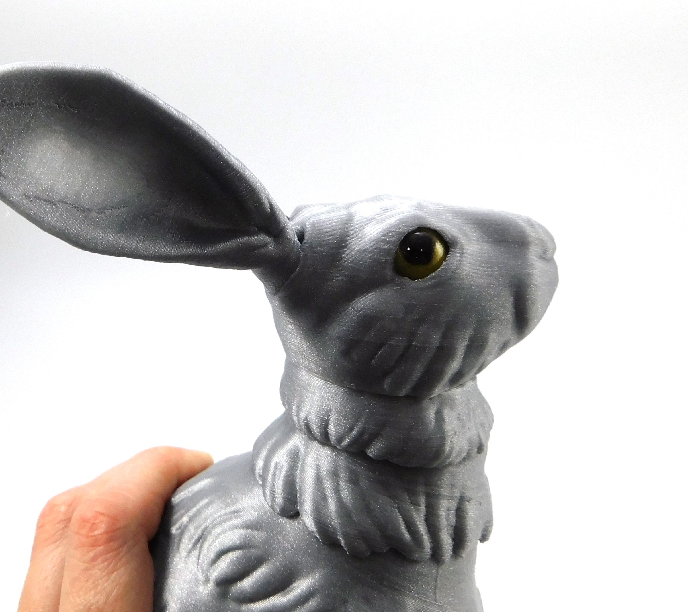

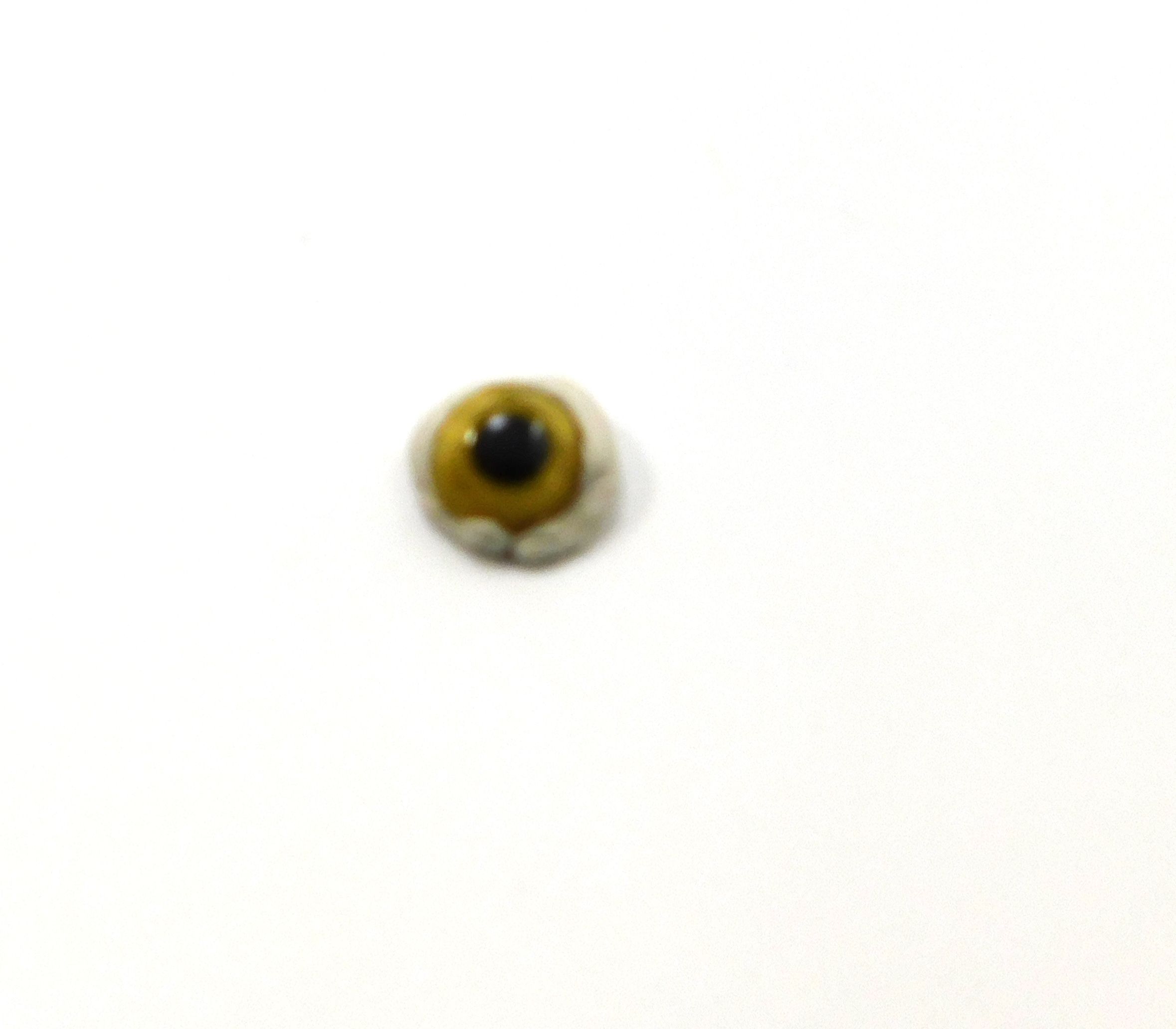

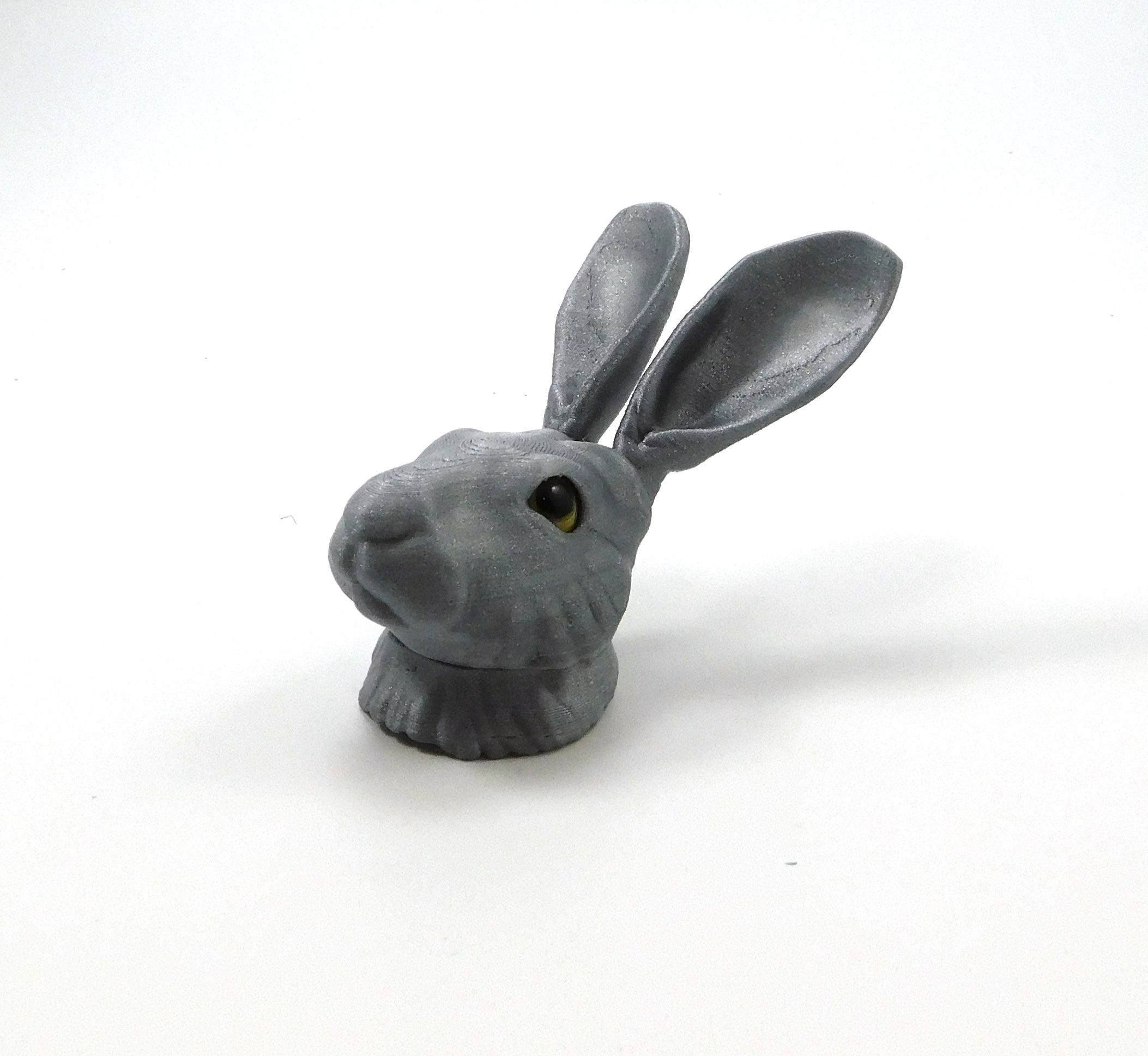

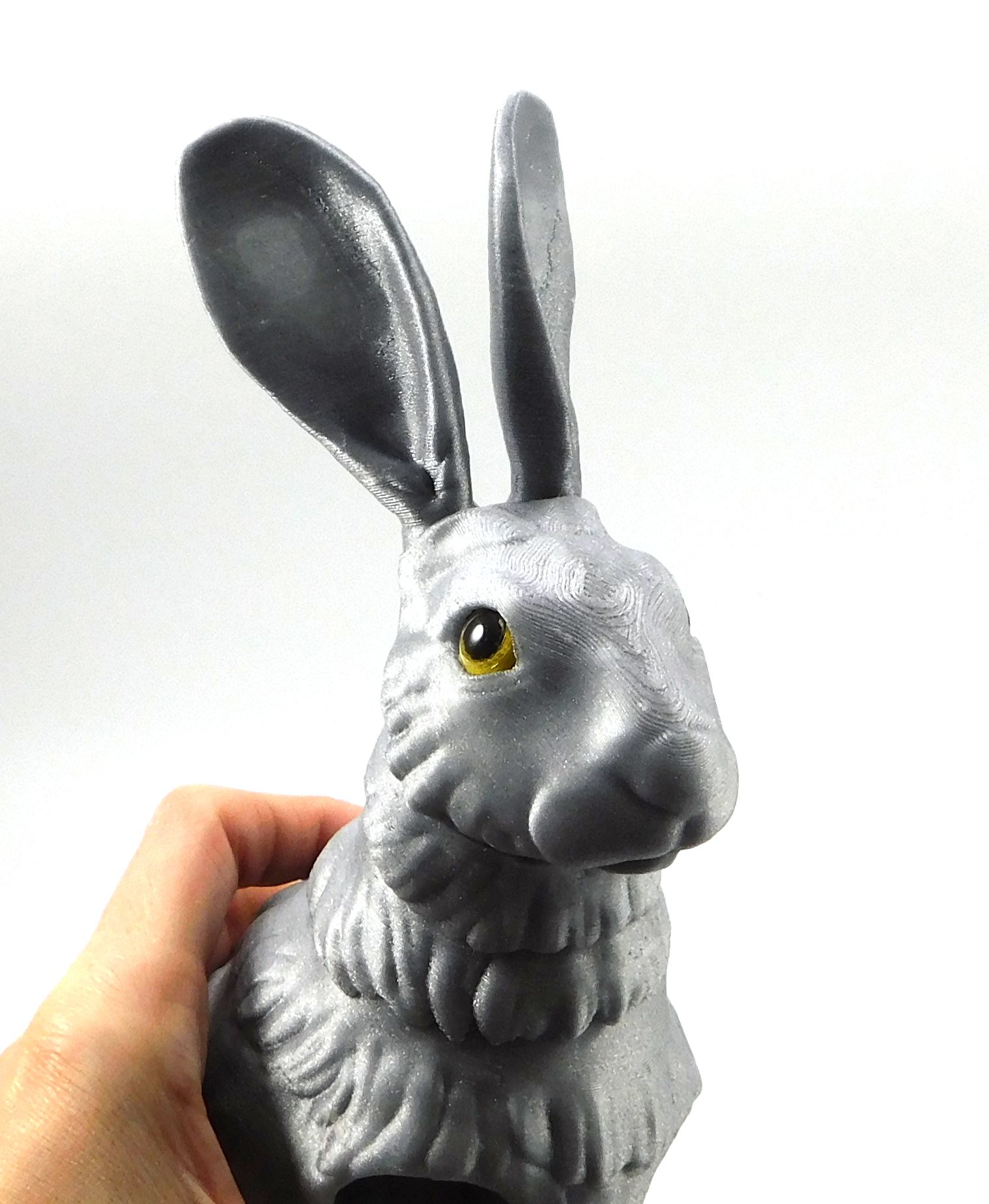

Step 5: Fitting the Eyes
You will need:
- 2 x eye.stl printed
- Assembled hare head
- Glue, putty or silicone earplugs
Optional:
- UV clear doming resin
- Black nail polish
The eyes can be printed in any color but obviously one that contrasts with the rest of the model and has a translucent quality is the most striking.
You can of course use pre-made eyes but they must be no more than 12mm in diameter and flat-backed otherwise they won't fit. Another consideration if purchasing eyes, is that normal doll eyes won't do as they show too much white. A hare only shows the iris and pupil. I've no idea how difficult it would be to get these but you could probably try sites which supply taxidermists.
Update: Etsy appears to have loads of sellers which can provide a wide range of suitable eyes at reasonable prices.
I find it more fun to make my own. A bit of black nail polish works well for a pupil and I always use a clear UV doming resin (most jewelry resin is suitable) to create a "lens". It's quite effective.
If you don't fancy buying eyes or painting them, the eye is sculpted with a recess anyway, so a shadow will be cast where the pupil will be. You won't have "zombie" eyes.
To fit the eyes, there are recesses inside the head where they will sit. You can either glue them in or use putty or silicone earplugs which will hold them in place. The advantage with the putty/silicone option is that it makes the eyes removable should you wish to change the color or or direction the hare is looking in. Gluing is going to be rather fiddly and hard.
- Wrap a small piece of putty around your eye
- Put the puttied eye on the end of your finger and work it in place inside the head. Once it is seated in the recess, you can move the eye to position it. I find having the pupil centered but slightly upwards works well as a neutral eye position for a hare
- Now your hare is just a floating head instead of an eyeless monster - not sure which is worse:-)

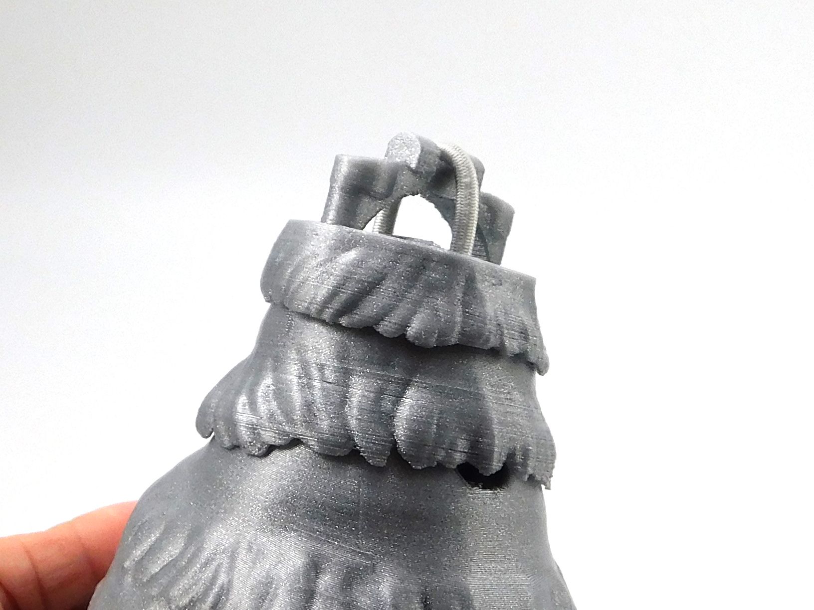

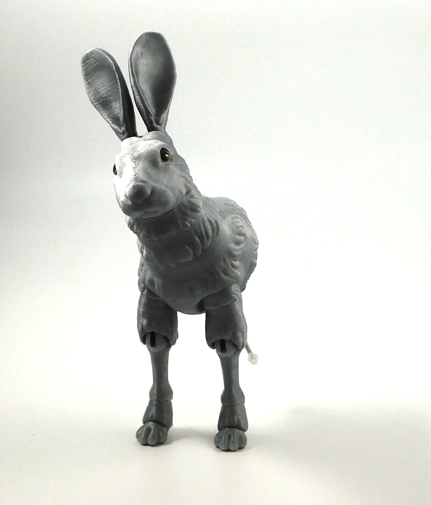

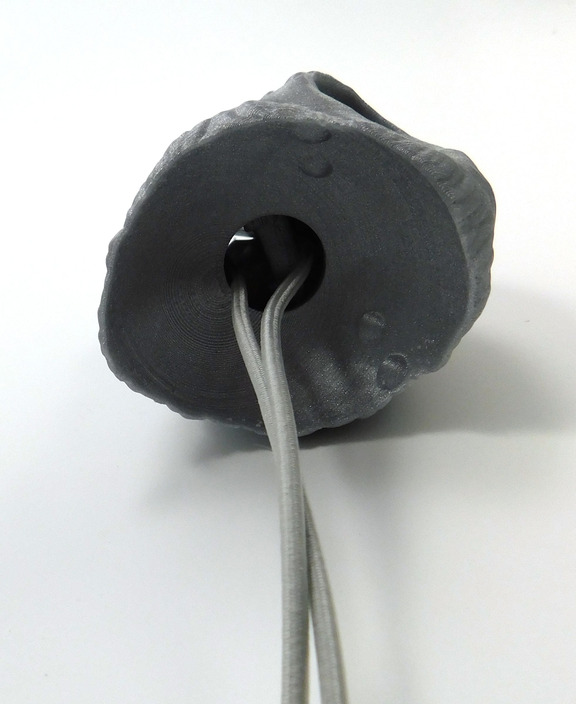

Step 6: Stringing the Neck and Chest
You will need:
- Assembled Upper Neck
- Assembled Hare head
- neck_lower.stl (printed)
- chest.stl (printed
- Elasticated cord (I used 1 and 1/2 ft/45.5 cm which is plenty)
- Ensure the model pieces are together as shown (remember the front of neck_upper.stl has the ridge)
- Take the cord and loop it over the magnet hook
- Hook the other end under the brace inside the chest
- Tie a secure knot ensuring the tension is tight enough to hold the neck pieces together and have some controlled movement. At this point you will need to add the head as the cord has to be strung enough to hold the extra weight.
- Test that the hare can hold their head up and down and twist and keep the position. Once you are happy, trim the ends and tuck any excess into the chest cavity

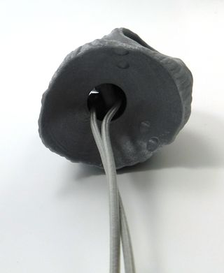

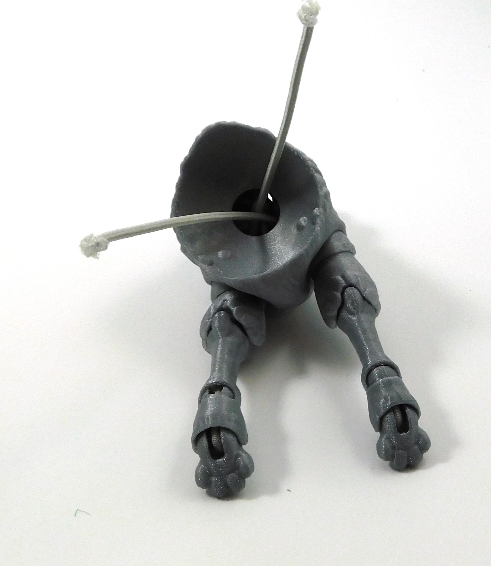

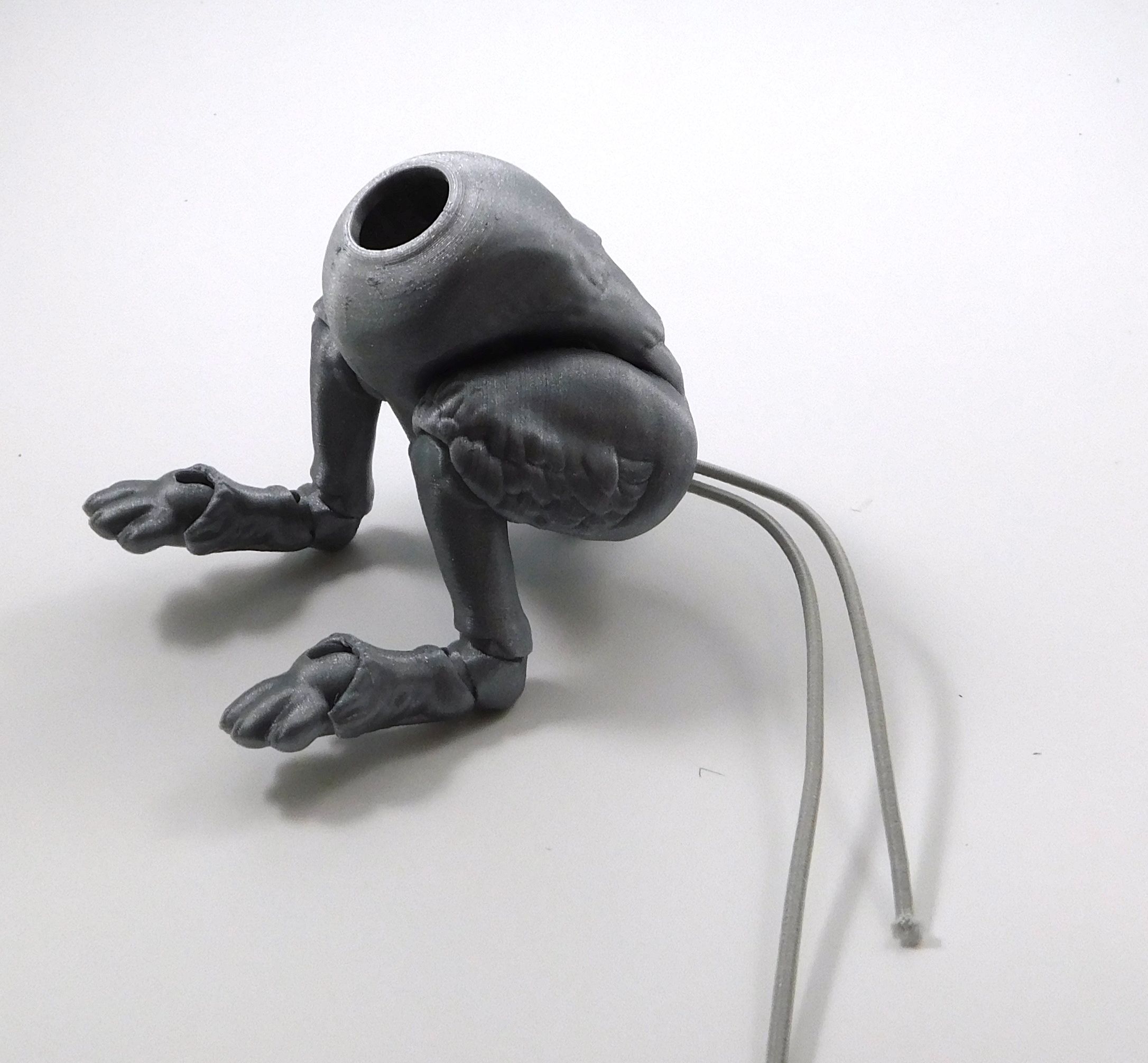

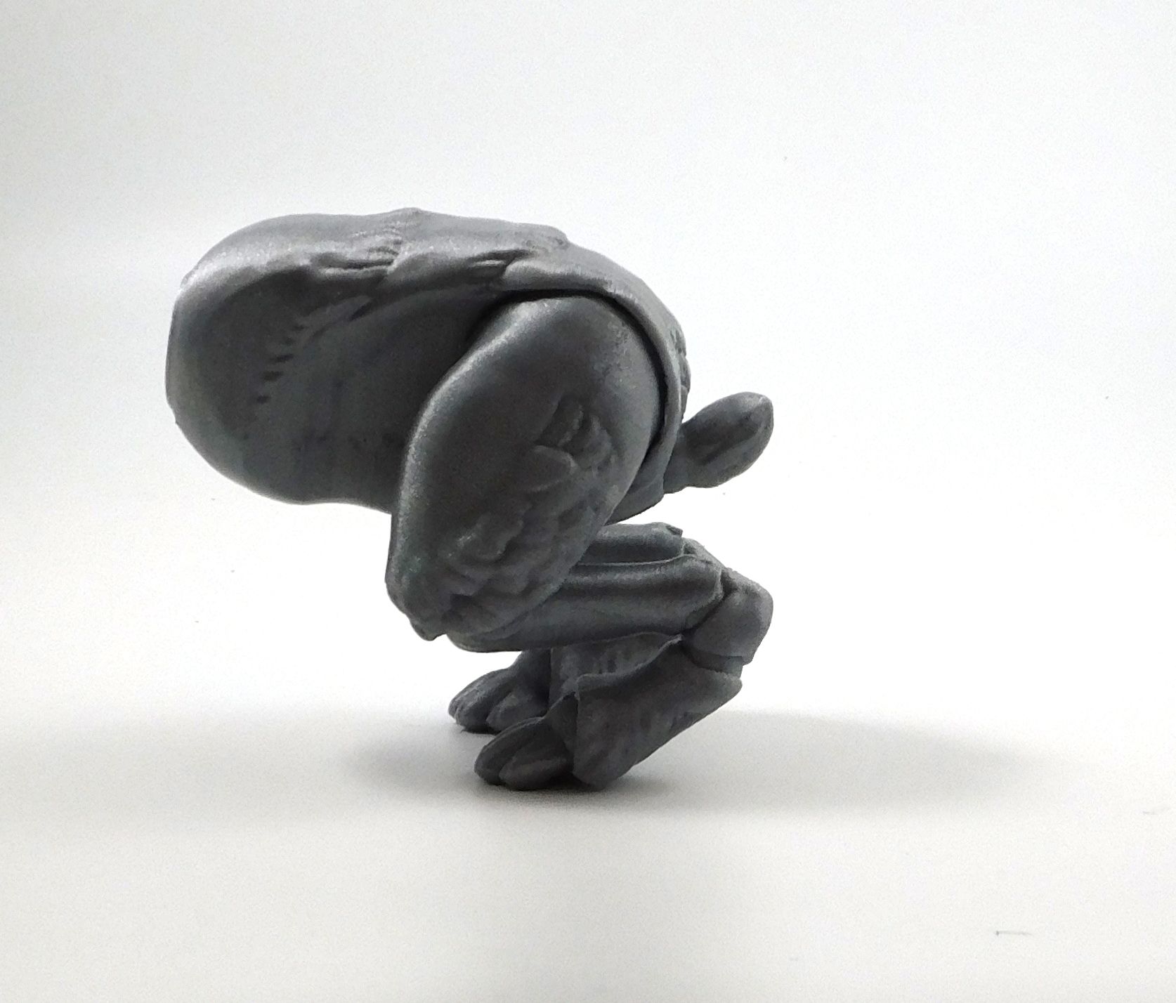

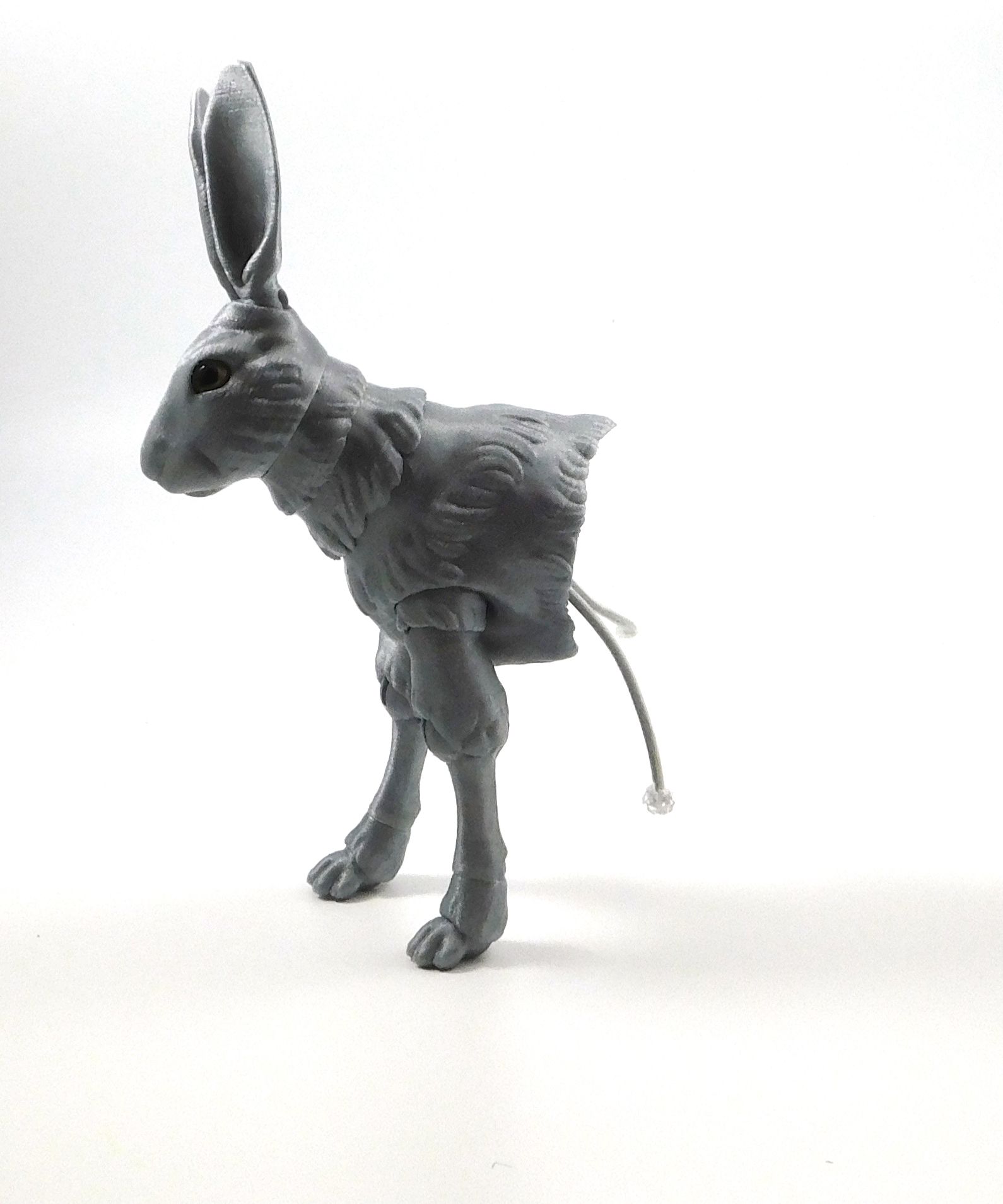

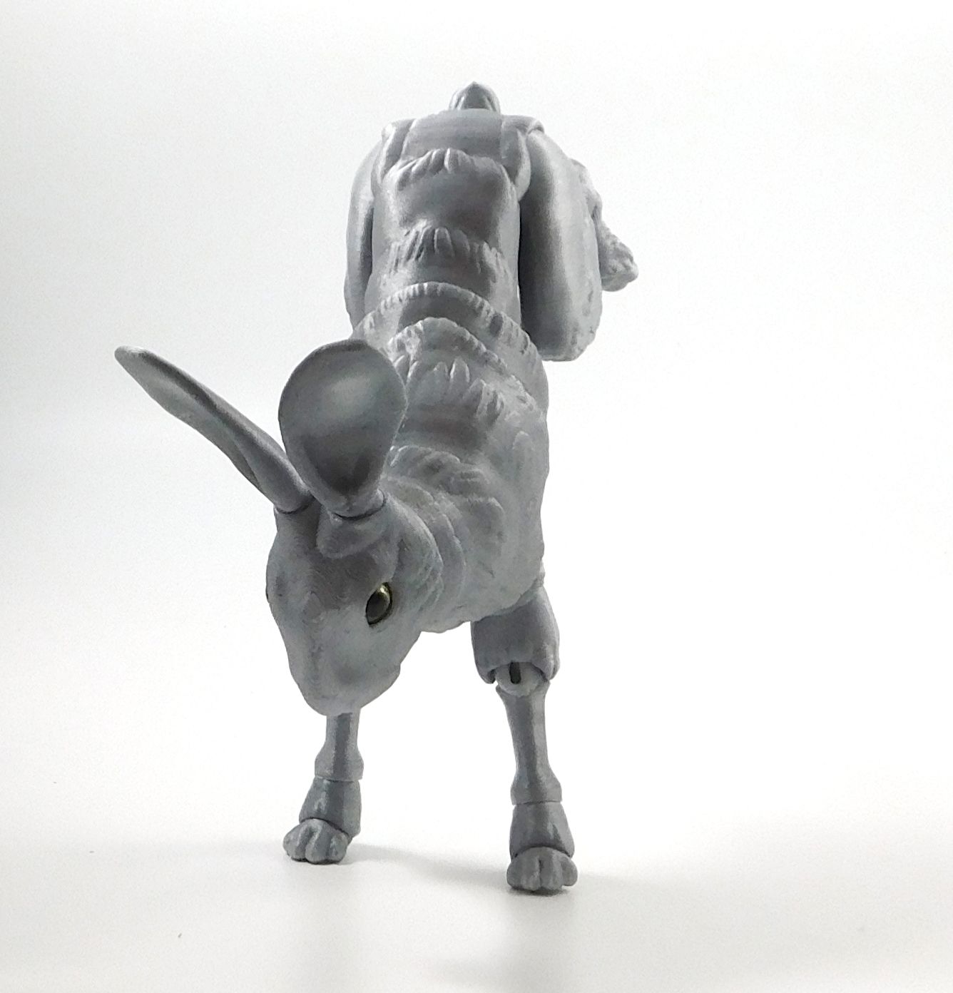

Step 7: Stringing the Front Legs
You will need:
- Assembled neck and chest
- shoulder_left.stl (printed)
- shoulder_right.stl (printed)
- leg_front_upper_left.stl or leg_front_upper_left_v2.stl (printed)
- leg_front_upper_right.stl or leg_front_upper_right_v3.stl(printed)
- leg_front_lower_left.stl or leg_front_lower_left_v2.stl (printed)
- leg_front_lower_right.stl or leg_front_lower_right_v2.st l(printed)
- ankle_front_left.stl or ankle_front_left_v2.stl (printed)
- ankle_front_right.stl or ankle_front_right_v2.stl (printed)
- foot_front_left.stl or foot_front_left_v2.stl (printed)
- foot_front_right.stl or foot_front_righ_v2t.stl (printed)
- Elasticated cord (28 in/70 cm)
Special note: I have introduced a locking mechanism to the front legs and feet. This should make the hare far more stable to pose if you are not used to playing around with ball-jointed dolls and their various idiosyncrasies. Not sure if this a solution or a bodge yet :-).
The locks work as follows:
The foot and ankle. The foot has a cut into it which will clip onto a small wedge inside the ankle. This will hold the foot in a secure position. If you decide you want the foot to bend, you can just gently pull the foot off the wedge by moving it slightly forward and down.
The upper and lower front legs: The lower leg had three "pegs" which will fit into a recess on the back of the inside of the upper leg. This will hold the hare's front leg locked at three points int he joints rotation. To move the lower leg, just pull it forward slightly and rotate to the the next peg and it should click into place.
The advantage with this is that the front legs can be strung more tightly and not kick unless the lower leg is pulled out of its lock.
Both versions work anyway it just depends on what you want to do.
All feedback is welcome
The new files with the lock are those suffixed with v2.

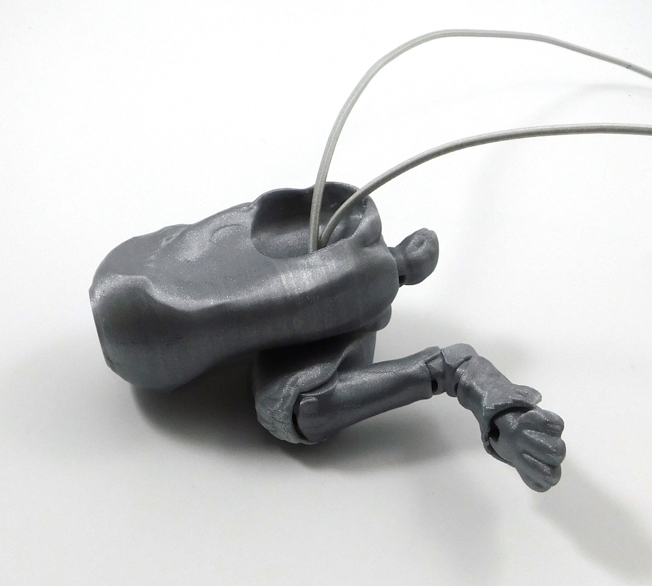

Assemble the legs pieces into the appropriate left/right groups so you don't get mixed up, some of the left/right joints look identical but they aren't and stringing your hare incorrectly will cause issues with posing
- Take your piece of cord and run it through one arm hole and out of the other
- Then string one leg (making sure you don't pull cord through from the other side). String in this order:
shoulder -> upper_arm -> lower_arm ->ankle -> foot
then take the cord back up
foot -> ankle -> lower_arm -> upper_arm -> shoulder
- Thread the cord out of the hole in the back of the chest piece
- Repeat for the other side. You should now have the two pieces of cord sticking out of the hole at the back of the chest
- Now here comes the fun bit: tensing the cord. Unfortunately I can't draw you a diagram but you want your hare to be able to bend its legs and not "kick". Kicking is a BJD term for joints moving to the path of least resistance by themselves because they are strung too tight and/or the joint design leaves something to be desired(I'm sure this is the case here to some degree). However, you also want it tense enough so when the legs are bent, the ankle and foot don't flop.
However, if you use the new v2 files, which have built in locks this problem goes away.
Your "half-a-hare" should balance easily by themselves but this will require they are strung correctly and that the maker has a bit of practice playing with the stringing and moving the joints. Also, if you are using the v2 front legs, you can lock into the "first" peg for secure balance.
In this instance, it is very easy to untie the knot and try again until you feel happy. Once you are happy, you can trim the ends.

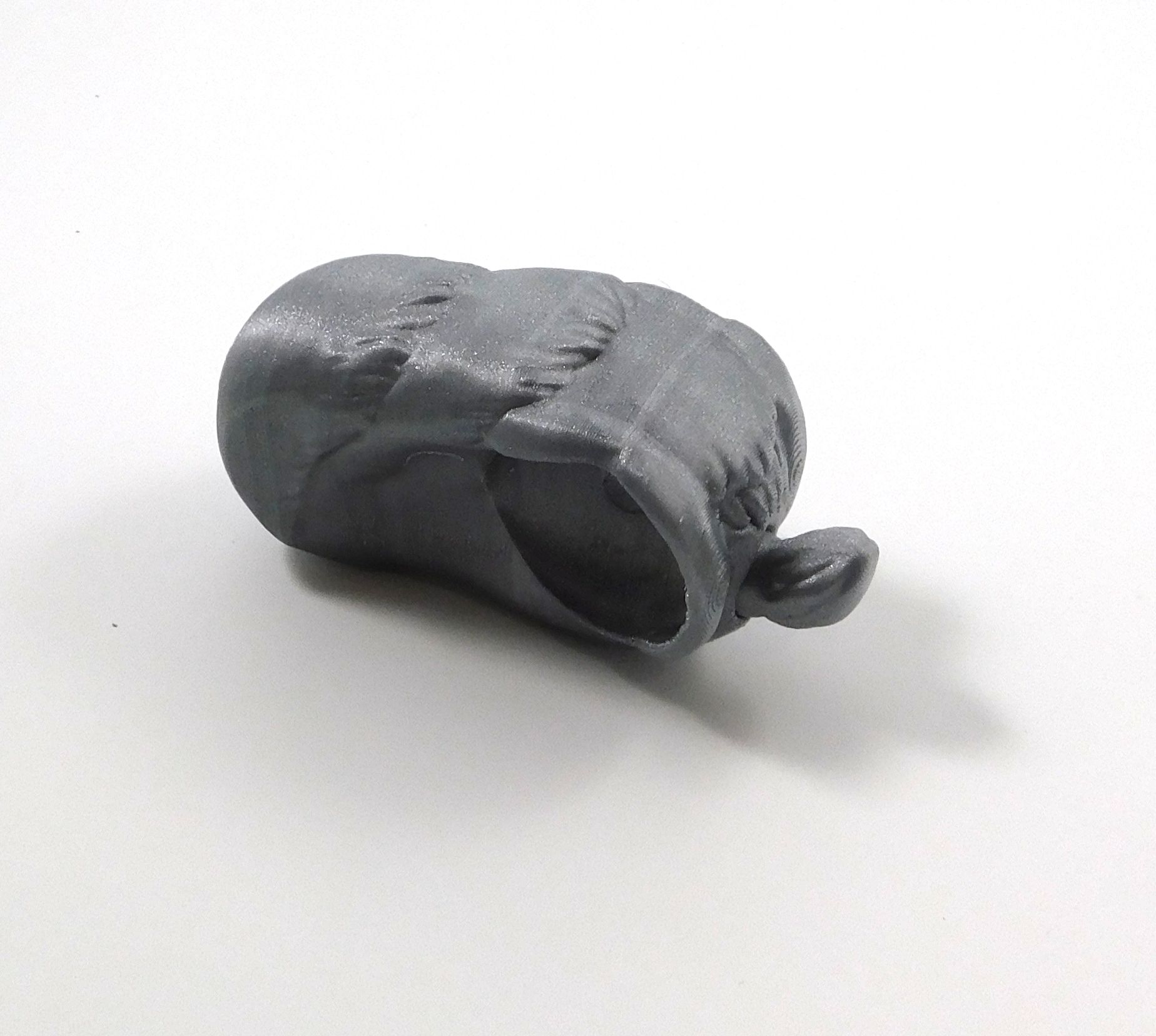

Step 8: Stringing the Tail
Unfortunately, there isn't much space to work with here but it is possible.
You will need:
- lower_body.stl (printed)
- tail.stl (printed)
- cord(4 in/ 10cm)
- pliers/hemostats/tweezers
- There is a brace in the tail hole Thread the cord under the brace and push and twist until you see the end of the thread pop up over it. Use some tweezers/pliers/hemostats to grab this and pull it through.
- Loop the tail onto the cord and knot it tight
- Cut the ends and pull the cord so the knot and cut ends are not in the way of the tail. The tail should be able to move. Although it's mostly used for balance for when the hare sits.

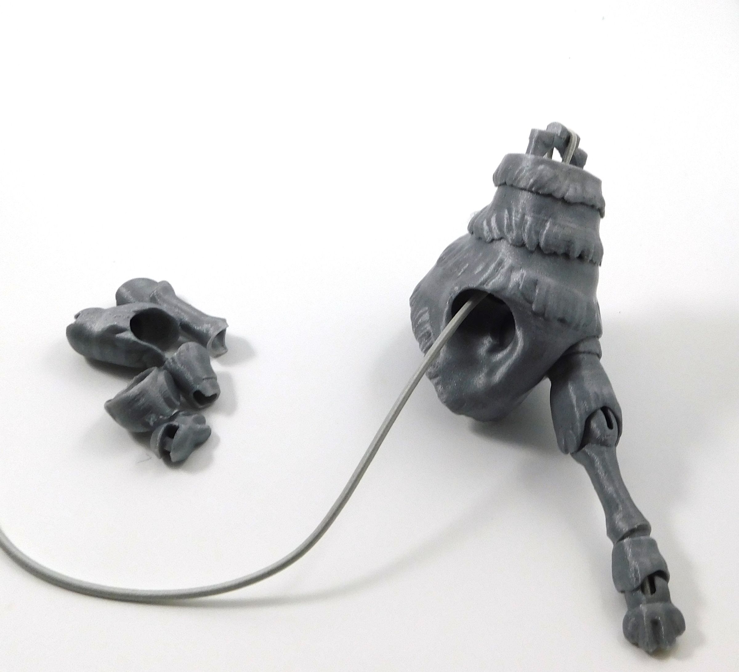

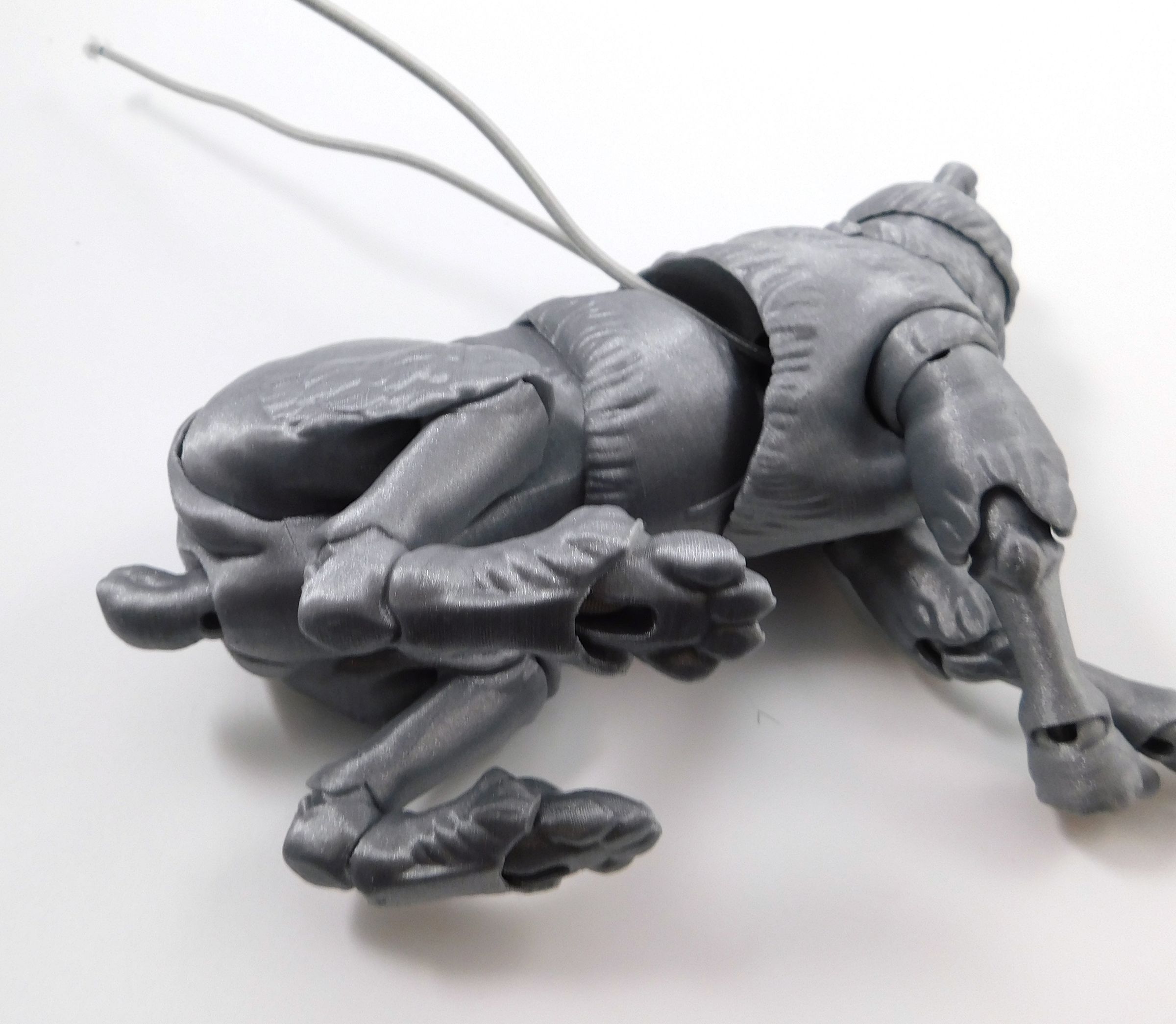

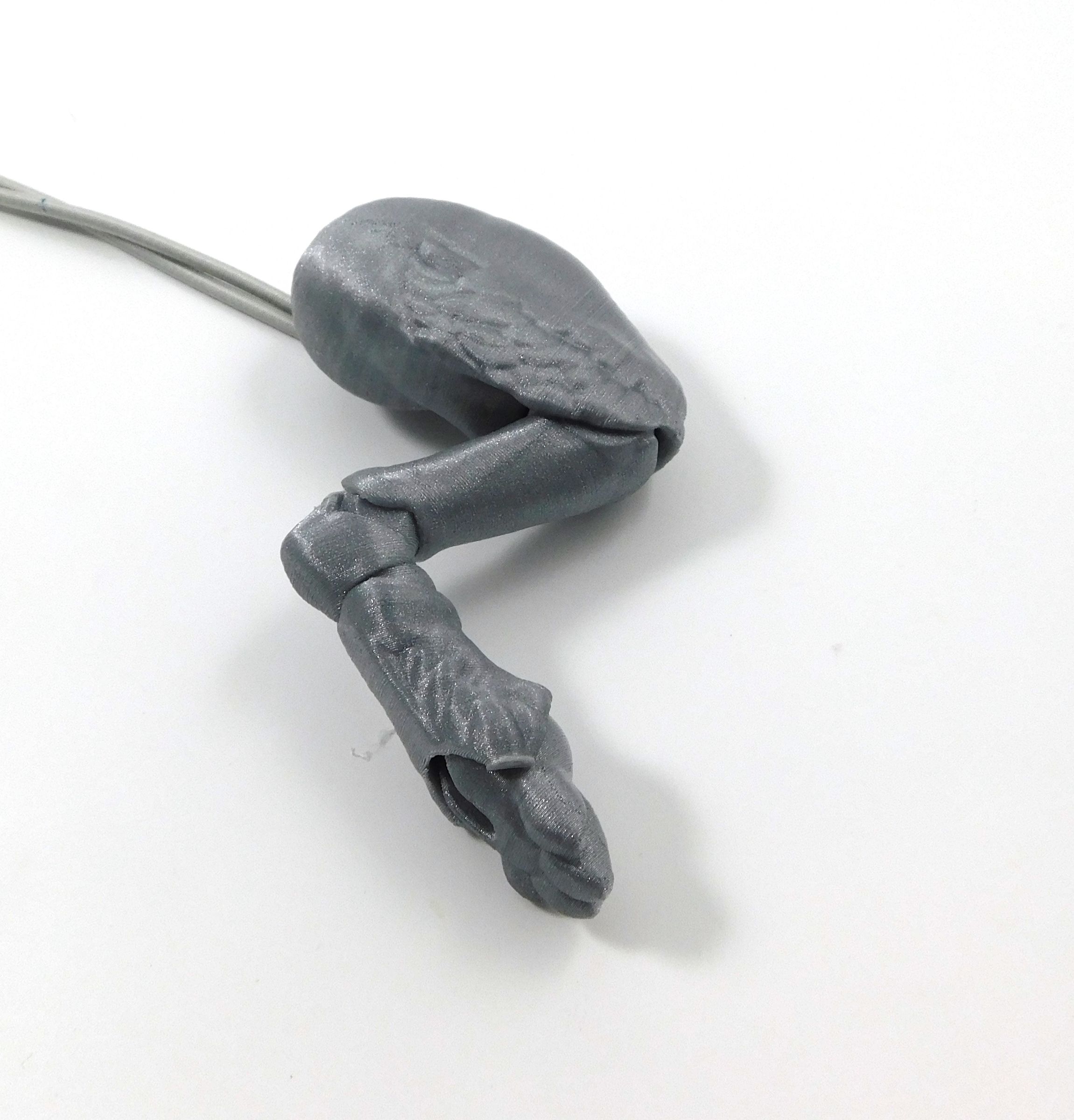

Step 9: Stringing the Back Legs
You will need:
- Assembled lower body
- thigh_left.stl (printed)
- thigh_right.stl (printed)
- leg_back_upper_left.stl (printed)
- leg_back_upper_right.stl (printed)
- ankle_back_left.stl (printed)

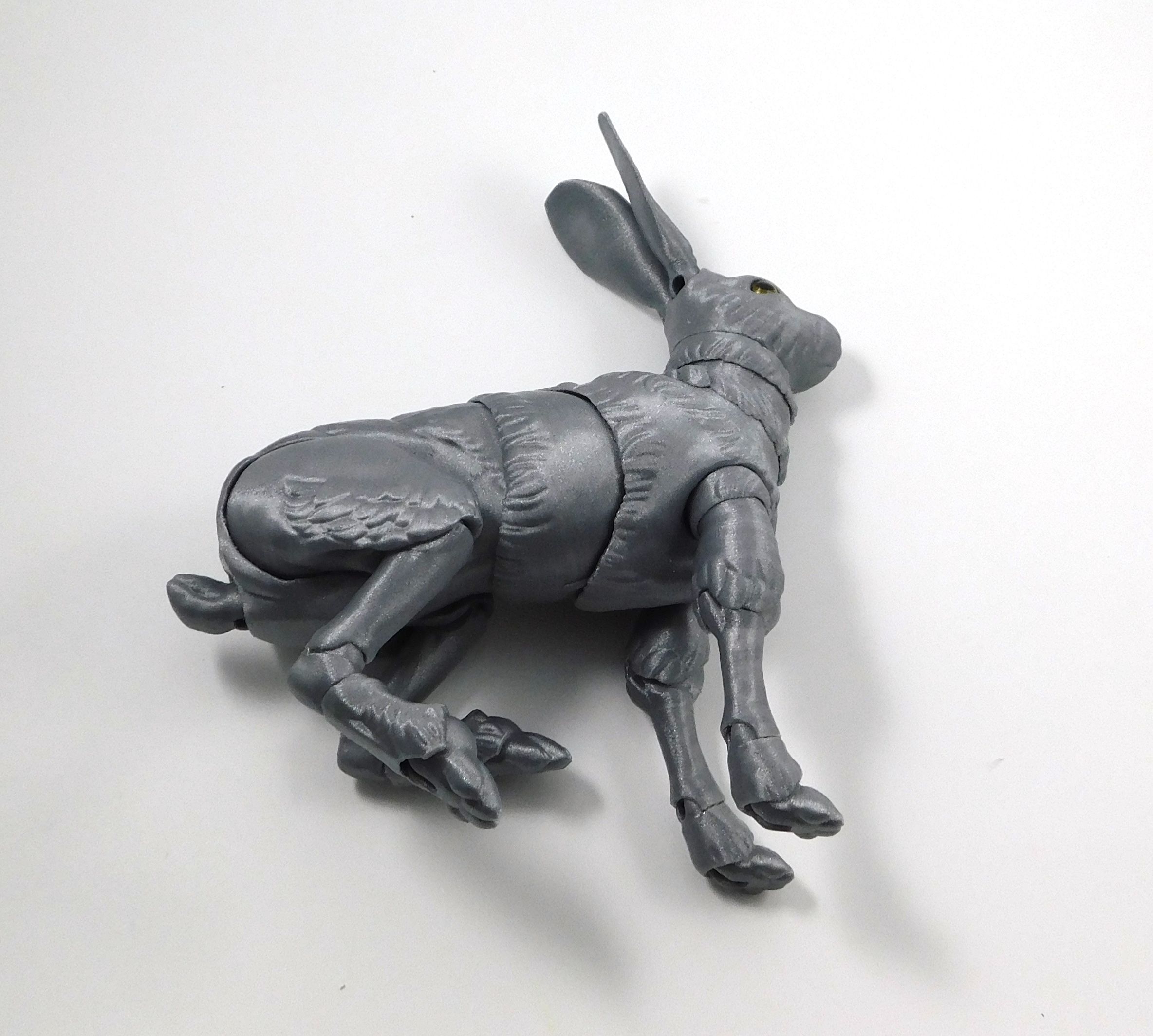

The hind quarters of the hare are not easy to turn into working ball joints for a doll that can hold poses.
I think this is why you never see BJD hares or rabbits that aren't "anthro"(or very rarely). Hares, in particular are all bendy legs and spine but still beautiful enough to make the effort for, so I did. I've achieved what I set out to do but this area needs some improvement which I will fold into another doll with a similar back end set up (or maybe another Hare - I don't know yet). However, it still has a good range of movement, so it was worth publishing.
What you need to do:
- Gather all the leg pieces together and group them right and left. You don't want them to get mixed up. Look at the ankle joint and note that the fully spherical ball joint goes in the foot_back model.
- Start by threading one leg. The order goes:
thigh -> leg_upper -> ankle -> foot_back -> toes
and then thread the way back up
toes -> foot_back -> ankle -> leg_upper -> thigh
- Pull both ends of the cord through the hole in the lower body and sit the thigh in its socket.
- Repeat the threading process for the other leg.
- Now you will need to tense and knot it. The rule for the back legs is pretty much the same for the front legs. Due to my design and the shape of hares legs and the limitations of ball joints, there will still be a little bit of flopping but nothing to stop you achieving some good hare poses.
- Once happy, trim the cord very close because there isn't much of a cavity for the knot to fall back into (although it should full into the hollow of one thigh and you can tuck any small ends into the small space in the body between the thigh sockets). You can pull the cord around to even out the tension. The hare legs should be able to balance
Step 10: Stringing the Body(final Stage!!!)
The last stage in assembling our hare!
You will need:
- Assembled head and chest
- upper_body.stl (printed)
- Cord (80cm or 160mm)
Having this part of the doll strung tightly enough is very important. In fact you may want to double up on your cord. It depends on how you want your doll to behave.
- Lay out the pieces as you will assemble them. Remember the ridge in the upper_body is on the bottom.
- There are braces in the chest and lower body cavities. You need to thread a cord over the brace in the chest, through the upper_body and then under the brace in the lower_body and back up. I find it easiest to thread through the neck hole but make sure you don't loop over the neck brace!
- Tie the knot as tight as you can, the stronger this part is the better the hare will be able to hold their body up.
- Enjoy your hare!
