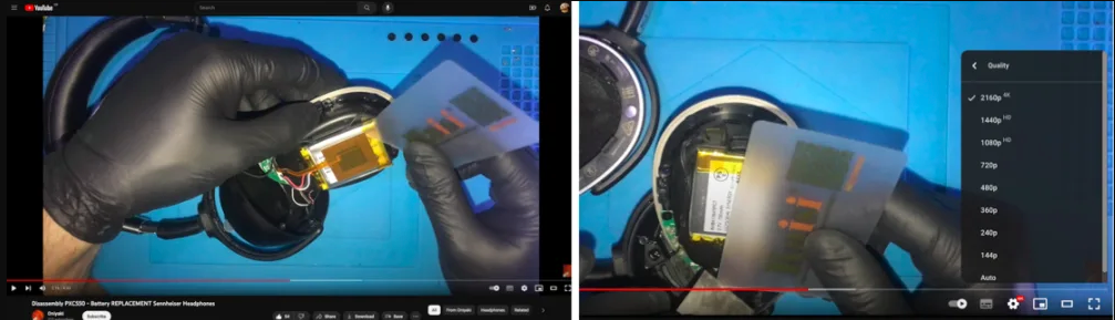

Another seemingly obvious tip, (but not always followed!), is to check if someone has done this before. Having a search online for your model with words like 'teardown', 'replacement', 'hack', 'problem', 'fix' or 'repair', etc. can often yield results.
I got this overview on repair from YouTuber Oniyakiand it not only told me how to change the battery, but gave me visibility of the serial number of the battery...
Not only this, but you can gauge how likely you're able to be able to replicate the repair/fix. This was a pretty straightforward one, but as I mention in my longer blog series, different products can be much more complex, sometimes the 'best' brands might be the hardest to repair - as I found out! (Part 3 of blog series ft. - Bose & Sony).
Having disassembled a staggering range and number of appliances whilst I was a graduate at Dyson, I can say that you really start to develop a 'spidey sense' for where hidden screws (under stickers), or snapfits (away from screw bosses) might lie, and if you are a designer, or even a keen maker, even a 'basic' product can have some nifty design tricks you can learn (or indeed - avoid!) in your work. As they say 'great artists steal' - so don't 'reinvent the wheel' if someone has made a great dis/assembly feature!

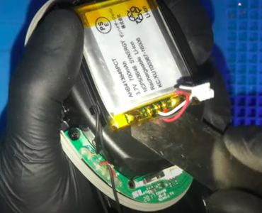

Step 4: Battery Details: Serial Numbers
So now you're armed with the Serial Number: "ABH413645PCT" And you haven't even picked up a screwdriver!
In case you were curious as to what those numbers meant - it's simple, (once you know!), they are the dimensions:
  • First Pair of Numbers: "41" is divided by 10, and is the thickness = 4.1mm
  • Second Pair is the Width = 36mm
  • Third Pair is the Length = 45mm*
*This includes the PCB (known as the Battery Management System (BMS) - which helps ensure it does not dis/charge too aggressively) on the end, though this can have a bit of variation (ie could be 46mm).
Many LiPo batteries have just 2 wires (positive, usually red, and negative, usually black). However, if you have a third wire (usually white), this is for a temperature sensor, which is integrated into the battery itself (or on the PCB).
Be sure to observe (or add this to search terms) when sourcing a battery, it DOES MATTER, as it helps you avoid a fire! So don't be tempted to 'get away with it' by using a 2 wire battery to replace a 3 wire battery.
FYI - products which only use 2 wires often have a temp sensor integrated elsewhere, so this is not 'bad' design, just different design. So make sure you switch out with due care and respect for the right configuration.

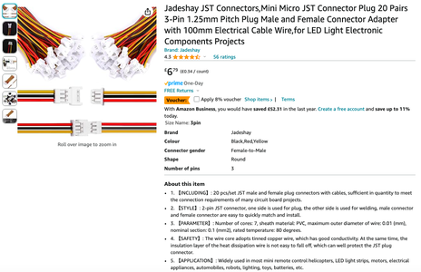

Step 5: Battery Details: JST Plug
Unless you've bought a 'for parts only' purchase on eBay, you'll have the correct plug on the old battery, so this step is more for education than necessity...
However, you may well need to cut this off and solder this onto the new one, if it does not come with the correct JST plug. Assuming you're here on Instructables, chances are this will not be too tricky, but I would still advise use of 'heat shrink' to do a nice job and avoid shorting.
However, if you get lucky on AliExpress, they battery may be sold with the correct JST plug. Again, as with serial numbers it's hard to know exactly what these relate to...
...if you see 1.25mm JST, (see image), this means the 'pin-to-pin' distance is 1.25mm. They come in 1.0mm, 1.5mm and more besides, so do check carefully, or you'll be splicing the wires!
Also, when you do buy the battery, do check the sequence of the wires! I ordered 4, and one of them had the positive and negative inverted! So I could have shorted out my device, or frazzled the battery, so check first. You can change these by sliding a spudger or knife under the 'clips' (see photos) and pull the wire, so the terminal (Molex) clip comes out.

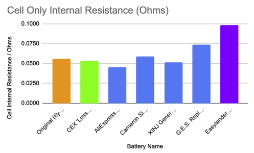

Step 9: Battery Testing: Internal Resistance
DO NOT try to measure internal resistance of a battery by measuring the Red and Black wires in 'Resistance' on your multimeter, as even though this will *p[probably* not blow it up, it may damage the battery, and also give a erroneous reading anyway.
I go into this in more detail of Part 5 of my blog series, but the gist is that Internal Resistance is a good indicator of battery health - the higher resistance is, the more likely it is old/less effective. So if you're getting into this from a product design / procurement perspective, these Internal Resistance devices are quite affordable and may be useful in checking supplier quality.

Step 18: Repair Step 4: Un-Clip & Un-Stick Battery
Gently unplug the JST clip. If possible use a *plastic* spudger/plier to wiggle free, rather than yank the wires.
Gently remove the battery - it'll likely be stuck down with double-sided tape, so needs a patient and slow process. Use an old credit-card/store-card to slide under if difficult to free, without bending the battery if possible.
If at any point the battery gets warm or expands even slightly, stop doing anything and put the whole thing in a bucket of sand, in case it is about to explode.
Step 19: Repair Step 5: Note Battery Serial, JST, Polarity... Check With Replacement Battery
This really is worth repeating - don't assume your replacement battery has the same polarity. So double-check!

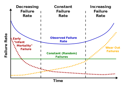

Step 23: The Nature of Failures - Bathtub Curves
This may be a lot of detail for a pair of Headphones, but this is one of the most useful principles in 'failure mode analysis' (why and when stuff goes wrong) I learned at Uni in textbooks - but really (and I mean really) saw in practice when at Dyson!
The 'Bathtub' Curve as it's known informally, illustrates that the rate of failure is high at first...this is because you may have connected something wrong (instant failure), or it might work loose (fail in a short while)....
...but after those initial 'quick' failures, generally things go along ok for a while...
...until after significant time, when things wear out, work loose, and failures start to rise again.
Hence the shape.
This is mot a promise to say after 10 recharges and 2 weeks for your headphones it's all '100% safe', but it's to imply you should be especially vigilant at the start to check for failure, unusual smells, sounds, heat, noises, etc. Anything weird or different - be suspicious, and double-check.
Certainly when doing an unofficial repair like this, one has to accept responsibility to assume things might go wrong. The fact is the batteries from Ali-Express might be fine. Indeed, many rumours that they can even be identical to the originals. But you can't prove this, and it could just as easily be counterfeit - and substandard. It could go wrong, so one has to be cautious and anticipate this may go wrong. So please don't leave your headphones charging unattended for a good number of re-charges / weeks until you're really confident these are stable.

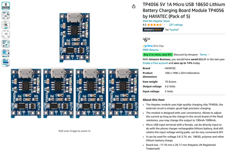

I ended up doing a sort of 'heart bypass', by adding a new re/charge circuitboard (TP4056) - which worked!!

I originally thought the LiPo battery was the fault. But after testing 4 different batteries, statistically speaking, that shifted the suspicion onto the headphones' hardware, rather than the LiPo.

Step 26: TP4056 LiPo Re/Charger Board
The TP4056 board is a great LiPo re/charge board for prototypes and projects which are under 1Amp (at 5v).
The general idea was to accept there was not enough space to add this inside the headphones, but I could add a 'wart' on the outside to house it, and allow access for recharging.
I tested the circuity before designing, and was pleased it worked. Do take care with the polarity and load/input of the battery (I did 'smoke' one by accident (luckily not the headphones) - so it's easily done!).
I did also 'upgrade' the battery from 700mAh to a 1100mAh battery, as it *just* fit. That said, the reason LiPos often have 'room to spare' is by design - LiPo batteries often expand 'pillow' as they age, so this is to accommodate this. So do not just 'use up' the space without consideration of it, it's necessary to avoid rupture.

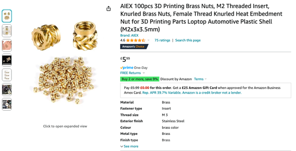

Aside from the TP4056, above, I used M2 Slim Screws and M2 Brass Inserts to fix the 3D printed parts.
The 'bypass' cables were 1.25mm JST connectors.

NB: If you didn't buy the male and female 1.25mm JST connections, you can do all of this without, by soldering and heat-shrinking all the wires in turn... but it's just more fiddly.

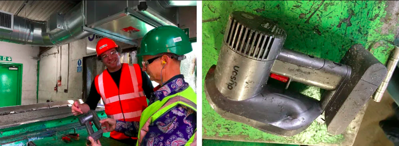

Step 41: Extras - Visit to SWEEEP Kuusakoski
I also visited the UK's largest e-waste recycling centre, SWEEEP Kuusakoski. I even ended up finding a product I helped design more than a decade ago - the Dyson 35! Read more about it here.
