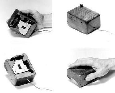

The first prototype of the mouse consisted of a carved wooden block with two metal wheels and a single button. Bill English (the chief engineer at SRI) built it in 1964. A patent was filed in 1967. The patent suggests using a quadrature encoder or a Gray code with the wheels.

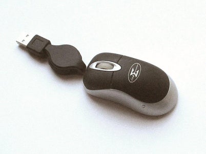

But it requires a ball-mouse with a USB connection and they're very hard to find. It takes quite some effort to make that sort of mechanics and I didn't have the enthusiasm so I decided to use the electronics from an optical mouse. It will also be more reliable that way. You'll need quite a small mouse: search eBay or your favourite supplier for "retractable mouse" or "small mouse". It should cost around £5. Douglas Engelbart's original mouse had a square hole in the bottom which looks exactly like the hole in an optical mouse. I wonder why.

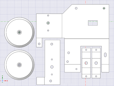

The chassis can be made from folded aluminium sheet. Ideally you should use 1mm sheet but I only had 0.5mm which worked just fine. The wheels should be from 4mm aluminium sheet but I had just enough 2mm sheet to make them.

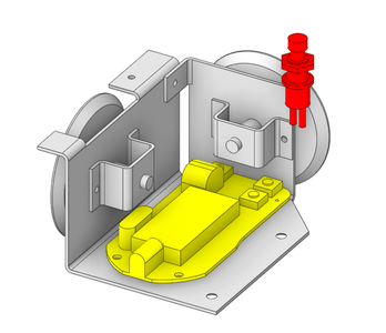

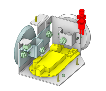

In the two-button mouse, the "y-wheel" is carried on a sliding/pivoting plate. If you press down above the y-wheel, it operates a pushbutton.
I first cut out paper templates and folded them to shape to try out the design. Then I used the templates to mark out the aluminium sheet.

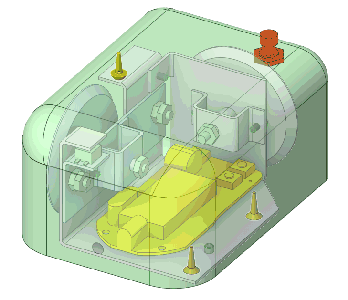

The animation above shows how the parts fit together.
The wheel axles consist of an 18mmm long tube with 4mm internal diameter. Soldered round it is a 9mm long tube which acts as a collar. The brackets have a 9mm gap so the axle can rotate but the collar prevents it from sliding lengthways. An M4 nut-and-bolt secures the wheel to the axle. The bracket is held on with 2mm self-tapping screws.
The pivoting plate is held onto the main chassis with M3 nuts-and-bolts. Two nuts form a lock-nut so the plate is free to pivot. A "tactile" push button is glued between the chassis and the plate. The contacts of the push button are connected across the right mouse button.
The PCB and its sensor chip are hot-glued onto the chassis. The bottom of the lens assembly must be at the correct distance from your desktop. The gap depends on the chip in your original mouse - with my mouse it was 2.4mm.
The remaining corner of the chassis is kept at the correct height by the end-stopper from a ball-point pen. It's glued into a hole in the chassis.

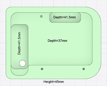

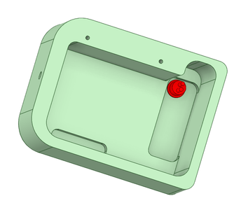

For the wooden block, I chose cheap pine. Better quality fine-grained wood would be easier to work with but I wanted to match the original. You should drill lots of holes in the block then use a chisel to connect them up. If you have access to a milling machine, that would be a lot easier. The chassis is held in the block with small woodscrews.

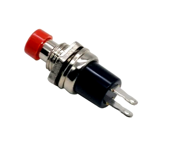

You can find a suitable push button by searching eBay or your favourite supplier for "7mm push button switch". The push button is connected across the left mouse button.
