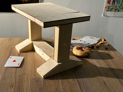

That is what you can tell your friends - in reality, the Flip-Off is the table with an attitude. If you place an object on it, it will throw it right off. When items are placed on it, the table flips 180 degrees then back, propelling all items off it.
The Flip-Off; the most reliably horrible table on the market.

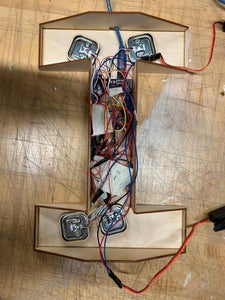

This circuit is based on a sensor-actuator relationship. Four load cells sense a change in weight on the table and cause two servo motors to rotate the tabletop from 0 degrees to 180 degrees, then back to 0. This causes all objects to slide off the table.
The servo motors are connected to the breadboard for power, and their signals are sent through the Elegoo UNO R3 Controller board. The load cells are connected in a Wheatstone Bridge configuration, which then connects to the HX711. The HX711 provides power to the load cell through the breadboard, while sending signal to the Elegoo.

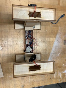

First, assemble the base of the table, without the tops, followed by both legs. Use superglue to connect all wooden parts and follow the 3D model provided for guidance. Make sure to not close off any areas where wires will sit. When sticking the sides, make sure the walls are glued to the sides of the base - bordering the piece. Create the frame for the load cells, and ensure they sit snugly within them. Make sure the movement of the middle part of the load cell is not restricted by the frame.
Step 4: House the Circuit

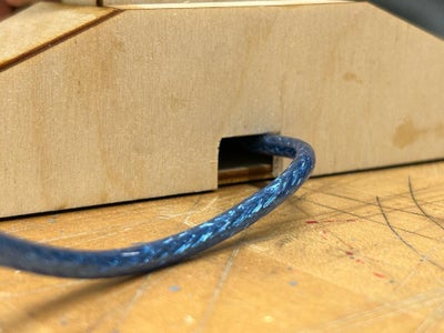

Next, place the circuit into the base part, ensuring two load cells are positioned on either side as seen in the image. Make sure to slide the USB cable through the designated slot as seen in the second image.

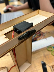

Next, separate the servo arm from the rest of the servo. Pull the wires through the leg of the table and slot it through the whole. Position the servo into the small hole on the side and then push the servo arm back onto the rest of it. This should appear to sandwich the plywood between the servo arm and the servo box, as seen in the image. Repeat on the other side so that both servo arms are facing inwards.

Next, ensure both load cells are placed beside each other at either end of the base, then position the legs on top of the load cells. Make sure each leg covers its respective two load cells so that the load from each leg is distributed evenly between both components. Once positioned properly, superglue both load cells to the inside of the base, making sure they face upwards, with the table legs coming into direct contact with the middle of the cell.
Step 7: Table

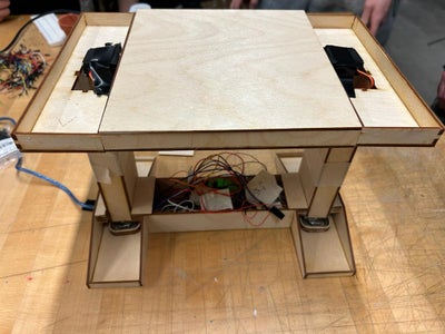

Next, assemble the main box which will act as the tabletop. Then slot it into the servo arms and ensure it sits nicely. Using the small Philip screws, secure the servo arms to the box. This would be a good moment to do a test spin with the code, to ensure nothing gets caught during the rotation. It might be worth sanding down the sides to ensure that it turns smoothly.
Step 8: Close It Up
Next, close up all openings and ensure that all wires and components are tucked neatly within the table. As in all previous steps, use super glue to connect all wooden parts.

After assembling the table, it must be calibrated in order to function properly. In order to ensure that the table is flat when plugged in, the variables servo1Start and servo2Start can be adjusted. After you are happy with the tabletop and setting the variables up, plug in the table again to read the values that are printed in the Serial monitor, representing the load on the sensors. You can take this value and add to it, experimenting with how different items affect the value in order to create the threshold at which the table will flip. This value is stored in the variable threshold, which can be adjusted.

Like all projects, there were some aspects that went better than expected, and some steps that took a few tries to get right. What went better than expected was how well all the components fit together, and this is largely due to the setup of the laser-cutting file and 3D model, as careful measurements were made when constructing both files. Second, contrary to our prior opinion, balancing the tabletop with the servo motors did not prove to be an issue. This has to do with both the quality of construction of the table itself, the size and scale of the table relative to the motors, and the strength of the motors themselves.
As we were prototyping the Flip-Off, some design changes had to be made. Our original idea was to have most of the components within the flipping plane but we decided it would be much more consistent and feasible to have them below the table in a more stationary area. This way, the components wouldn't shift around and come loose - which would serve as a problem as the purpose of the Flip-Off is to provide an unstable surface.
Another difficulty that we came across is that we thought the servo motors would go from 0 to 180 with decent accuracy. It turned out that they would often rotate past 180 by about 10-20 degrees, so the translation from digital to real life was not perfect. To solve this we had to calibrate them while assembling, by setting the total rotation lower than 180 degrees by however much it took for the servo arm to lie flat horizontally.
