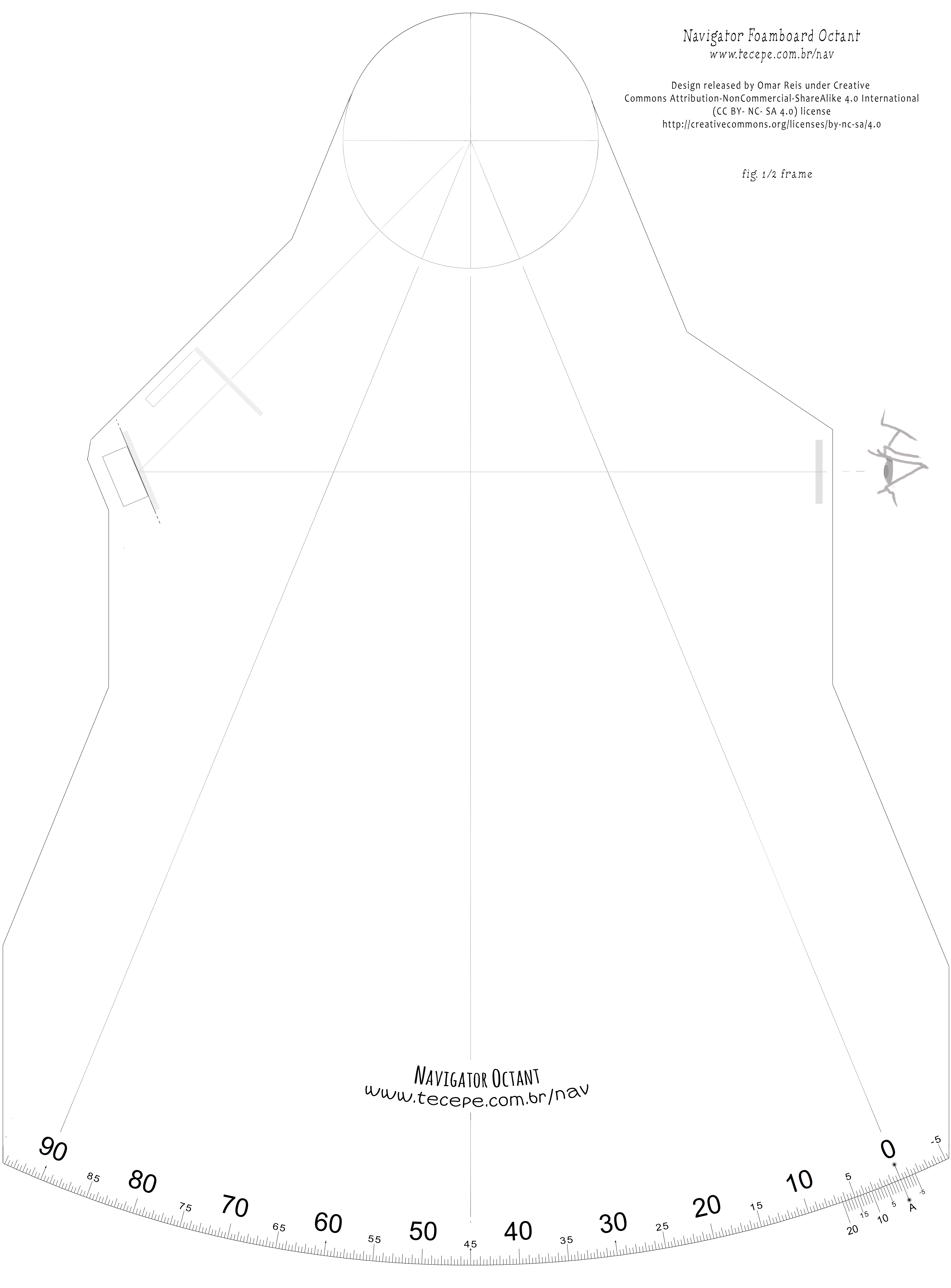

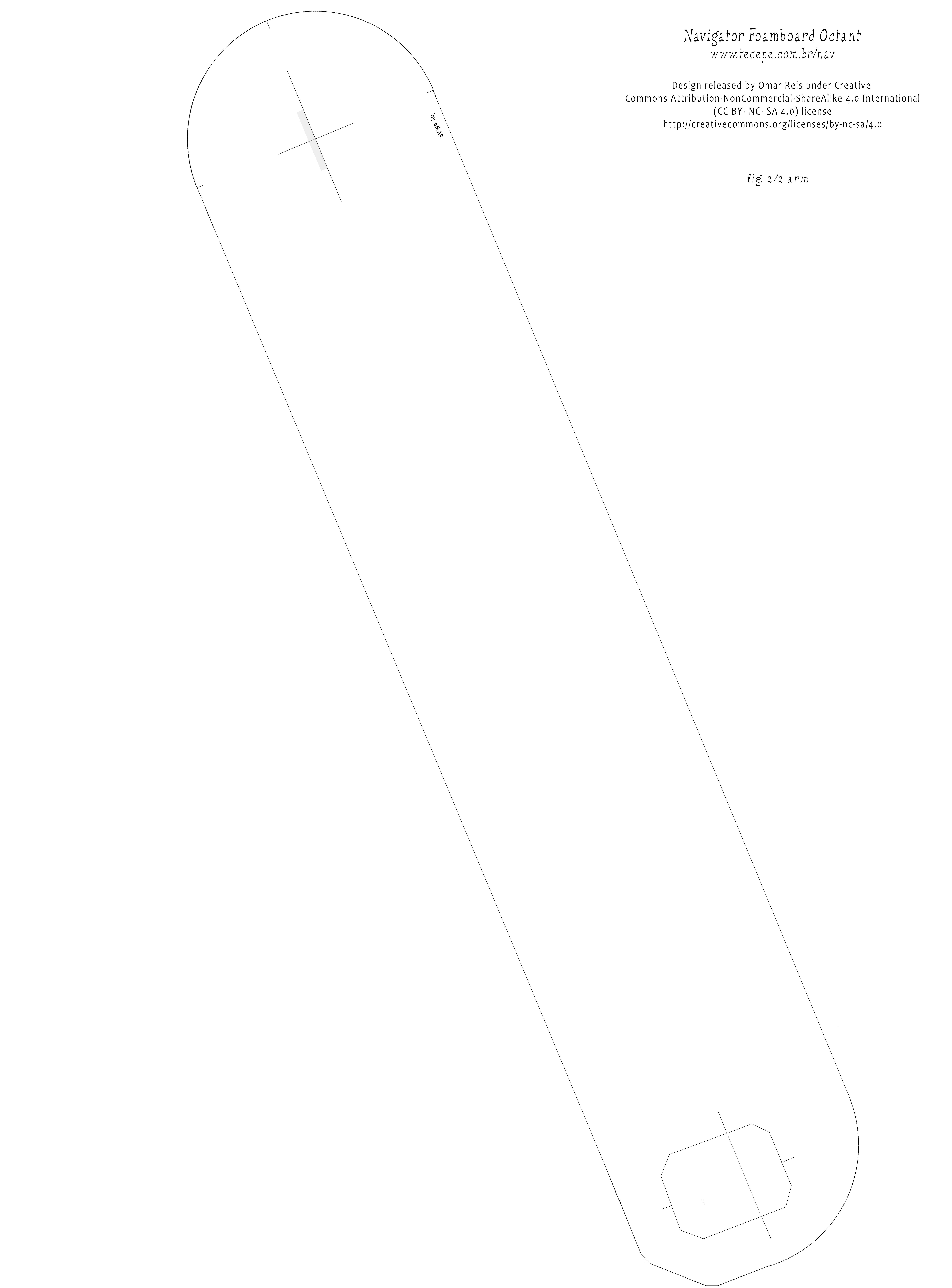

Step 2: The Octant Parts: Frame, Arm and Vernier
The two full resolution images containing the Octant parts are to be printed on wide A3 paper, using 600 dpi resolution. A3 paper dimensions are 297x420 mm. It can also be printed on A4 paper, if you don't have access to a wide printer. Note that you loose precision when you go smaller :(
To print smaller image, resize both pages by the same amount (%)
Note: Don't use instructable image to print. They are low resolution. Download the images from the links below.
Full resolution images:
and
I actually used A3+ format paper, the widest page my printer can take. This is a little larger than A3. A3+ is 329 x 483 mm and resulted in an octant of 37.5 cm of radius, which is large enough.
The instrument frame and arm images were printed on premium presentation paper ( density 145 g/m2 ) which is heavier and deforms less than regular office paper. The design uses a minimum of printing ink, to reduce paper deformation while printing.
Also to minimize deformation while bonding the paper to the board, a spray mount adhesive was used. The scale must be bond flat without bubbles or wrinkles. Any visible deformation will ruin the instrument precision.
Printer precision check
The scale image in this design was generated using formulas and is geometrically correct. What your printer will actually print is a different matter. But I found modern printers can do a good job.
Once you have the printed pages, perform a couple checks see how precise it is. Measure the radius R of the octant at different points ( 0, 45° and 90°). They must match to a fraction of a mm. Measure the distance D between 0 tick and the center line of the instrument. This must be:
D = R * Sin(22.5°) = R * 0.3827
For instance: If R=34.10 cm, D must be 13.05 cm
The distance from 90° to the center line must be the same.
If you have a navigation divider, measure a fixed arc at different points of the scale. This will give you and idea of the precision that can be obtained with your octant.
Pasting the scale pages to the foamboard
Use minimum amount of adhesive spray (don't let the page get wet). Do the job outside and spray the paper in regular movements, until the whole page is covered. Allow the adhesive to dry for 15 seconds and paste the page to the foam board in one forward movement. A clean paste operation will produce a perfect flat scale. No removing and re-pasting allowed. If you mess it, print another scale .
Press the page with a heavy book on a flat surface and allow it to dry for some time.
Cut the pieces
With a sharp Paper Cutter, cut the frame and arm pieces . Cut along the main scale arc carefully. Cut the piece around the small scale (the Vernier). Smooth the arc edges with sand paper. Note that the main scale and the vernier must touch each other and the arm rotation must be smooth across the whole arc (see photo).
Cut off the arm window. The Vernier scale piece will be bond to the back of the arm, but don't do that yet !
This will be the last thing after the axis is mounted and the mirrors are in position. So wait.
