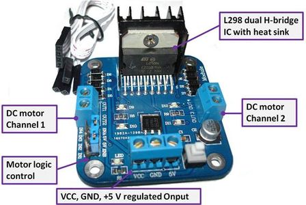

- If you are an advanced Arduino-user, this is where you could use the optional L298D Motor Driver to give it more boost. Otherwise, ignore the diagram of the L298.
