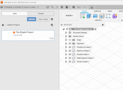

I organized my components into 5 parts (although only 3 were used by the end, better safe than sorry). The important components designed were:
- The Wooden Arch Base: the visible floor of the bridge.
- The Metal Arch Base: the support beams!
- The Wooden Sides: The railing and safety net of the bridge.

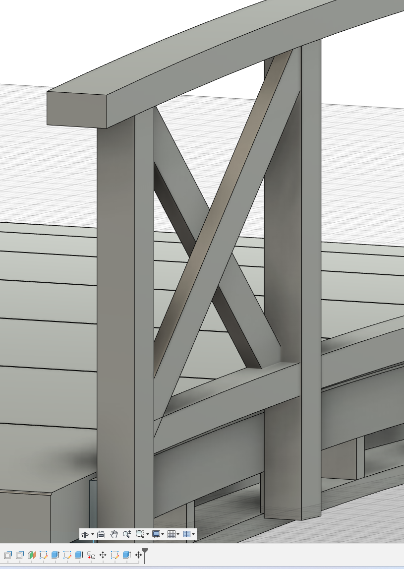

To design the railing, I made a 5x5 inch sketch on the horizontal plane just along the edge of the wooden base and metal beam. I extruded the sketch 4.5 ft up and 0.5 ft down to make the pillar a total of 5 ft tall in total. With the size of one pillar established, I duplicated the pillar 5 times with a path pattern that followed the arch of the metal beam. To make the top of the railing, I made a midplane between pillars and drew up a sketch to match the arch. It was extruded to make a 20'x8"x4" arch. The bottom of the railing was made in the same way but the dimensions were scaled to inside the pillars. The cross beams on the railings are designed to not intersect but support the railing well at its angle. Each cross-beam slab is 4'8"x5"x2" and the edges are meant to be cut to fit each corner between the pillars and the top bar. 10 slabs will be needed to complete one side. With that, the design is reflected on the other side of the bridge and the railings are complete!

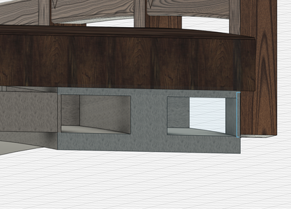

To make the curved beam, I made a sketch along the side of the bridge and extruded it. The final dimensions for the beam: beam height: 8", flange width: 2', flange thickness: 2", web thickness: 5", and beam length: 18'. Besides these dimensions, the beam has some welded add-ons. Between the railing and base, there is a thin 1"x6" steel add-on (curved according to the arch) that is meant to be welded right on the corner of the beam. This edge is meant to act as a place for the arch base to rest and for bolt placements. After that, there are add-ons within the insides of the beam. Along the positions of the railing pillars, there are 0.5" thick steel sheets for additional bolt placements. In the middle of each of these segments, there are 2" thick steel supports. I believed these supports would help the beam stability and in keeping its shape.
Although the base beam is custom-made for the bridge, it can be replaced with one of similar dimensions as long as the metal add-ons are welded together well.

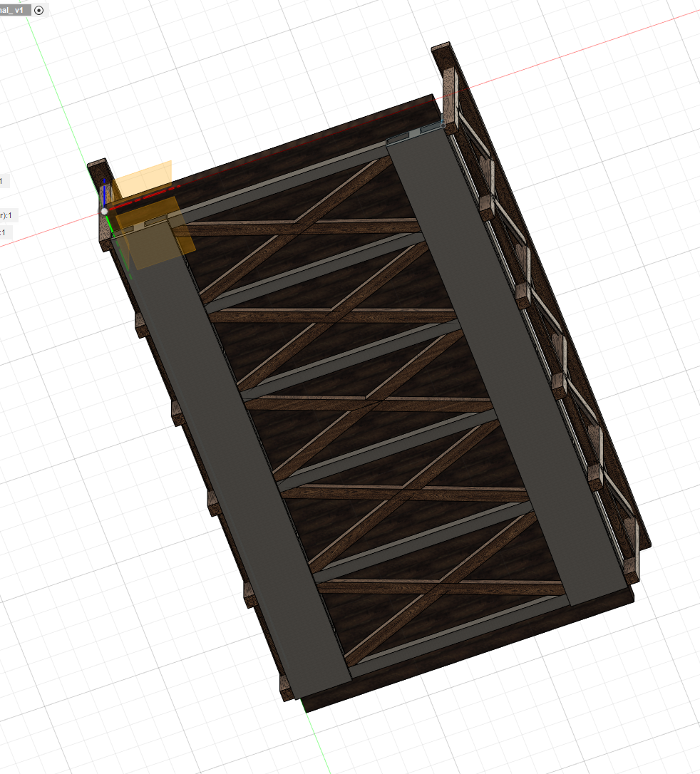

To create the underbelly of the bridge, I first designed the steel parts that would complete the steel foundation. I created a sketch on all of the steel sheets on one side of the underbelly (parallel to the railing pillars) and extruded the sketch to meet the paired sheet on the other side. These beams were 5"x5"x8'. This may be difficult to visualize but please reference the photos attached above. Once the 6 steel beams were aligned evenly along the bottom of the bridge, I designed the wooden cross beams that would go in between each segment. These were designed with the use of midplanes and path patterns to get the exact angles correct for each part. An individual crossbeam's dimension is 5"x4"x9.5', not including the edges and centers that would have to be cut in order for the panels to fit together. Ideally, for the center of the intersecting beams, one of the beams can be cut to match the other. However, I displayed another method of intersecting the beams in my physical 1:20 scale model.

To make the underbelly: I used 0.25x0.25x11.8in square wooden dowels. The metal beam parts of the underbelly would be cut to exactly 4.8 inches (for a 1:20 scale). The crossbeams, however, were cut not exact cuts every time. I used angled cuts on the corners to make them diagonally fit inside. But how would they intersect? There are many answers to this question but for this physical model, I went with half-lap joints! I carved out half the intersecting parts for each crossbeam, paired them, then stuck the crossing pairs in between each metal support beam with wood glue. Took a bit of trial and error, but I'm pretty proud of the results.
