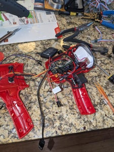

Step 5: Add a Wiring Harness to the Housing
Once you've settled on a housing, you'll want to add all of your peripherals to the housing and solder up headers to everything so that things can be easily attached to the electronics package. Collectively, I'm referring to the peripherals and the wires attached to the housing as the "wiring harness."
Here are the steps that I followed when modifying the flashlight:
- Open up the housing and see what all can be removed. My flashlight had a big LiPo battery, a controller board, and then a detachable white plastic bracket that holds everything. I pulled out the battery and desoldered the wires from the controller PCB so that I could remove it. I left the blub of the flashlight as-is, and I also left in the trigger, since I wanted to use it in the interface.
- Do a test fit to get an idea of where the electronics package will go in within the housing. It's good to figure out exactly what the orientation will be at this point. I used this to get an idea for how long I would need to make the various wires in the harness.
- Measure the diameter of the buttons and knobs you want to attach, and then drill holes in the housing for these. Attach buttons and knobs firmly to the housing. I ended up using two momentary switches and a rotary encoder. While doing this part, I would sometimes put the two halves back together so that I could test how the whole thing felt. This helped to pin down the best button position. Ergonomics!
- Add two additional holes: one big one for the USB cable to pass through and one smaller one for the RGB LED cable to pass through.
- Draw up a schematic for how to do the electrical connections (see what I ended up with back in Step 2). All of the momentary switches are connected to +3.3V at one end and to one of the RPi GPIO pins (via a 2 kOhm series resistor) at the other end. [NB - I just assumed that the flashlight trigger was also a momentary switch, but this would have been a good moment to confirm that with a multimeter.] The RGB LEDs require one +3.3V connection, one GND connection, and one GPIO connection. I wanted to minimize connections to the RPi, so I ended up with just one +3.3V connection, one GND connection, and 7 GPIO connections, all of which I labeled. The two sides of the shell actually share the same +3.3V connection, so there's an additional pair of headers to connect the two shells together electrically.
- Wire it up! There's definitely some art to this part, so I can't describe the steps exactly. Try to stay as close the edge of the housing as possible. Keep wires in tight bundles rather than letting them dangle in big loops. Use heatshrink tubing or hot glue to add insulation when necessary. You can use the thick wire from the clipped leads of resistors to make semi-rigid connections that will hold their position well. Hot glue is your absolute best friend here; when you reach a nice state with the wiring, use a bead of hot glue to tack it into place. After this, you can proceed to tug on the wires or let them go, and you know that everything before the hot glue will remain where it is. With these ideas in mind, I worked my way from all of the peripherals out to a bundle of wires with headers for each of the sides of the shell.
- Test all the buttons. I wrote a simple little Python script (see the repo) to read the state of all of the buttons and print their state a couple of times a second. With this script, it's easy to confirm that everything is connected and numbered correctly. I did this all at once, but a more conservative approach might have been to test all of the peripherals at an earlier stage, e.g. after soldering the first wires to the peripheral. There's never any harm from testing more often. I have to say, it's very satisfying every time I see a working button.
- Finally, do a rough test fit to make sure there's enough room for the electronics package. You will be very grateful for any space that you're able to make at this stage.

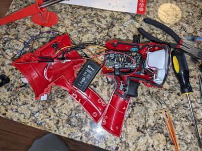

Step 6: Close Everything Up
The whole rub here for me was my plan with the RGB LEDs. I knew that I wanted to glue those to the housing, since that was the easiest thing, but I figured that this would mean I would be unable to open up the housing non-destructively. I was worried that the ring of LEDs would break apart while trying to remove the black rubber bumper. So I wanted to make sure that I had enough access to everything that I needed from outside of the housing. Importantly, I needed to be able to (1) charge the battery of the PiSugar (requires USB-C connection) and (2) turn the PiSugar on and off (requires access to a small button on the PiSugar PCB).
At first, I had a pipe dream that I would be able to remove the electronics package without disassembling the detector. After doing some test fits, in which I tried to connect everything and close it up, I realized that there was basically zero additional room. The biggest "gotcha" for me was the height of the headers that I was using to connect to the electronics package. These take up a lot of room, and I had not been accounting for them in the fits that I was doing throughout the previous step. The length of the little USB cable was also constraining the orientation of the electronics package; I ended up having it at a funky angle.
During the test fits, it was clear that I wasn't going to have easy access to the power button or the USB-C port on the PiSugar. For the USB-C power, I just added a cable that I had lying around. For the power, I soldered two header wires in parallel with the power button on the PiSugar. With the benefit of hindsight, I should have soldered to some pads provided on the PiSugar PCB (see Step 1.4 above), but instead I did this with the cruddy iron that I had available. It was working at first, and I decided to try potting it with hot glue. This worked up until the point that I had tightened screws to attach the two shells together. I ended up having to take this power connection back out for surgery a couple of times, but I eventually got it in a fairly stable configuration. I figured that, in the worst case, I would be able to reach in and touch the actual power button with dental tools or something. For now, I just need to essentially "hot wire" the RPi0 by shorting these two wires together.
The whole thing was an incredibly tight fit. I considered opening up some holes in the housing to add more room, but eventually I found an arrangement that worked. Think of it like one of those packing puzzles, I guess. Except if you push too hard it breaks your precious solder connection and you have to take the whole thing apart again. π₯²
When you've finally tightened all of the screws, test the buttons, test the LEDs, test the audio, and test the GPU. I have simple scripts for doing all of these tests, along with some instructions for how to set up the RPi for these things, all in the repository: Julespeak/ghost-detector-9000: The Ghost Detector 9000 (github.com). Let me know if something appears to be missing, and I will add it.
