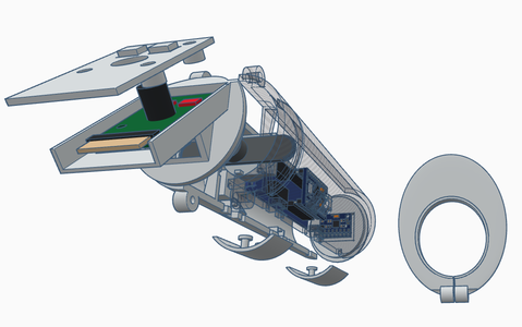

3D printable parts
I designed all the parts to be easily printable and functional.
Grip and Handrest: The main grip is printed in two halves. It's designed to be ambidextrous, with four pushbuttons placed for easy access from either side. A separate handrest is fixed around the bottom of the grip for better ergonomics.
The "Gimbal": The IMU is mounted inside a half-dome that is fixed to the bottom of the stick. This is the part that allows the controller to tilt in any direction for X and Y control.
Top Controls: On top of the stick, there's a mount for a 5-way coolie hat and two additional multi-purpose buttons. Right below this is the rotational dial which is connected to the potentiometer for throttle and rudder inputs.
The printable parts can be downloaded from tinkercad as version 4.9 or 5.9

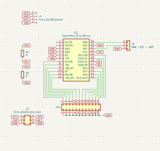

Taking it to the Next Level: A Custom PCB with KiCad
For this project, I designed a simple "shield" that the Pro Micro plugs into. This shield has dedicated connection points for the potentiometer, all the buttons, and the IMU, which keeps the internal wiring incredibly tidy.
The best part is that powerful PCB design software is completely free. I used KiCad, an open-source and incredibly capable tool for schematic capture and PCB layout. The basic idea is:
Draw the Schematic: First, you draw a logical diagram of your circuit in KiCad's schematic editor, showing how all the components (the Pro Micro, buttons, etc.) are connected.
Lay out the Board: Next, you switch to the PCB editor. Here, you arrange the physical footprints of your components on a virtual board and then draw the copper "traces" that connect them, just like you drew the wires in the schematic.

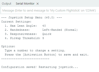

The On-Board Setup Menu: No More Re-Uploading!
Instead of changing settings by editing and re-uploading code, you can configure the controller on the fly through its built-in Setup Menu.
How to Access:
Unplug the controller.
Press and hold the activation button.
While holding it, plug the controller into your PC.
Open the Serial Monitor in the Arduino IDE (at 115200 baud). The menu will appear.
From this menu, you can customize and save the following settings directly to the controller's memory:
Max Lean Angle: Adjust the physical tilt sensitivity. Set how far you need to lean the controller to get 100% joystick output in-game.
Handedness: Choose between Right-Handed (Inverted) and Left-Handed (Normal) modes. This inverts the potentiometer's output so you can choose whether pulling the lever towards you increases or decreases the thrust/rudder value.
IMU Responsiveness: Fine-tune the feel of the stick by cycling through three Kalman filter presets: Smooth, Quick, and Fastest.
Pickup_threshold: Can now be adjusted via menue.
Once you save, the settings are stored permanently on the device. Your custom configuration goes with you, no matter what computer you plug into.

Step 3: The 3D Printed Body
A lot of work went into the 3D body for the joystick. Tinkercad does not provide the most advanced complex body development tools and I did not yet prioritize hobby-time to gather experience with Autodesk Fusion which seems pretty sophisticated. So the body of my HOSSTAR looks more like a kids building block work - but is does the job.
I created two versions - the first was a bit less ergonomic, so I worked on a more suitable form. Both forms worked very well in my flight sim testing.
The assembly is a bit ricky:
Solder required wiring to push buttons, poti and coolie hat. Best way is to use pin headers and connect using jumper wires. However you may run out of space. In the protoype I soldered the wires to the pins directly. Only for the connectors to the board I used socket headers.
You wil need to glue the bushbuttons into position with a small glue bubble - otherwise the assembly will cause real headache.
Fix the IMU to the bottom half dome as indicated in the Tinkercad model with two M3 screws. In version 2.8. the IMU is mounted facing down and the software is adjusted to this orientation. Needs to be considered when mounting in another orientation.
Fix the coolie hat with the cover to the top cap using 4 M3 screws and insert the wire through the opening so that it can be connected inside the grip to the PCB shield.
Put the thrust lever onto the potentiometer dial. The poti needs to be adjusted to 50% so that is can be dialed into both directions.
When all buttons and connectors are fixed make a test run! I had some bad experience having to diassemble a tediously assembled grip just because there were some connections nonfunctional.
put the handrest over the grip and the cover on the grip and use the screws to tighten.
