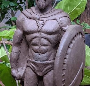

Introduction: The Greek Warrior (Terracotta)
About: I am an automotive clay modelling student. I love craft and was always interested in making things with my hands. I have studied fine arts in school and have experience of working with different materials.
I have been always in awe of a sculpted physique, but wasn't ever crazy enough to hang a poster of Arnold on my wall and daydream of emulating him. Even though I admired his body builder's build, my interest lay in competitive outdoor sports. As a result of this, I had developed an athletic build in high school but achieving a sculpted physique seemed unattainable, as food was too precious a sacrifice for those small gains.
Even more than a bodybuilder's physique, I value a Greek warrior's build because while the former's muscles are for show, the latter's is the reflection of man's potential in the physical realm.
The Greek warrior's body is the epitome of physical potential and all the components of physical fitness are embodied in him as a lethal combination. He is the powerhouse of strength, speed, agility and endurance; ever ready to spring into action.
Therefore I chose The Greek Warrior as the inspiration for my first sculpture in terracotta.

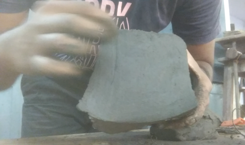

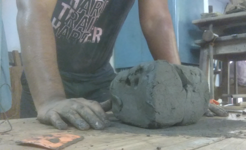

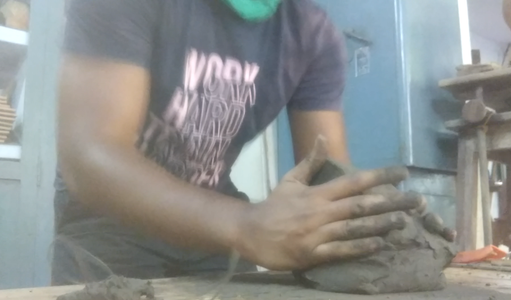

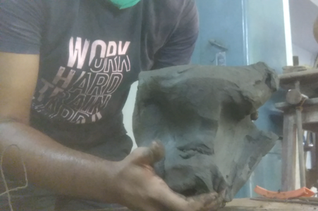

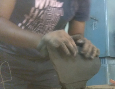

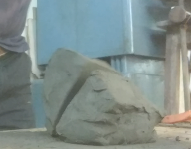

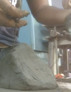

Step 4: Ways to Work on Clay
    • You need to knead and mix the clay till there are no air bubbles trapped inside. (image 1-7)
    • You need to mix well, till the texture of the clay is the same from inside out. (image 7)
    • The clay shrinks and dries quickly, so its best to work fast.
    • Always keep dabbing the sculpture with a damp sponge to prevent it from getting dry.
    • It also gets difficult to work and grains tend to chip off, if it gets too dry.
    • Whenever you join a new part to the body, crisscross with a knife at the site of joint, dab with water then fix the new part. (image 9)
    • After each session wrap the sculpture with a wet cloth and keep it covered with a plastic, to keep it damp and workable. (image 10 and 11)
    • Keep your tools clean, as dry clay stuck to tools can damage your sculpture.
    • Keep your work space clean, so that dirt doesn't mix in your clay.

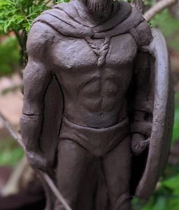

    Step 6: The Torso
    After achieving the rough volume
    • Work on the shoulders, the chest, the abdomen, the waist and the crotch region.
    • You need not work on the back and the hips as its covered by the cloak.
    • Study closely how each part seamlessly joins the other and their position with respect to each other.
    • View the statue from all angles from far and keep checking if the proportions are right.
    Tip to check proportions: Usually you would sit at a distance facing the statue, a pencil in hand, arms extended fully in front of you at eye level and squint with the eye, while using the pencil as a measuring stick to gauge that the Sculptures length is equal to 7 or 8 heads.
    You would take the length of the head with your pencil and gauge, if that length is repeated 7 to 8 times along the height of the sculpture.

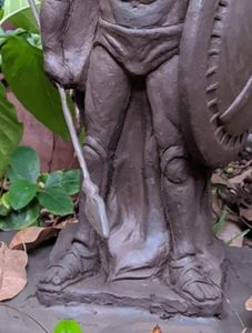

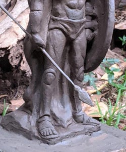

    Step 8: The Legs
    • After getting the rough volume, work on the details.
    • Begin by working on the thigh, the quads, the knee, the shin, the calf, the ankle, the foot and the toes in order.
    • Do the footwear after the feet and toes are done.
    • Its useful to study your own body parts to understand the volume.
    • You can also use a picture of a body builder or ask a friend to pose for you for reference.
    • Add cloth only after parts are done in detail, as the cloth takes the shape around the volume the part.
    Tip: Step back at times and see the statue from distance to check on its proportions, as you can be misled by seeing up close the entire time.

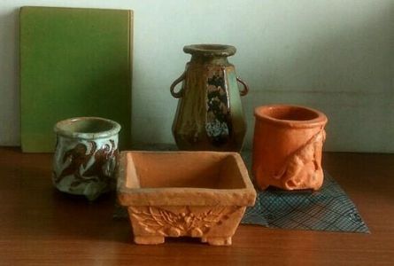

    Step 13: The Firing
    Now if you decide to immortalize your work, like the terracotta stoneware from Harappa and Mohenjo-Daro,use a kiln or an oven to fire the sculpture.
    • The image above displays the pots I had done in school; while all four are fired, two of them are glazed.
    • The clay turns from brown to brick red after firing. (image 1)
    • Terracotta firing temperature is around 600°C to 1000°C or 1112°F to 1830 °F .
    Note:You could pour some glaze if you want your sculpture to be more interesting like the tall vase and the pot beside it. (image 1)
