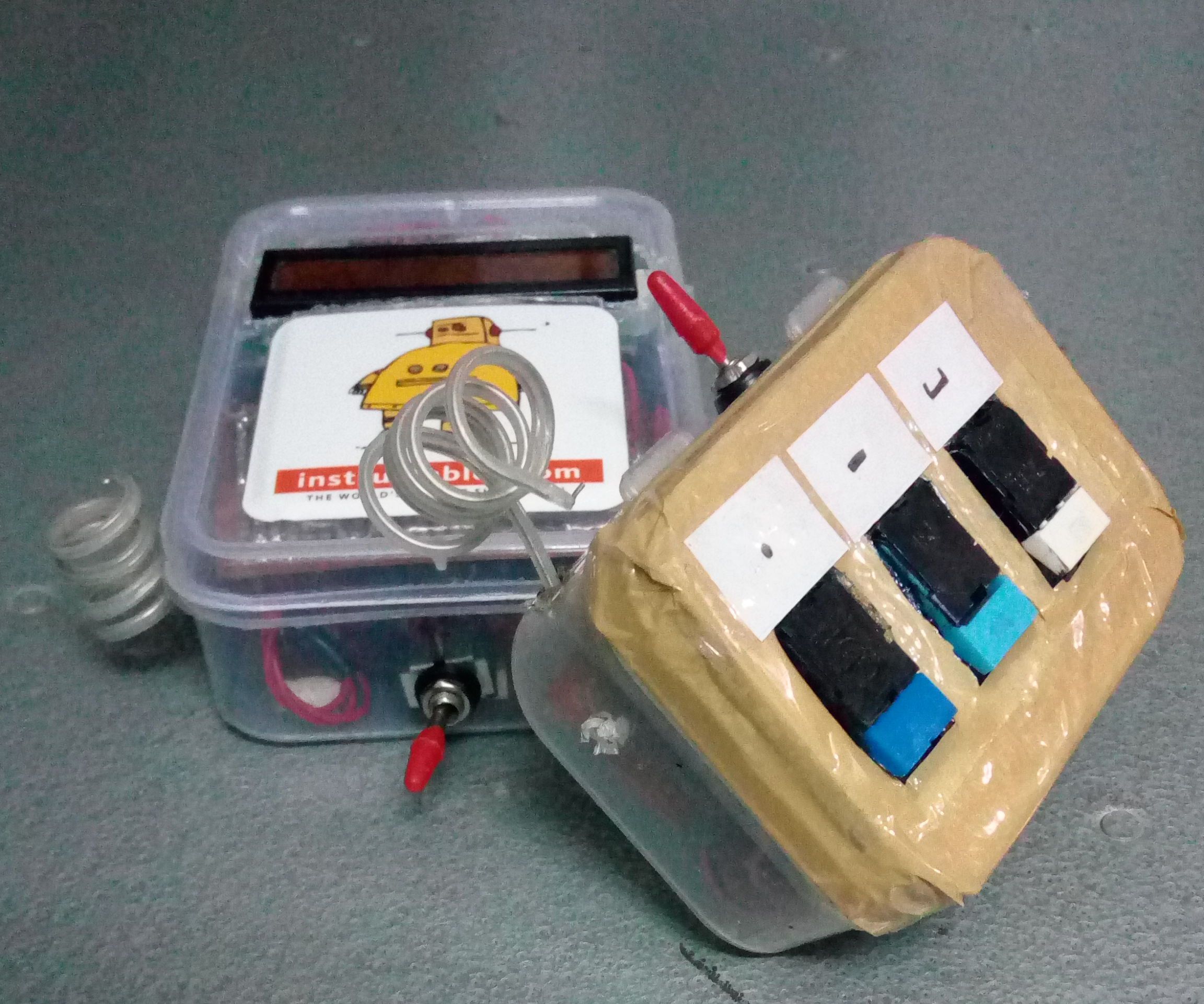

Step 2: Making the Enclosure:
The enclosure can either be made from acrylic sheets or you can 3d print it.for people who have access to 3d printing can 3d print the box or if 3d printing is not available then they can switch over to acrylic.
I made the enclosure using acrylic sheets as it was cheaper than 3d printing and also it gave a glossy Look.:-)

Step 7: Attaching the Switch and the Usb Circuit:
- In the previous step we connected the battery to the charge controller and we had two wires coming from the charge controller(Red and Black)
- Solder The negative wire(black wire) coming from the charge controller to the Negative solder point of the usb circuit(IN-)
- Cut the extra bits of wire from underside of the usb circuit
- Now,Take the Positive wire coming from the charge controller(Red in colour) and solder it to the middle pin of the toggle switch
- Take a piece of red wire and solder one end of it to the pin adjacent to the middle pin of the toggle switch(Btw it dosent matter which pin you choose to solder the wire but it has to be one from the remaining two pins)
- Now take the other end of the wire and solder it to the Positive solder point of the usb Circuit(IN+).
- Place the circuit inside the Box.
