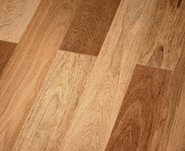

Flooring and/or Frame: Engineered Wood (LVL or LSL)
Description:
Laminated veneer lumber (LVL) and laminated strand lumber (LSL) are manufactured wood products that are stronger and more stable than conventional lumber. In modern buildings and homes, Laminated veneer lumber flooring and frames are getting more and more common, even your home might use it! Like the one I showed in the pictures it what it looks like in my apartment. And it’s been standing for a while.
Reasons I would use here, compared to other materials, or non laminated wood:
  1. More dimensionally stable, less prone to warping or shrinking over time during the seasons,
  2. Allows for longer spans and flexible interior layouts
  3. Sustainable when sourced from certified forests
  4. Reduces construction waste due to predictable sizes and strength
Alternative:
Conventional dimensional lumber is familiar and slightly cheaper but requires more material, generates more waste, and is more vulnerable to seasonal expansion/contraction over long terms.

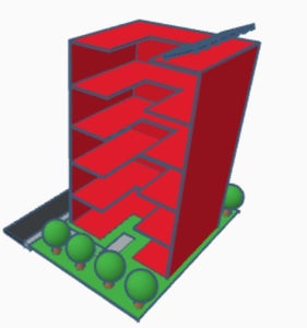

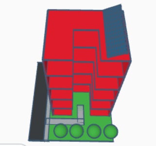

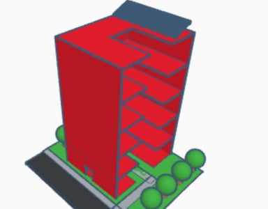

First of all, I am going to inform you that I am not an architect (sorry) and I am going with my instincts and some things I have learned over the years. So please forgive me if any of my drawings have mistakes, or inaccuracies (although if you spot anything wrong, tell me please!) I have designed the lower floor, or below ground level, where the laundry room is, nurse’s office, or therapy office, a gym for easy access to those who want to stay home and be healthy (also more cost effective, rather than going to buy gym memberships over the long term, especially for the elderly who want to exercise often), the main ground floor I added the kitchen, a event room, and other things. I have tried to add stairs more evenly across the halls and building, so that it will be more easily accessible.
Here is the TinkerCAD design link: https://www.tinkercad.com/things/0ahglKgfglT-harbor-of-hope?sharecode=GvqV3HWnrtol1ifqSrDjOWzEUAtdZI4odDhURvOYZeo
It’s a simple version of what I envision the complex to be, I am not a great 3D modelist, so I didn’t really add any extra details, for me, I prefer the KISS (Keep it simple, stupid) rule, or just KIS.
Cons or things I worry about my design:
I have not yet implemented any standards or requirements from the government that are required to be in place for buildings here, and I just build from what I think our community needs, and always, everyone can adjust things accordingly to make it work, so feel free to edit anything you learned here, and I would be glad to learn new things! I would greatly appreciate feedback on designs and ideas, plus additional thoughts.
P.S I have used Canadian English, for example “Center” is spelt “Centre” here in Canada. Just to clear some confusion you might have.
Step 5:
Physical Design:
My physical design includes the main floor, and what the second to fifth floors would look like (the second and fifth floor have same structuring and will not change). The building shape will be like a U, so that the middle there is space for an outdoors garden, or courtyard. I used wooden skewers to act like supports, and each layer of cardboard acts like a floor.
