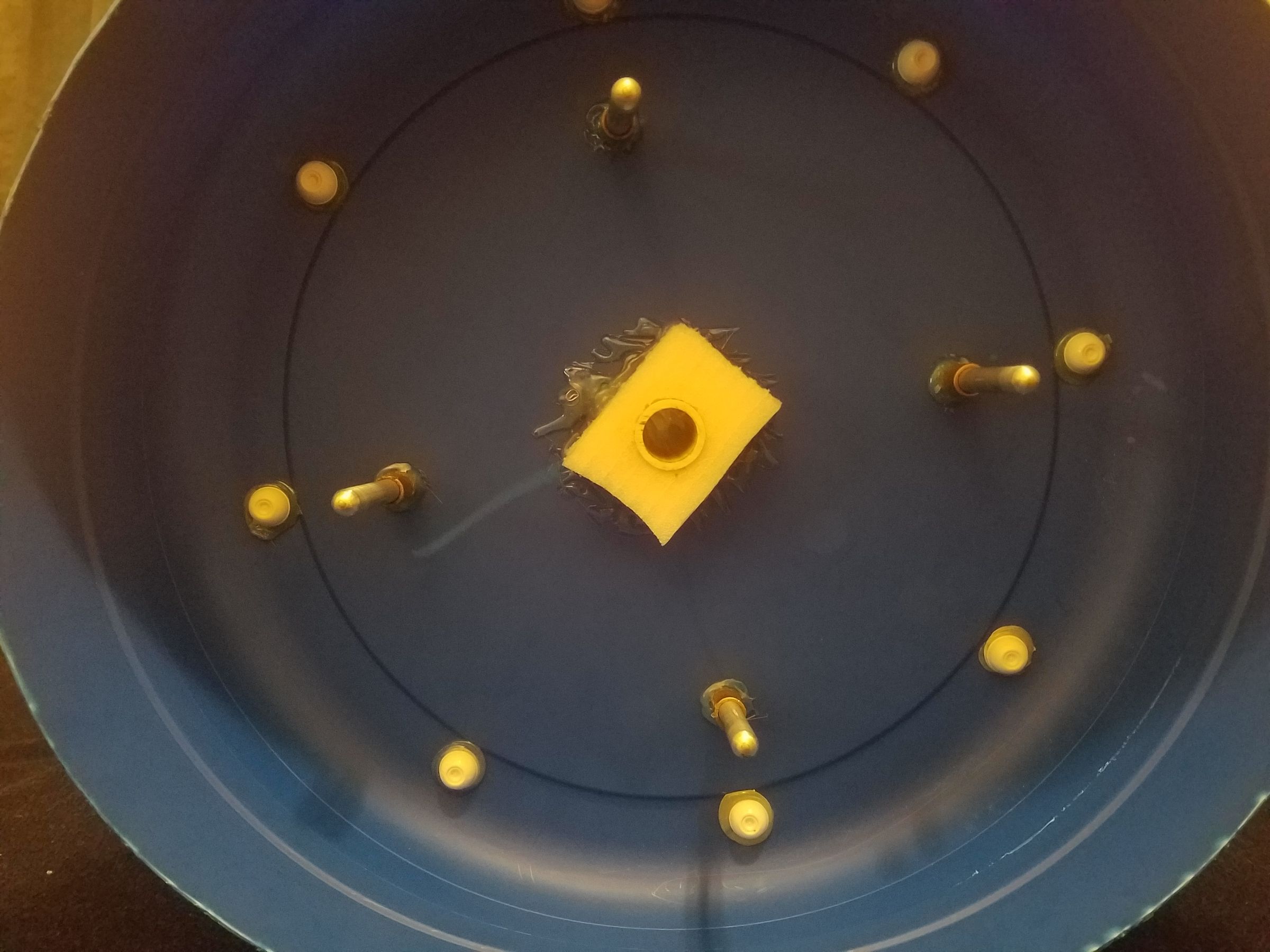

This is the bottom of the base, showing the push nuts and flange bearings.

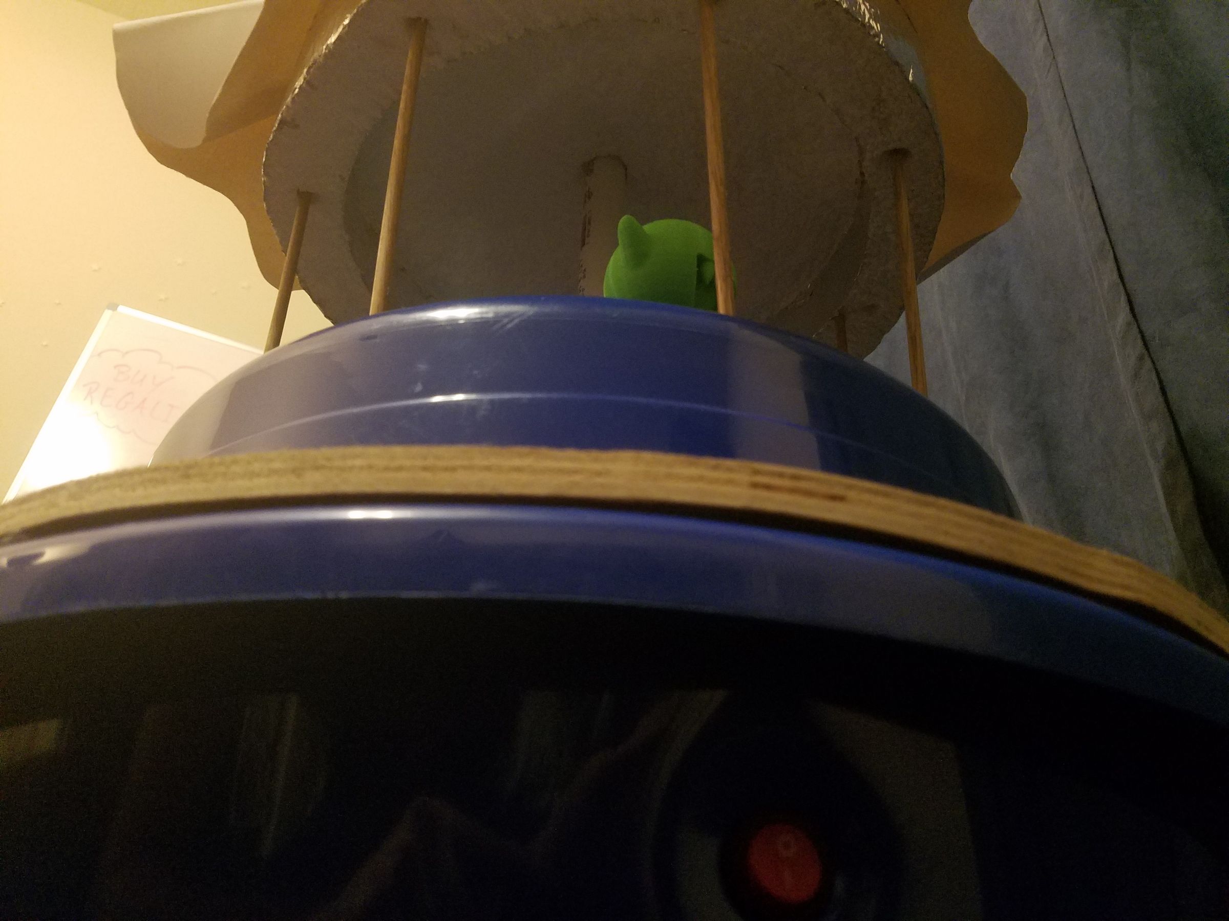

This is a side shot showing the view of the power switch.

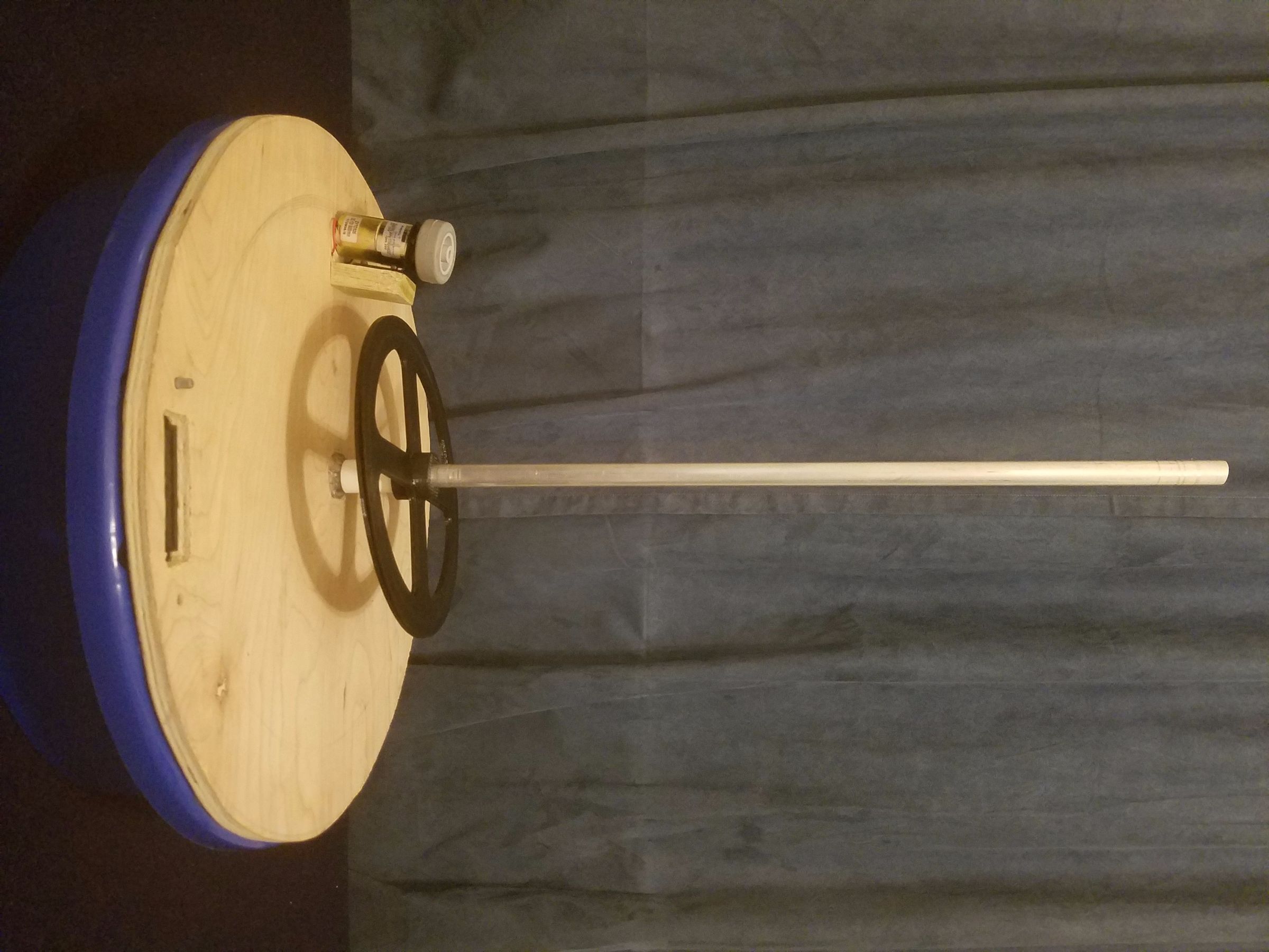

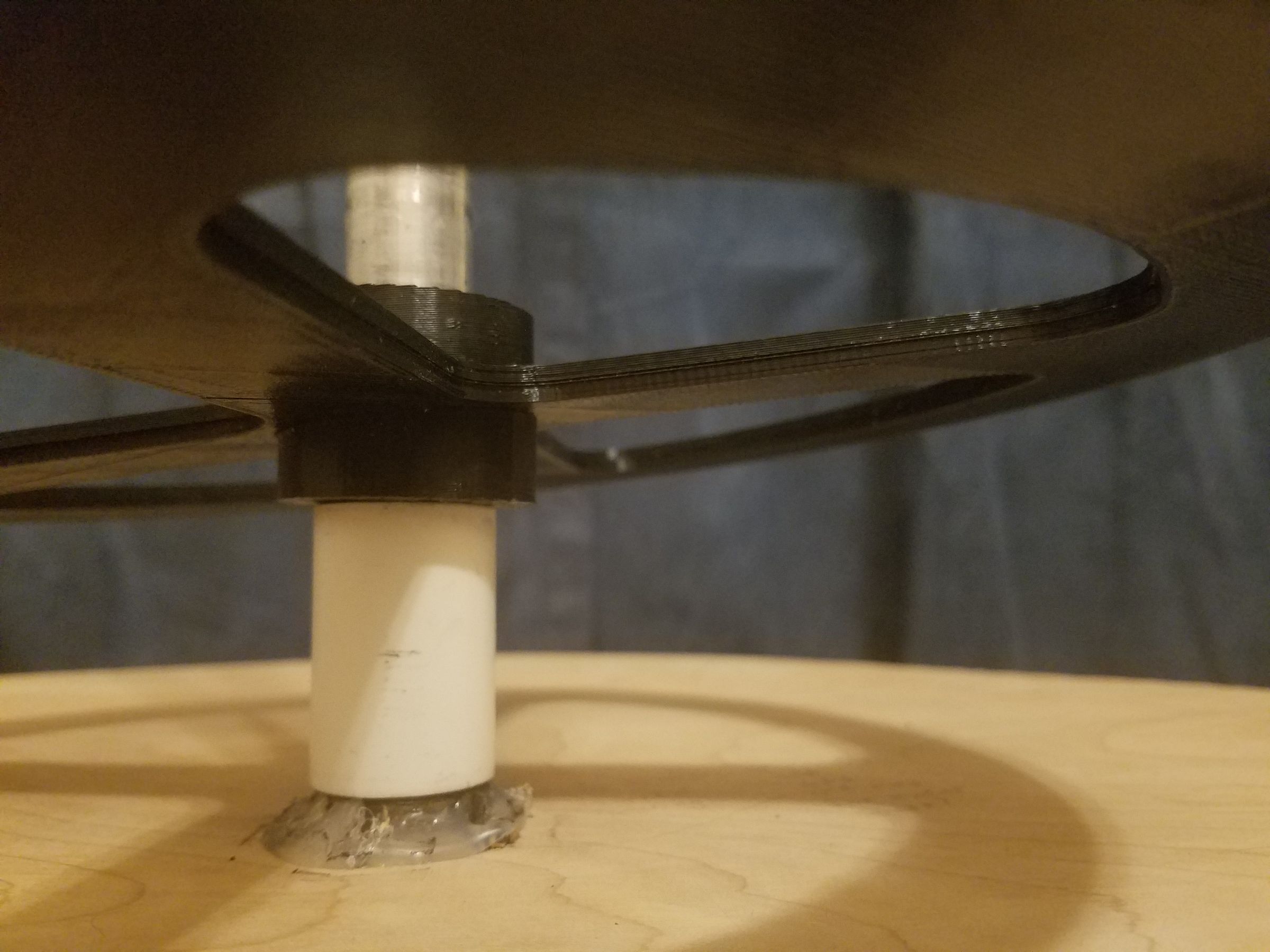

This shows the swash plate rotary bar connected to the bearing (w/ coupler) and a PVC stabilizer added for extra support.

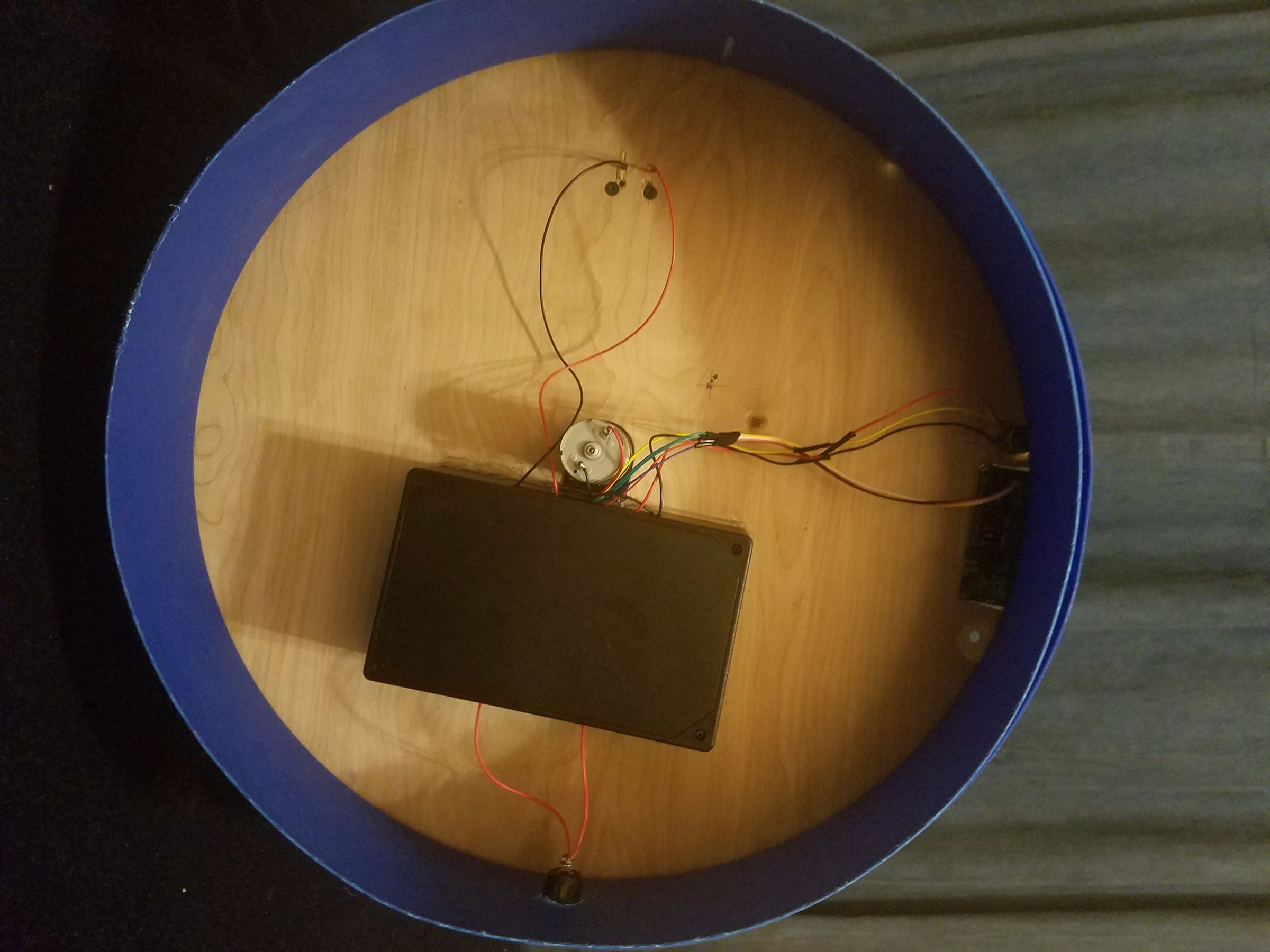

This is under the mounting board, showing the control box.
