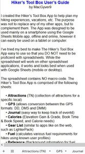

I created the Hiker’s Tool Box App to help plan my hiking experiences, vacations, etc. The purpose was not to replace any of my other apps, but to complement them. The App was designed to be used mainly on a smartphone using the Google Sheets Mobile app, offline and online, however it can easily be used on a tablet or computer.
I’ve tried my best to make The Hiker’s Tool Box App easy to use so that you DONOT need to be proficient with spreadsheets. While the spreadsheet will work on other spreadsheet applications, it works and looks best when used with Google Sheets (mobile or desktop). Screenshots from my phone & desktop are shown throughout this Instructable.

The spreadsheet contains NO macro code. The Hiker’s Tool Box App is comprised of the following sheets:
  • Attractions (TN) (collection of attractions for a location-Smoky Mtn National Park included)
  • GPS (allows conversion between three GPS formats: DD, DMS and DMM)
  • Journal (simple journal to keep notes of events, sites, hikes, etc)
  • Calories (elevation gain & grade, book time & book speed, and calorie needs)
  • Gear List (similar to apps on the web, such as LighterPack)
  • Fuel (calculates various fuel requirements for hikes using known user profiles)
  • Reference (“10 essentials” for hiking, fuel, temperature, weight, etc)
  • Hiker Terms (common hiker terms from "Backpackers")
  • Land Nav (land navigation-compass and map article by REI)
  • Manual (included as part of the spreadsheet for quick reference)

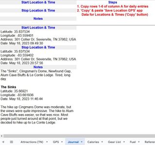

Journal
This sheet is setup to be used as a simple journal to keep track of events, whether on the trail or off. The page sizes of the journal were setup for a smartphone. The top few rows are locked so that they will stay visible as you scroll threw the journal notes. For each day, I copy the locked rows and paste into the next available entry in the journal and then make my notes.
Tip 1: I typically use the standalone app 'Save Location GPS' to make quick location & time stamping easy. I simply use the 'Copy' button to capture the lat/long coordinates, date, and time with just a button press. I then 'paste' the info into the journal - - very simple and quick! I’ve included a section of Journaling Tips for new Google Sheets Mobile users in the Manual sheet (described later).
Tip 2: When entering notes while on a hike, I simply enter short notes directly into the journal as normal. Later, when I have more time back at the “home base”, I’ll use a folding Bluetooth keyboard (Joyzy) to add longer notes.
