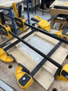

Once you have all your slats cut, arrange them in order with the outward side facing down and clamp them tight together so there are no gaps between them. Then cover the backs of all the pieces in wood glue, I used Titebond 3. After applying wood glue, get a square of canvas a little longer than the door longways, and a little shorter than the door's full height. Apply this canvas in the middle of the wood on top of the wood glue and smooth it down like the pictures above, taking care to avoid the top and bottom of the wood, as these need minimim resistance to slide smoothly in their tracks. Leave a weight on top to ensure the canvas is really pressed in as the glue dries.
If we let the wood glue sit until it fully dries, then there’s a strong chance the door slats will fuse together. To avoid this, after about an hour of drying, slowly start lifting up the door and separating each of the door slats from one another, taking care to ensure the canvas is still attached. Once each of the door slats is separated, you can set the door back down to finish drying.
Once your door is dried you need to make the short portions for the top and bottom. Depending on your slat size and width the process for this can vary, but I had a slat width and height of ¼ inches so I used a table router to cut off excess material around the top and bottom to make my slats. Until I had a short square 1/2 an inch long, 1/4 of an inch high and 1/4 of an inch thick on each end. This piece then slid nicely into the track I previously routed out.

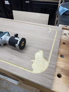

Because this project uses a tambour door, the base and top will need tracks, and these tracks will need to be mirrors of each other when the top and bottom faces meet inside the cabinet. To make a consistent track on both without a CNC I used a rigid MDF jig and hand router with a .25 inch routing bit. To make my jig, I drafted a .svg file (see below) and laser cut it out of ¼ inch MDF so I could run the router along the edge. To ensure the jig was flush against my 2’ x 4’ plywood sheet, I cut two flat pieces and nailed them perpendicular to the end of the jig.
Taking care to hold the router with steady hands, I clamped down the jig and slowly, pressing the router against the firm jig, ran the router along the edge of the material. I then flipped the jig over, as the top and bottom are inverted, and cut the reverse pattern in my other plywood sheet.
When routing out the top and bottom, it’s important to start with the interior features before adding curves to the exterior, as the corners of the square piece make it a lot easier to orient cutting jigs and ensure your patterns are consistent.

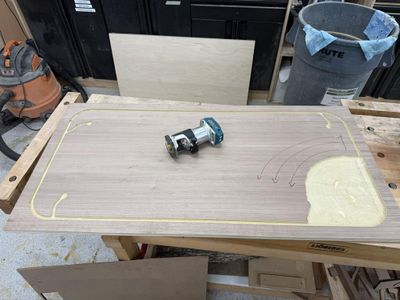

For the top of this cabinet, I wanted to make a unique pattern within the plywood so I planned to remove ¼ inch of material on the inside. To avoid making a 2’ x 4’ jig, I drafted a small corner jig so I could trace the path of the four curved corners of the piece. The tracing process for this is the exact same as the step above.
After tracing the bottom corners, I placed the router with the .25 inch cutting bit in the straight portion of a corner track. I used this as a reference to align and clamp a straight piece of scrap wood between two curves and run the router along it to connect the two. I repeated this for the remaining three joints and got the outer edge of my cut area.
After drafting the outer edge, I grabbed the largest routing bit I had and used a plunge router to drop it .25 inches into the middle of the material around each corner. It’s important to note, if your router does not ride on enough support material from the original top of the sheet then it will either drop down or angle itself and your bit will cut deeper than you want.
To keep the top of my router consistent, I started at one point, and moving in slow circles, I worked my way out and across the sheet. Pressing half of the hand router against remaining material or the outside wall, I touched the cutting blade to the edge of the material I wanted to remove and made shallow passes along it instead of forcing the blade deep.
While this took more passes, it gave me more control over the router. I would also recommend doing this cutting operation in stages to avoid putting unnecessary strain on your hand router / big from running for too long.

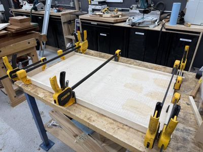

To make the tambour door I started with another 2’ x 4’ slab of .75 inch thick plywood. For this slab I found the prettier side and designated it as “up”. I made all of my cuts on the opposing "down" side to keep the "up" side as clean as possible.
Like the interior walls, the tambour door isn’t exactly 24 inches tall, but loses about 1 inch from the remaining thickness of the top and bottom slabs, so I started by cutting this plywood sheet to 23” x 48”. I highly recommend measuring your top and bottom with calipers to ensure that you are cutting your plywood for this stage to the correct size, as too loose or too tight doors don’t sit well in the design and are much harder to change than simple interior walls
After cutting the plywood slab to the correct dimensions, I used a track saw to cut it into .25 x 23 inch straight pieces, labeling each piece a number and the same orientation for ease of assembly later. After cutting the .25 inch boards I sanded the burrs off of each piece to ensure a smooth fit and checked the complete “up” side for any serious errors.
After checking the “up” side, I arranged the pieces in order, “down,” or numbered, side facing up, and clamped them tight together using clamps and scrap wood. I then measured the range of the pieces and cut a piece of canvas to size. I cut the canvas a few inches longer than the whole assembly, and made it a few inches shorter in height. I then applied wood glue with a brush to the back of the pieces until there was an even coating along them. Ensure that you have an even coating of wood glue as this is an important joint in the long term health of the table. After applying wood glue I added the canvas along the middle of the piece and weighted it down to dry for an hour.
Most importantly, if the wood glue dries fully, then it will likely stick individual boards in the door together, so after the glue cures for about an hour, remove the weight and carefully flip the door until it lies canvas side down. From here, you can slowly roll it off the edge of a table, the canvas should hold firm, but the pieces should be easy to separate from one another. After separating each piece along the whole door, return the door to its position canvas side up and weigh back down until the glue fully cures.
After processing the door I needed to make the lips on the top and bottom to slide along the tracks. To do this I used a table router, but any saw or hand router should do as the cut is a simple square. Using calipers, I measured out how deep of a cut would leave .25 inch at the bottom of each board and cut out a square .25 inches into the board and about .5 inches deep from the “up”, or pretty, side of the board. I repeated this on the top and bottom of the boards and they were good to go.
