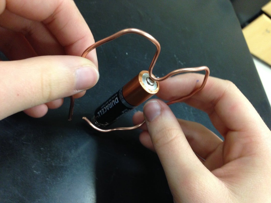

Step 2: Bend Your Wire
Bend into a heart shape, with one side slightly curved (and slightly longer than the other)
Keep in mind only one side has to touch, but one side HAS to touch or it won't work. That's why you will bend one side, so it touches the magnets.
Step 3: Put Together Motor
- Place magnets on flat side of magnet (minus side)
- Balance the indented point of heart on the bump of the positive side
- Make sure the longer side of the copper wire is bent at the end so it will hug the magnets
- THE OTHER SIDE SHOULD NOT TOUCH
Step 4: This Is What It Should Look Like...
This is what it should look like...
