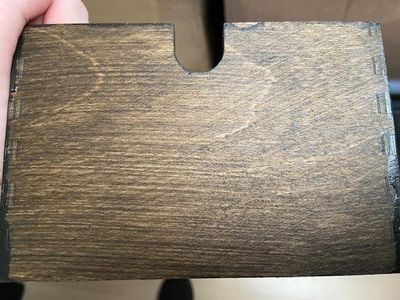

I ordered 11 Moppe sets of drawers from IKEA, plus the one I already had at home, which made 12 units altogether. I was also very lucky as when I went to buy the Moppe drawers they where on sale. To give the drawers an antique look I used an electric sander to remove all the sharp corners on the drawers. I bought a 750ml tin of Dulux Woodsheen for interior and exterior surfaces. This stain also had a varnish included. I highly recommend using a paint that has a stain and varnish in one as it saves you having to paint the drawers twice saving time and money. I painted all the drawers and the Moppe box itself. To save on paint I only stained the shelves that the drawers rested on and about 5-10cms around the outside of the unit. The set of drawers will eventually be encased in plywood so the sides of the Moppe will not be seen.

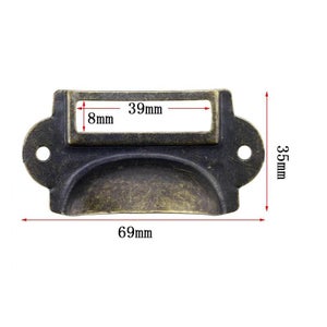

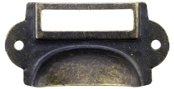

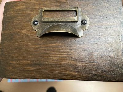

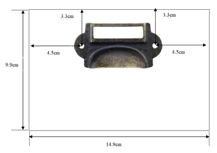

The drawers had a hole on one end that acted as a handle. I flipped the drawer ends round as I wanted to use archive handles. To ensure that all the handles would be uniformly placed I created a plastic template from acetate and using a gouge poked pilot holes into the drawers. I used an electric drill (to speed the process up) and Black screws M2 x 3mm to attach the archive handles. I chose these handles as they had a label holder so I could write what was in each drawer once it was being used to store all my paraphernalia.

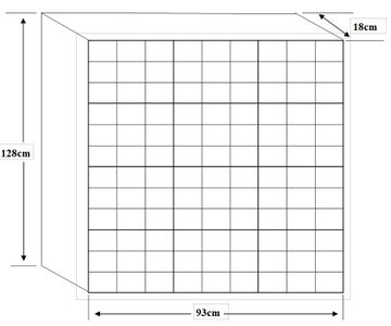

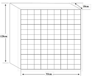

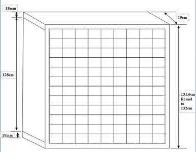

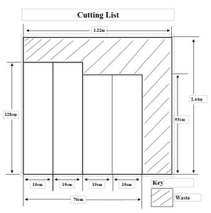

I had a sheet of 18mm thick plywood cut at a local DIY store into the following dimensions:
2 - 128 cm x 19 cm
2 - 93 cm x 19 cm

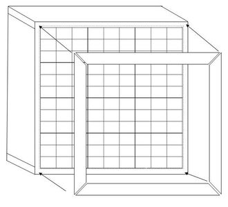

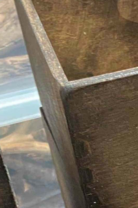

Unfortunately there was a lot of wood left over from the cutting sheet but this couldn't be helped as I had to go by the sizes available to me from the DIY store. I didn’t mind to much as I will probably use the spare wood for another project. I screwed the Moppe units into the plywood top, sides and bottom using 8mm screws. I used 10mm screws to attach the top and bottom to the plywood sides. For the top section of the plywood I countersunk the screws and filled them with wood filler. I didn't do this for the bottom piece as it will not be seen. I used a strip of walnut edging along the plywood so that the rough edge would be hidden.
Step 7: Adding Beading to the Catalogue
Once the plywood was attached I cut strips of rounded beading cut it at 45 degree angles and using panel pins hammered the wood in place.

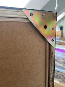

I purchased some Flat Corner Triangular Brackets to screw in on each corner of the unit. This saved my having to buy hardboard for the back and reinforced the units joints.
