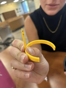

  5. For this item, we will create an object that perfectly fits the rounded edge of the hydroflask top in order to get any gunk out!

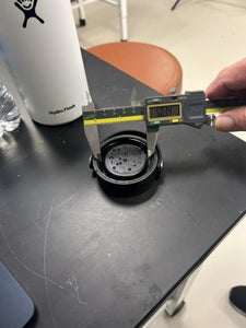

  1. Create a rough sketch of your design on paper or use a digital tool. Include dimensions to fit the Hydro Flask’s opening (typically around 2.5 inches in diameter).
  2. Think about the length of the handle—around 3-5 inches is usually adequate.

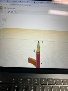

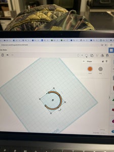

1.3 Use CAD Software:

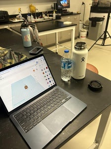

  1. Choose a CAD (Computer-Aided Design) software to create a 3D model. Popular options include TinkerCAD (user-friendly for beginners), Fusion 360, or SketchUp. I used TinkerCAD to be able to build my image within the computer software. It is easy to use as a first time 3D printer and lets you customize the length, width, and radius to the size of the hydro flask top! (making it so that this item can be used on ALL sizes of hydro flasks!)
  2. Start modeling the handle and the cleaning head. Ensure that the rounded edge is wide enough to effectively clean but narrow enough to fit inside the bottle opening. Also, consider how this item can be multifaceted to clean different faces of the bottle top. By making the handle of the cleaner have a pointed end, you can use that end to clean the smaller crevice in the straw area.

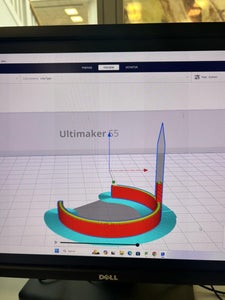

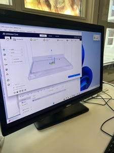

2.3 Slice the Model:
  1. Open your sliced model in slicing software (like Cura, PrusaSlicer, or Simplify3D). I used Cura when creating this object.
  2. Configure the settings:
  3. Layer height (0.1mm for finer details, 0.2mm for quicker prints).
  4. Infill density (20-30% is usually sufficient for a cleaning tool).
  5. Supports if necessary, depending on your design.

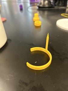

  1. Remove any support structures carefully and sand down rough edges with fine-grit sandpaper for a smooth finish. This is especially important if you’re using the tool in contact with your Hydro Flask.
5.2 Test the Tool:
  1. Before cleaning your Hydro Flask, test the tool in a safe environment. Dip it in warm, soapy water and scrub to ensure its effectiveness and comfort.
5.3 Use the Cleaning Tool:

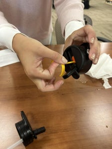

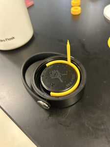

  1. When ready, use the tool to clean the inside rim and top of your Hydro Flask. The handle should allow for easy maneuvering, and the head should effectively scrub away any residue.

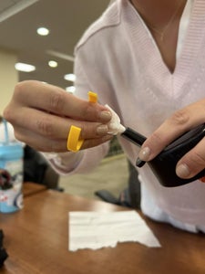

  2. The best way to use the device is to put a paper towel around the circular part of the 3D printed object (the head) and use the handle to twist the object around the slim part of the top. This will allow the paper towel to collect any residue. Also, the skinnier pointier part of the object can be used to dig out any stubborn or hidden residue!

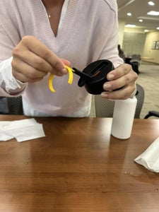

Creating a 3D printed cleaning tool for your Hydro Flask is a fun and practical project that can enhance your bottle maintenance routine. By following these steps, you’ll not only have a custom tool tailored to your needs but also gain valuable experience in 3D modeling and printing. Not only is it easy to use but it will save you from all of that nasty gunk that builds up in your water bottle tops (check out picture #4 - ew!) Enjoy your clean Hydro Flask!
