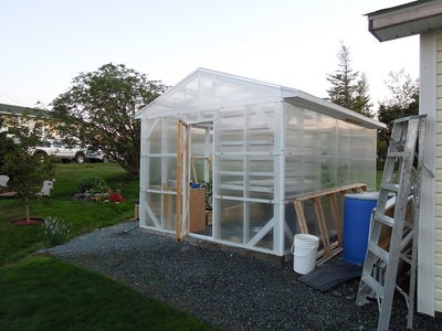

Step 9: Adding the Glazing
The final step to completing the construction phase of the greenhouse would be to add the glazing. The glazing material in question is 8mm twin wall polycarbonate panels. A really good feature of these panels is that they have a bunch of cells that each have a small air space and provide a good degree of thermal insulation. I'm going to try to take advantage of this insulation to stretch the growing season as long as possible and maybe even all year. The panels are strong too. The manufacturer braggs that the panels are something like 25 times stronger than glass and 5 times stronger than acrylic and built to withstand golf ball sized hailstones.
Unfortunately I couldn't install the panels this season because of the nasty weather. As soon as I was done painting the greenhouse I had the concrete slab for the garage poured so I had to concentrate on building that. Constant wind and rainstorms diring the construction of the garage set my schedule back so far that by the time I was finished it was too cold out to use the caulking necessary to install the panels.
