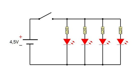

To create something similar you will only need a few parts,
  • some acrylic glass
  • a 4,5V power supply
  • 4 red LED's
  • 4 120Ohm resistors
  • some wire
  • shrink tubing
  • a can of spray paint
  • some tape

  6. Solder the components together
