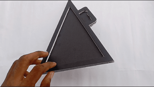

The way this puzzle works is that I have taken a big area of a rectangular space, and chopped it into tiny other shapes which are almost unnoticeably distributed around and in between the pieces of the puzzle.
Thus, the challenge is to insert the big yellow rectangular piece into the seemingly filled-up puzzle board. It involves finding a way of rearranging the puzzle pieces such that all the tiny areas/spaces are gathered back together to form one big rectangular space for our additional rectangular piece to fit in. It leans towards maths a lot but we wouldn't disturb ourselves with the maths.

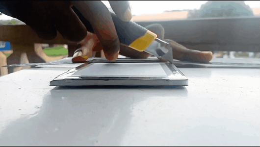

Tip: Use a sharp blade.
Using an exacto knife:
1) Use a ruler as a guide when cutting straight lines.
2) Don't apply too much pressure, Just gently pass the blade (at an angle that leans towards the board) about three to four times to get a clean cut.

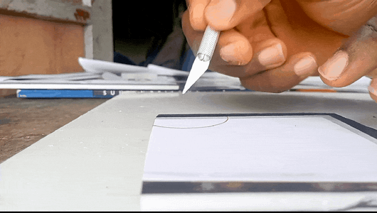

Using a hobby knife:
1) Preferably, I use the hobby knife when cutting a curve or tight corners.
2) First puncture the board with the hobby knife, not entirely through its thickness and cut along in an up-and-down sawing motion. Pass the hobby knife again now through the entire thickness of the board to completely cut the piece.

NOTE: Use an exacto knife or box cutter with a sharp blade, preferably a new blade, as cutting foam boards can get quickly ugly (jagged edges) when not done right especially with a bad blade.
Now begin cutting each of the puzzle pieces.

To begin with, cut out the inner triangle using your exacto knife and ruler guide. Remove the cut portion.
Cut out the inner somewhat 'P' shape to provide a space for the extra rectangular piece to stay within the frame. Use the exacto knife along the straight sides and use the hobby knife to cut the corners, the curves of which make it easier to pick the extra piece with your fingers. Remove the cut portion and you should have your frame just as in picture 5. This is the final piece.

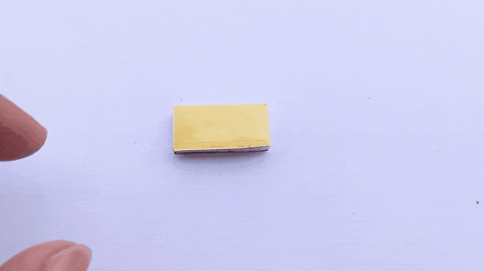

Step 6: Cutting the Extra Rectangular Piece
Cut a rectangle with dimensions 3cm by 1.5cm from the foam board. Cut two rectangular pieces of the same size from coloured paper (I'm using a yellow one) and fasten them on both sides of the piece with a sellotape. wrap the sides of the piece with sellotape too. As this piece would be the last piece to fit in the puzzle board and the first to be removed when rearranging, guiding it with sellotape gives it better durability for repeated handling.

Take the extra rectangular piece (yellow) and place it in the side extension while you fit in the other black pieces of the puzzle according to the pictures above.
The big triangles go in first, followed by the small triangles in the opposite corners and then a pair of the "L" piece forming a rectangle to the left side and another pair to the right side.
TRY SOLVING IT: Try to rearrange the black pieces to create a space large enough for the yellow piece to comfortably fit in.
Step 8: Solution to the Puzzle
Divide the puzzle into two symmetrical parts across the midline, take out the 'L' pieces from both sides and switch the places of the two triangles on both sides i.e the small triangles move up while the big triangles move to the bottom corners, rearrange each pair of the two "L" shaped pieces on both sides as shown in picture 5 to 7 and fit them into the puzzle board and now we have a big rectangular space for the yellow piece to fit in.
