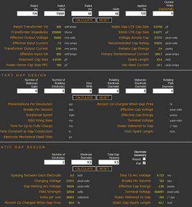

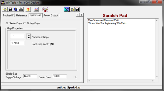

WinTesla is on classictesla.com. It was hard to find, and is quite old. But it can do a lot. If you search for it, make sure to include "-Nokia" in your search, as there is a program for unlocking (perhaps stolen) Nokia phones under the same name, and you don't want that.
I also suggest that you read up on Tesla coils on Wikipedia, and check out this place: http://www.tezla.com/tesla/coilers.htm
It is full of links that I have yet to explore, I had too much information on Tesla Coils to warrant looking at them all.

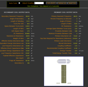

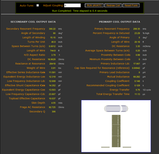

In the end, you need to make some decisions, and stick with them. Like secondary diameter, primary diameter, and a couple others. There is no "magic program" in which you simply click a button and it feeds you dimensions and specs. The whole point of all the calculators and equations out there is to solve for one variable when given another.
The last three images are from JAVA TC. After finding your dimensions, use it to "test" and tune you coil before you even buy the parts to build it. I found it to be inaccurate, and had to add 10' more onto my primary coil. The program freezes a lot, on account of being a java application in a web browser crunching huge numbers, but you just have to deal with it, as I know of no other such program. It even draws your coil to scale! That way you can tell if all those number dimensions will look funny when translated into reality.

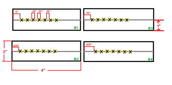

First, I made a 6"x6" square out of 1" thick particle board, with a hole in the middle for accepting 4" id PVC. It would be best to cut about an inch off of the corners, as the coil won't fit with full sized corners.
I then made four 2"x7" pieces of plywood. I then marked them 1, 2, 3, and 4. On all four pieces, I made a line across them (longways) 1" from the bottom. On piece 1, I made a mark 0.5" from the end, intersecting the horizontal line. I proceeded to make another mark 0.75" from the end, 1" from the end, 1.25" from the end, and so on, making a mark every 0.25" along the center line. Drill between the marks where an "X" is. See the pictures. On piece 2, I made a mark 0.625" (1/2" + 1/8") from the end, and then proceeded to make a mark 0.25", 0.5", 0.75", and so on from that mark. The extra 1/16" offset of the first mark is to insure that after a full rotation, the coil is .5" from where it started (making a spiral). Again, drill out the spaces marked "X". The series continues with piece 3 beginning at 0.75" and 4 beginning at 0.875". I used a 0.286" diameter drill bit. Use something slightly bigger than 1/4", as the copper coil is 1/4" inside diameter, the outside is slightly larger. Test to see if the tube fits in the holes before gluing it all together.
After completing the four plywood pieces, glue the particle board with 4" hole in the center of whatever you used for the base of the Tesla coil. Then glue the four plywood forms (with holes drilled), one centered on each side of the board, with piece #1 being at the point where you plan to have the primary windings start. See the pictures for an idea of what I'm talking about.
Now feed the copper through the closest hole to the center in the first piece of plywood. Now through the closest hole to the center in plywood piece #2, then #3, then #4. Now you're back at #1! What do you do? Feed it through the next closest hole. Continue doing this until you've made 10 complete turns (10 holes filled on every plywood piece). As the tuned parameters call for 8.25 turns, go ahead and put it through the tenth holes just to put the extra somewhere. I drilled holes in the plywood base at the beginning, and one at the end (which should be about 1" before the seventh hole on piece #1). Some thick wire I have will be ran through these holes during the wiring process.
I found it easiest to feed in copper from one end, and pull as many of the windings as possible from the other. Simply feeding or pulling one direction only is quite difficult, and will probably break the plywood pieces/braces. Push and pull to make it easier.
