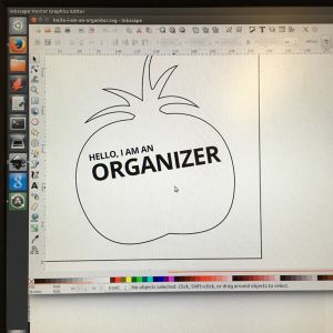

The logo for the festival has four fruit & vegetable shapes as part of it, so for the shape of the nametag, we’ll use the tomato from the logo. Hopefully the shape will stick out and subtly communicate a connection with the event’s branding and give some kind of legitimacy to the person wearing it. Yeah, I have high hopes for this name tag. It’s a symbol of power.
Why the tomato? Out of the four vegetables in the logo, the tomato has the largest internal area. This provides a little more room to squeeze in text. The font is Open Sans, which is easy to read from far away and it matches the font used in the other design for the event. Here’s is the design that I drew in Inkscape.
The plan is to laser cut the shape, then cut out the text separately as a vinyl sticker, place the text on the shape, and then have an organizer write their name on the name-tag with a marker.

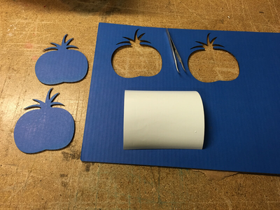

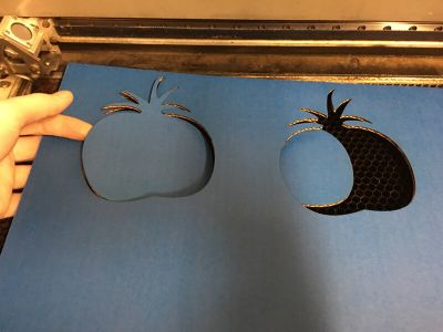

Step 2: Laser-Cut the Shape
There are two ways that you can use a laser cutter: etching or cutting material. For this design we are only cutting and not doing any etching. Cutting on a laser uses vectors images, etching can be bitmap images. It’s not so important to know the difference for the sake of this project, but the key part is that the design needs to be in the format of a vector image. Here is the SVG vector image for the design.

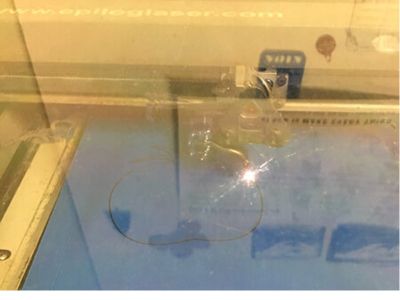

Configuring the laser: The Epilog laser that I’m using is connected to a computer that uses Corel Draw and the Epilog print driver, so I imported my SVG file to Corel Draw. For the Epilog print driver to know which lines are intended to be cuts, you need to set the stroke width on your cut lines to “hairline”. Select the shape in the design and in the stroke toolbar, set the width to “hairline”. To keep it simple, I just deleted the text from the design since we’ll making that separately on the vinyl machine.
The strength of the laser is set by three variables: power, speed and frequency. These are settings that I used to cut the cardboard:
*Power: 25%
*Speed: 75%
*Frequency: 500Hz
Now it’s time to print and run the laser.

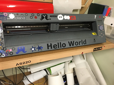

Step 3: Cut the Text With the Vinyl Cutter
Just like the laser, the vinyl cutter needs a vector graphic. I removed the tomato shape from the design, leaving just the text. It’s important that you convert the text to a path and not leave it as text or the vinyl cutter may not recognize the text as a shape to cut. I scaled the text to be a about 4” wide so it would fit on the 5.5” tomato shape. Then run the vinyl cutter. The settings I used for this white vinyl sticker paper was:
*Pressure: 100gf (It’s an older blade; Usually 70gf will work fine)
*Speed: 10cm/s

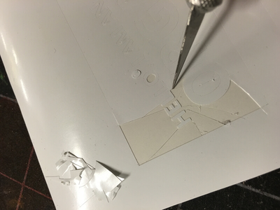

Step 4: Weed the Vinyl
The machine cuts the vinyl but you still need to remove the negative space in your design. The process of removing the unwanted pieces of vinyl is called “weeding”. You can use a few different kinds of tools for this, like a pair of tweezers or dental tools. I like to use an X-acto knife because you can also use it to add additional cuts while you’re working.
Sometimes your design will have very large pieces of vinyl that need to be removed. If those big pieces touch a lot of detail, it can be very tedious to remove them. To make it easier, you can make cuts from your design to the edge of your vinyl and then remove pieces as you work. This process is called “fencing”. You can see what I mean in the photo below.

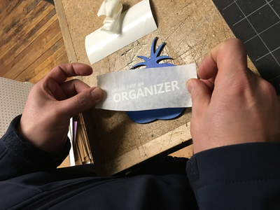

Step 5: Transfer the Vinyl to the Name Tag
After weeding the design, I used the masking tape to transfer the vinyl from the backing to the name tag. The trick to making sure the vinyl sticks to the badge is to remove the tape with a sheering motion; Instead of pulling straight up, remove the masking tape by peeling it back. If some of the vinyl does not stick, back-track a little, push it down, and try again.

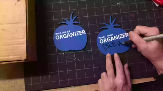

Step 7: Write Your Name on It
Almost done. This name tag needs a name.
Put It On Your Shirt.
Ok, now you’re officially an organizer.
