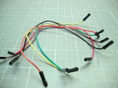

  • Jumper wires

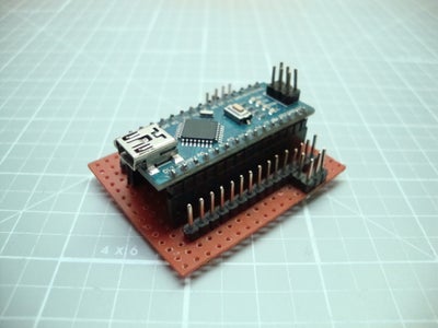

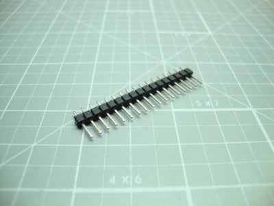

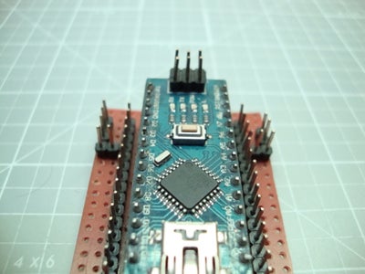

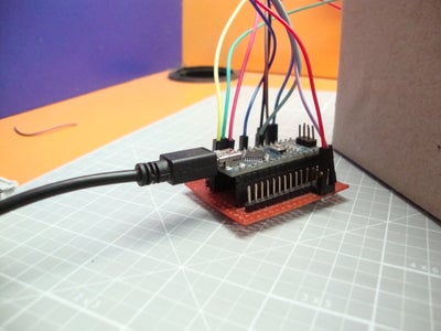

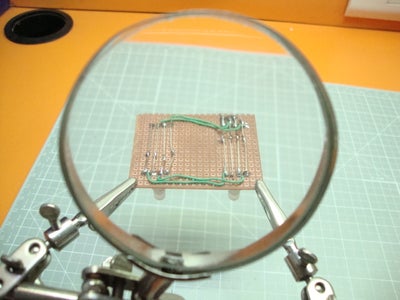

Step 2: Make a Shield for Arduino
The very first step to start this build is to make a shield for arduino. As I do for all of my projects, making such a shield will greatly help you to make all the connections easy by use of jumper cables. This also eliminates the need of soldering everything up which can sometimes be time consuming. You can just plug in and out your arduino to be used in other projects at the same time. However, this won't be mandatory for UNO users.
For making the shield, just check for the number of pins on your arduino and solder the same number of female headers on a piece of perforated board. Check if your arduino fits in easily. Now solder male headers corresponding to each pin on your arduino. Add some extra headers 5v and Gnd pins which are more frequently used.

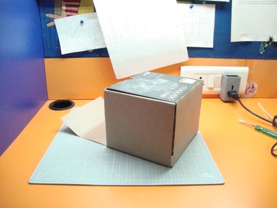

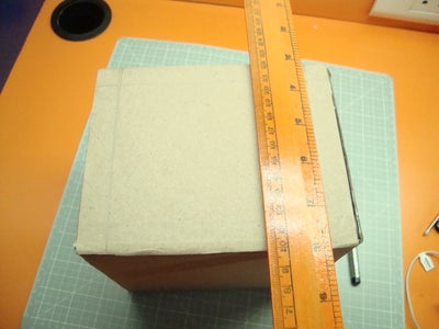

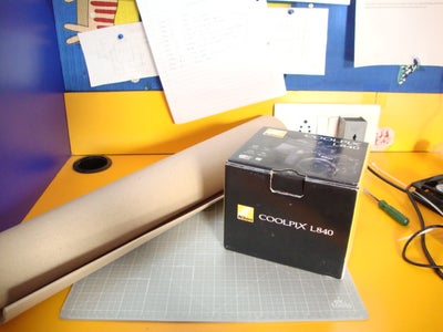

Step 3: Cover Your Box
Now moving a little away from electronics, here comes some craft work. You have to now cover your box with some colored paper. But before that, it can be sometimes difficult to find the correct box to suit your needs. If you want to make it just as a project, then the best way is to hunt for shoe boxes, courier boxes or you can even make one from some scrap cardboard. I used a camera box which was just the perfect one.
You can cover the box with any colored paper you want. For making it simple, I used plain brown paper as I don't have much experience and designing skills in art and craft. You can even add some patterns, decorations to make it look more attractive. As for mine, I simply took the measurements, cut the paper and covered all the sides of the box with it.

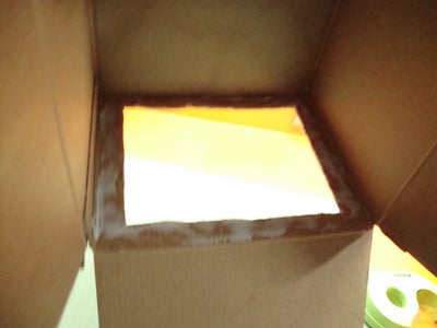

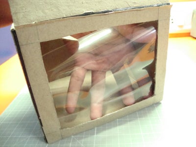

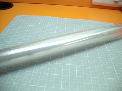

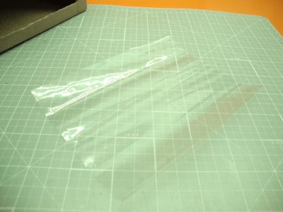

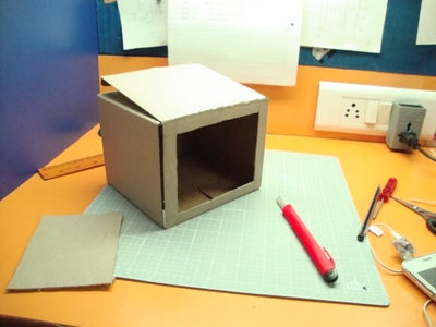

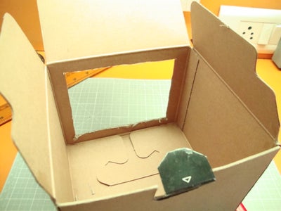

Step 4: Make the Front Side Transparent
A pretty interesting feature, this can make the box look much better and will also allow to add some LED lighting inside the box. So I chose to cut the front part and cover it with transparent sheet.
You just have leave some of the cardboard to the front side and cut the rest of it (dimensions depend on the size of your box). Cover the cut part with transparent sheet which should be tight and shouldn't sag.
Instead of that thin sheet, you can use acrylic/plexiglass or even ordinary glass to cover the front portion to make the project more permanent. I have no experience on working with glass so chose an easier option.

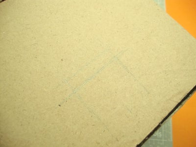

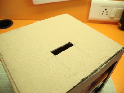

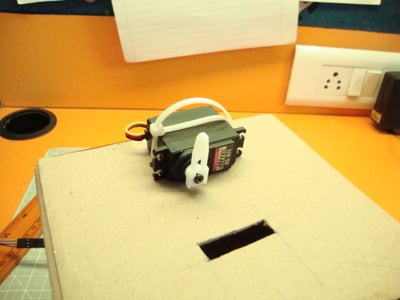

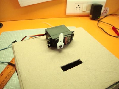

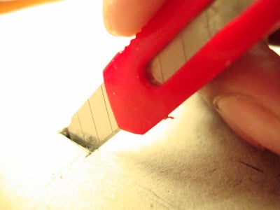

Step 5: Cut a Coin Slot
This one's very easy. You just have to cut a big coin slot for the coins to be donated inside. Simply cut out a rectangular part measuring about 1.4" x 0.3". It should be big enough for all types of coins to pass through.

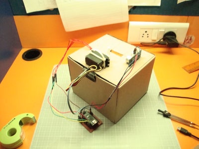

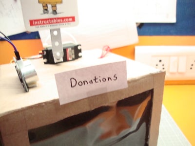

Step 6: Mount and Connect the Servo
Now again coming to the electronics part, you have to now mount and connect the servo motor. The purpose of it was to wave whenever a person donated a coin to the box. The best option is to use a standard servo but as you don't have to lift a large weight, even micro servo would work. Also, attach a proper attachment to your servo before connecting it. I used a one sided rotating shaft for the purpose. Connect it to arduino as per the following:
  1. Vcc (red) of Servo to 5v of Arduino
  2. Gnd (black) of Servo to Gnd of Arduino
  3. Signal (yellow) of Servo to Arduino digital 3 (PWM)
Finally, mount the servo at the top using zip ties or hot glue. While mounting, you must take care that the attachment connected to the servo doesn't bang with the cardboard box while moving. In other words, check the angles before mounting it.

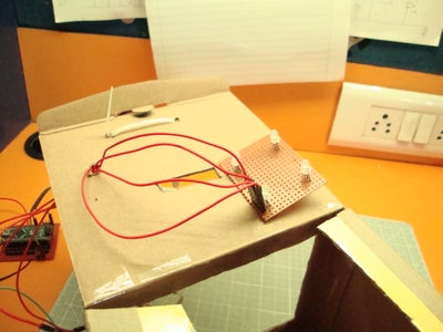

Step 7: Solder and Connect the RGB LEDs
Some RGB LEDs are added inside the cardboard box to glow permanently and flash when a coin is added. This makes the box look more cool and adds and awesome feature to it. The light, when glows becomes visible through the front, transparent part thus making the inner coins visible as well. Since one LED would be too dim, I used 4 of them.
First solder all the four LEDs to a piece of perfboard. Connect all the four terminals of each LED in parallel. Please note that the LED type used here is common cathode. Then, connect the LEDs to arduino as per the following:
  • Red pin to Arduino digital 9
  • Green pin to Arduino digital 10
  • Blue pin to Arduino digital 11
  • Cathode (gnd) to Arduino Gnd
Step 8: Connect the Ultrasonic Sensor
The most important component if this project, this ultrasonic sensor detects when a person donates a coin. Since it can detect distance, when your hand comes near the coin slot, the distances detected by the sensor becomes much less as compared to earlier when there was no obstacle in front of the sensor. For the particular project, we can say that someone donated something when the distance detected by this sensor becomes less than 4cm.
Please note that the sensor used here is NOT HC-SR04 type (the one with four pins). I have used a Ping ultrasonic sensor which has 3 pins connected instead of 4. You can also use the earlier one but only with some modifications in the code. The Ping type sensor can give you much accurate measurement at a faster reaction rate. Anyways, connect it as per the following:
  • Vcc of Sensor to Arduino 5v
  • Gnd of Sensor to Arduino Gnd
  • Signal of Sensor to Arduino Digital 6
Finally, mount the sensor at a distance of approx 2-3cm. Make sure that the sensor doesn't completely touch the base.

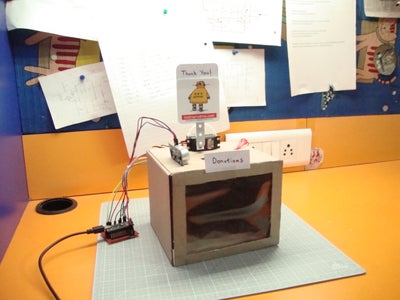

Step 10: Finishing Touches
Although not very necessary, it can be worthwhile to add some finishing touches to your project so as to give it a batter look. The only thing that must be added is a little message fixed to the servo which would wave along with the servo shaft. As for me, I used a simple 'Thank You' made using some white paper and stuck to the servo shaft.
Any other quotations, messages, boards and other modifications can be made as well. That depends upon you. Usually, adding some interesting quotes can give you more attention. I tried to keep mine as simple as possible.

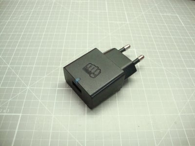

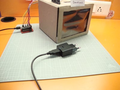

Step 11: Powering the Project
The last step is to find a good power source to power your project. The best option is to use a USB charger and connect it straightaway to your arduino with a USB cable. This would eliminate the need of using a battery and would give you a non-exhausting power supply.
There are various other options as well, like using a 9v battery or a powerbank (as in the image above) to make the project portable. For the battery, connect the positive terminal to Arduino vcc whereas negative terminal to Arduino gnd. Powerbank simply needs to be connected with a USB cable.

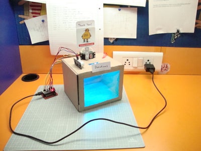

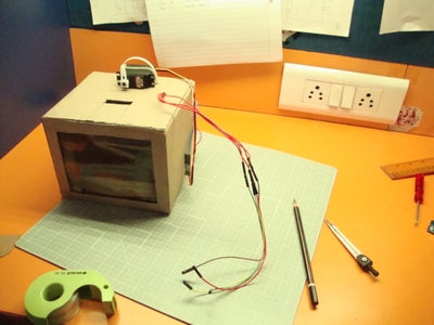

Step 12: You're Done!
That's it for this instructable. Now you're finally done making your own interactive donation box! Since this project uses an Arduino, it's completely open-source which means you can make as many modifications as you want. You can even make a bigger version of the same and install it in exhibitions, shopping complex etc. This was just a way to present the basic idea which can be very interesting and beneficial when done on a large scale.
You are free to ask any questions if you want. Don't forget to vote, like, follow, comment and share it with your friends!
