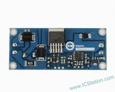

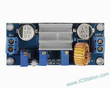

Introduction: The Introduction of 5A Constant Current and Constant Voltage LED Driver Battery Charging Module
ICStation R&D department has develop this wonderful product--5A Constant Current and Constant Voltage LED Driver Battery Charging Module($5.54+Free shipping) recently.Thanks for their great efforts! We will share their achievement with IC fans.We will introduce the function, feature, parameter, diagram,the actual functional test with and an actual application case about this module.Hope you will find the information you need!
Features:
1.Use XL4005 as main control chip.
2.Free to adjust the value of output current,voltage.
3.With threshold to remind you.
4.Small size and especially suitable for narrow space such as automobile car.
Four protections:
1.Output the counter-attack filling and protection
2.Input reverse connect protection
3.Overtemperature protection
4.Short-circuit protection
Parameter:

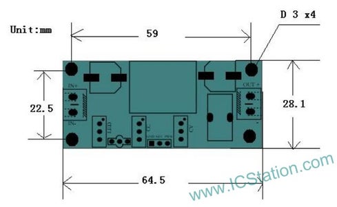

Module Size:length: 64.5mm Width:28.1mm Height:20mm
way to install:Four 3mm screw
Input voltage:4.5~30V
Output voltage:0.8~30V
Working current:0.1~5A
Working temperature: -40℃~+85℃
Working frequency:350KHZ

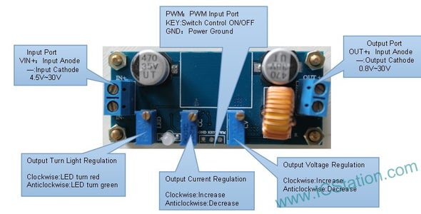

Step 2: Function Introduction

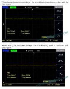

Step 3: Functional Test

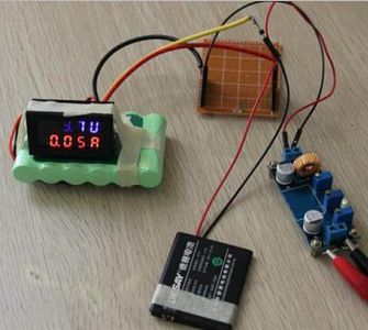

Step 4: The Actual Application Case:Use This Module to Chare for Lithium Battery.
Tools and components:
Digital Multimeter
Volt Meter Ammeter
Copper Wire
Copper Cylinder
Nut
Pin Header
Screw Driver
Power Connector
Universal Board
Dupont Cable
Lithium battery,battery pack,battery holder
Digital Multimeter
Volt Meter Ammeter
Copper Wire
Copper Cylinder
Nut
Pin Header
Screw Driver
Power Connector
Universal Board
Dupont Cable

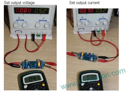

Step 5:
The specification of Lithium battery:3.7V 1060mAh
Module settings:
Input voltage:5.2V
Input Current:1A
Output voltage:4.2V
Output current:300mA
