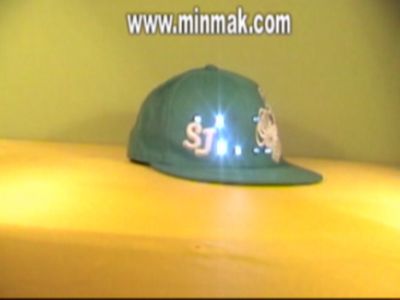

Step 5: Step 5: Secure With Tape & Power Up
Now let's secure and power up...
Like shown in (pic. 1), take all the wires and using electrical tape tie them together, this is easier than any other way to arrange the wires inside the hat.
Make sure you remember each LED's plus and minus wire if you get them wrong you may burn out some LED's or risk some of them not working. I used white wires for each + terminal and color wires for the - terminal so i won't get them wrong later.
In (pic. 2) you can see that i connected a small 9v battery to the wires and secured them on there with electrical tape. You can even add a little on/off switch, but i didn't have one at hand when i made the project...
I placed the 9v battery on the inside back of the hat, then made use of some pocket like material that was in there, to keep it from falling down.

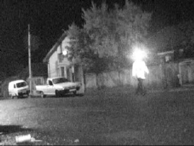

Step 6: Ready for Action !
Now your all done !
Thank you for taking the time to read and maybe (make) this project . (pic 1)
You can view a few pictures of how big brother will see you from now on ! (pic 2,3,4)
I recommend for a better understanding of the project and a preview of how well this affects video
cameras all around you please Watch the video !
