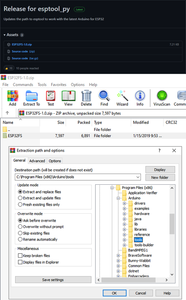

Step 5: Install ESP32 Filesystem Uploader
The primary purpose of the ESP32 Filesystem Uploader is to let you upload files into ESP's filesystem. In this tutorial, the purpose of this tool is to upload an empty SPIFFS image into ESP.
Download the "ESP32FS-1.0.zip" file here https://github.com/me-no-dev/arduino-esp32fs-plugin/releases/
And then extract the content of that archive into the "...\Arduino\Tools\" folder.
After that, restart the Arduino IDE.

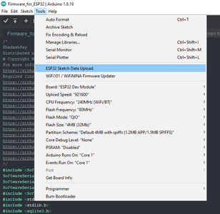

Step 6: Format ESP32'S Built-In Flash Memory
Click Tools -> ESP32 Sketch Data Upload. Then click Yes in the pop-up window. The program is going format the built-in flash memory.
Some boards will flash without any problems.
Unfortunately, that's not the case for all boards. If you configured IDE correctly, installed drivers, selected the corresponding port, and still keep getting this error: A fatal error occurred: Failed to connect to ESP32: Timed out waiting for packet header. Connect a 10µF capacitor to the board while flashing.
Connect the positive lead of the capacitor to the EN pin of the ESP32;
Connect the negative lead of the capacitor (usually indicated by the gray stripe) to the GND pin of the ESP32.
Don't forget to disconnect the capacitor after the board flashes.

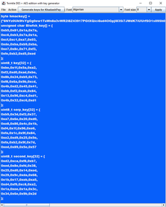

Step 7: Generate Keys
To make the unauthorized deciphering of your data computationally infeasible - It is crucial to generate your own keys and never reuse them.
The best way to generate the keys is to throw 20-sided dice.
If you get a number from 1 to 9, write it down.
If you get a number from 10 to 15, write down a letter corresponding to that number.
10 = A;
11 = B;
12 = C;
13 = D;
14 = E;
15 = F.
If you get 20, write down 0.
If you get something else, don't write anything and throw the dice again.
There's also an easier option.
I modified one of my previous projects to work as a random number generator, the generated output seems "random enough" for me, but I haven't run any tests. So, I can't guarantee that it's random.
Use it at your own risk.
To generate the keys - launch gen.exe from the "KhadashPay-main\V1.0\Untested RNG" folder, and then click the "Generate keys for KhadashPay" button. The background turns from black to blue when you press that button.

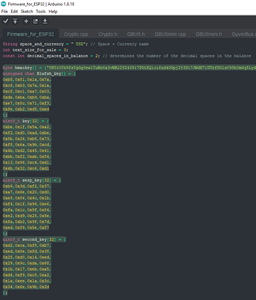

Step 8: Modify the Firmware
Open the file "Firmware_for_ESP32.ino" from the folder "KhadashPay-main\V1.0\Firmware_for_ESP32" and then replace my keys with those you've generated.
You can change the currency in the line:
String space_and_currency = " USD"; // Space + Currency name

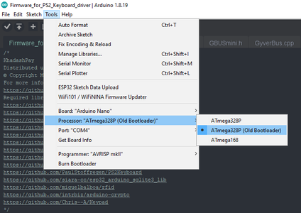

Step 10: Flash the PS/2 Keyboard Driver
Upload the firmware from the folder "KhadashPay-main\V1.0\Firmware_for_PS2_Keyboard_driver" into the Arduino Nano or any compatible board.

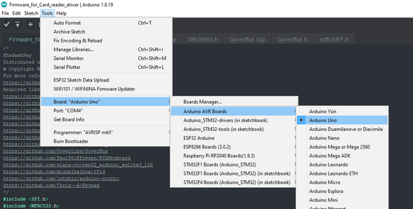

Step 11: Flash the Card Reader Driver
Upload the firmware from the folder "KhadashPay-main\V1.0\Firmware_for_Card_reader_driver" into the Arduino Uno.

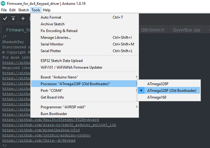

Step 12: Flash the 4x4 Keypad Driver
Upload the firmware from the folder "KhadashPay-main\V1.0\Firmware_for_4x4_Keypad_driver" into the Arduino Nano or any compatible board.
