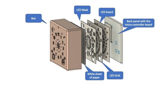

Step 1: How It Works / Comment Ça Marche
The clocks displays hours and minutes (one dot for 5 minutes) as a normal clock plus some elements depending on the current time. Each element of the front panel, including hours and minutes, is back lighted by a multi-colored LED and piloted individually by a micro-controller. The clock includes the following parts:
- the box (3D printed) with the front panel including the various elements extruded
- a sheet of white paper to be placed inside the box: it will nicely diffuse the light from the LEDs
- the LED mask (3D printed): this is a thin plastic plate with small extruded openings corresponding to the displayed elements. It is used to make sure that each element is isolated from the others and can be back lighted individually
- the LED grid (3D printed): this is a 2nd thin plastic plate with small extruded opening corresponding to each LED. The combination of the LED grid and the LED mask guarantee a light funnel from a LED to its corresponding element
- the LED board (PCB2) containing all the LEDs connected to each other
- the micro-controller board (PCB1) fixed to
- the back panel (3D printed) that will also support a potentiometer to correct the brightness and 2 push buttons to set time
- a Light Dependent Resistor (LDR) connected to the PCB1 and placed through the front panel. It will measure the ambient light and adapt the LED brightness accordingly
- an external 5V power supply
I recommend to follow the steps of this tutorial, especially the printing of the box before building the LED board, since the printed parts will help you to align the LEDs with the LED grid.

Fix the microprocessor board (PCB1) to the back panel with 4 M2 self-tapping screws. Fix the potentiometer and the 2 buttons. Insert the USB plug of the power supply into the Arduino Nano. Make a knot with the power supply cable and insert the cable into the hole on the bottom of the back panel.
Insert carefully the LDR into its hole in the top middle of the box, add some glue in the back to maintain it. You may have to wait a bit until the glue is dry or put some adhesive while you complete the mounting.
Put the box in front of you, face down. Insert delicately the white sheet of paper, the LED mask, the LED grid and the LED board. Make sure everything is well aligned and fix all of them with the panel fixes (3D printed). You can add some double face adhesive foam to protect the cables.
At this stage, it is recommended to test the system by pluging the the power supply in the wall socket and check that the right time is displayed. Turn the potentiometer and check LED brightness. Change the current luminosity (cover the LDR with your hand) and check LED brightness is changing.
If it is ok, remove the plug and put the back panel in place with 4 M2 self-tapping screws.
Congratulations, you have made it !
Fixer la carte microprocesseur (PCB1) sur le panneau arrière à l'aide de 4 vis M2 auto-perceuses. Fixer le potentiomètre et les 2 boutons poussoir. Insérer la prise mini USB de l'alimentation dans l'Arduino Nano. Faites un noeud avec le câble avant de l'insérer dans le passage prévu dans la partie basse du panneau arrière.
Insérer délicatement la LDR dans le trou situé dans la partie supérieure, en haut du coffret, et ajouter un peu de colle forte pour la maintenir en place. Vous pouvez placer temporairement un morceau d'adhésif pour la protéger lors de la suite de l'assemblage si vous ne voulez pas attendre le séchage complet de la colle.
Placer le coffret devant vous, face sur la table. Insérer délicatement la feuille de papier, le masque LED, la grille LED et la carte LED (PCB1). Assurez vous que tout est correctement aligné et fixez l'ensemble avec les languettes de blocage. Vous pouvez également insérer un peu de mousse adhésive double face pour protéger les câbles.
A ce stade, il est recommandé de tester le système en branchant l'alimentation et vérifier que l'heure s'affiche correctement. Tournez le potentiomètre et vérifiez que la brillance des LEDs est modifiée. Modifiez la luminosité ambiante (par exemple en couvrant la LDR avec votre main) et vérifiez que la brillance des LEDs change. Si tout est bon, débranchez l'alimentation et vissez le panneau arrière avec 4 vis auto-perceuses.
Félicitations, vous avez terminé !
