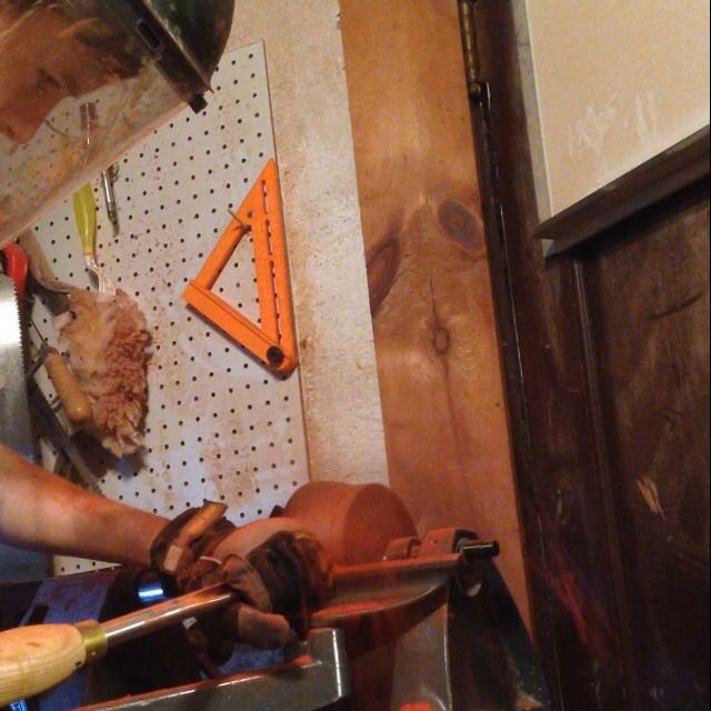

Step 3: Turn
Since there's not end grain it is very fast and very fun to turn it took me less then 30 minutes to turn and sand, I sanded to 800 grit.

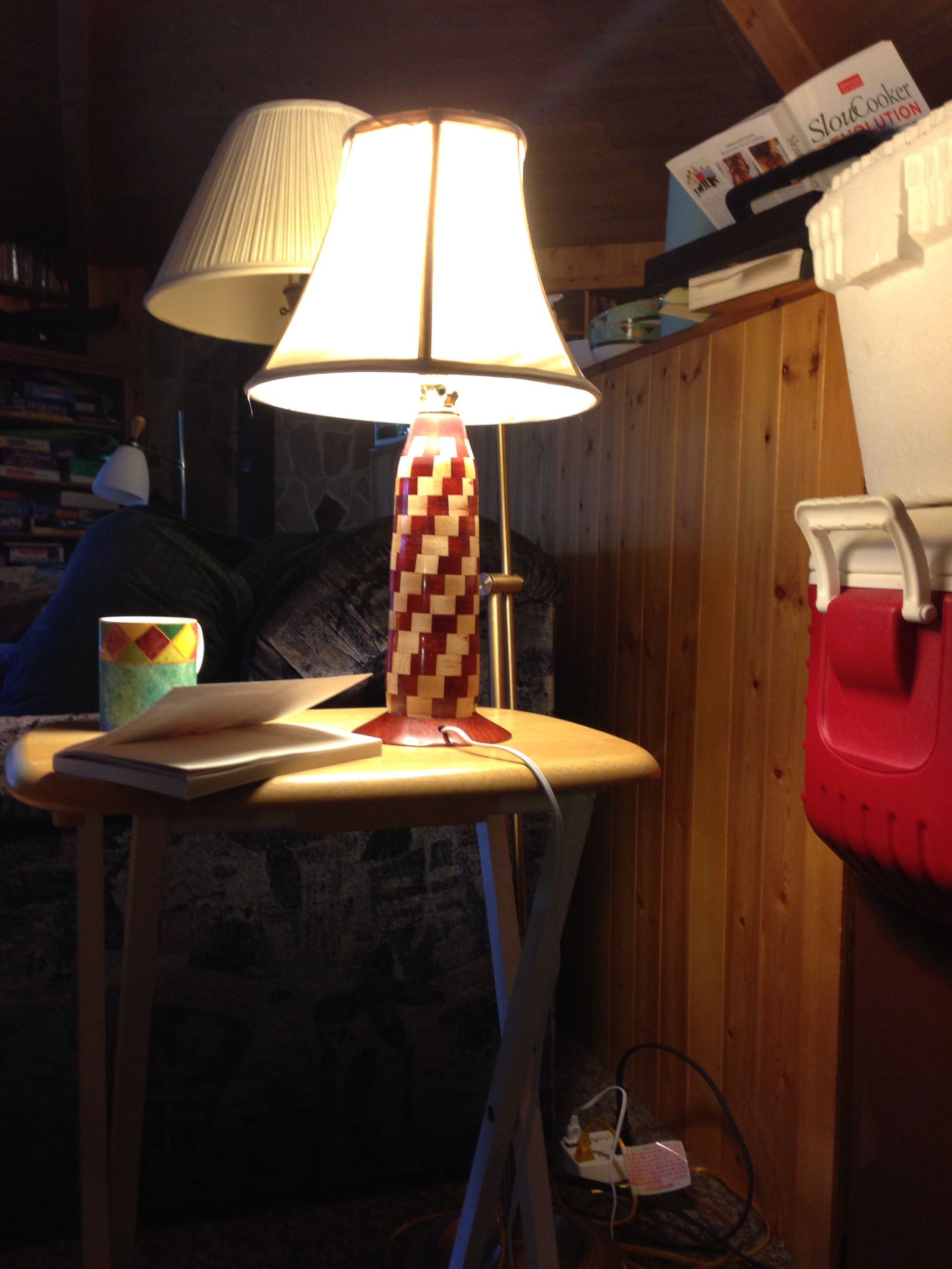

Step 5: Finish
I used poly to finish it it took lots of thin coats. I am very happy with how it turned out.
