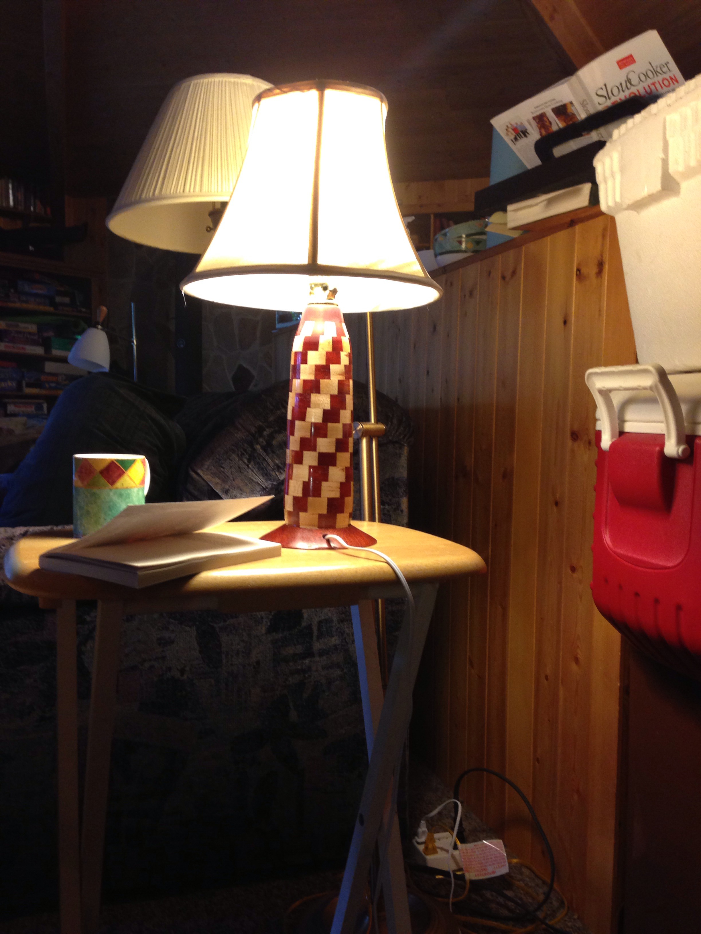

I made this lamp when I was 14 with my shop smith and a cheap chop saw. It was very fun making it and is not that hard. Please favorite, and vote comment questions! Thank you! I got almost every thing at Home Depot besides for the bloodwood.

I used blood wood and maple blood wood was bought at woodcraft. The maple is 6 by 36.
Step 2: Rings
There are 14 rings and 169 pieces each ring is the same so put a stop block on the fence with a clamp. To hold the peace use a pencil since you do not wont it trapped between the blade and the stop block.
