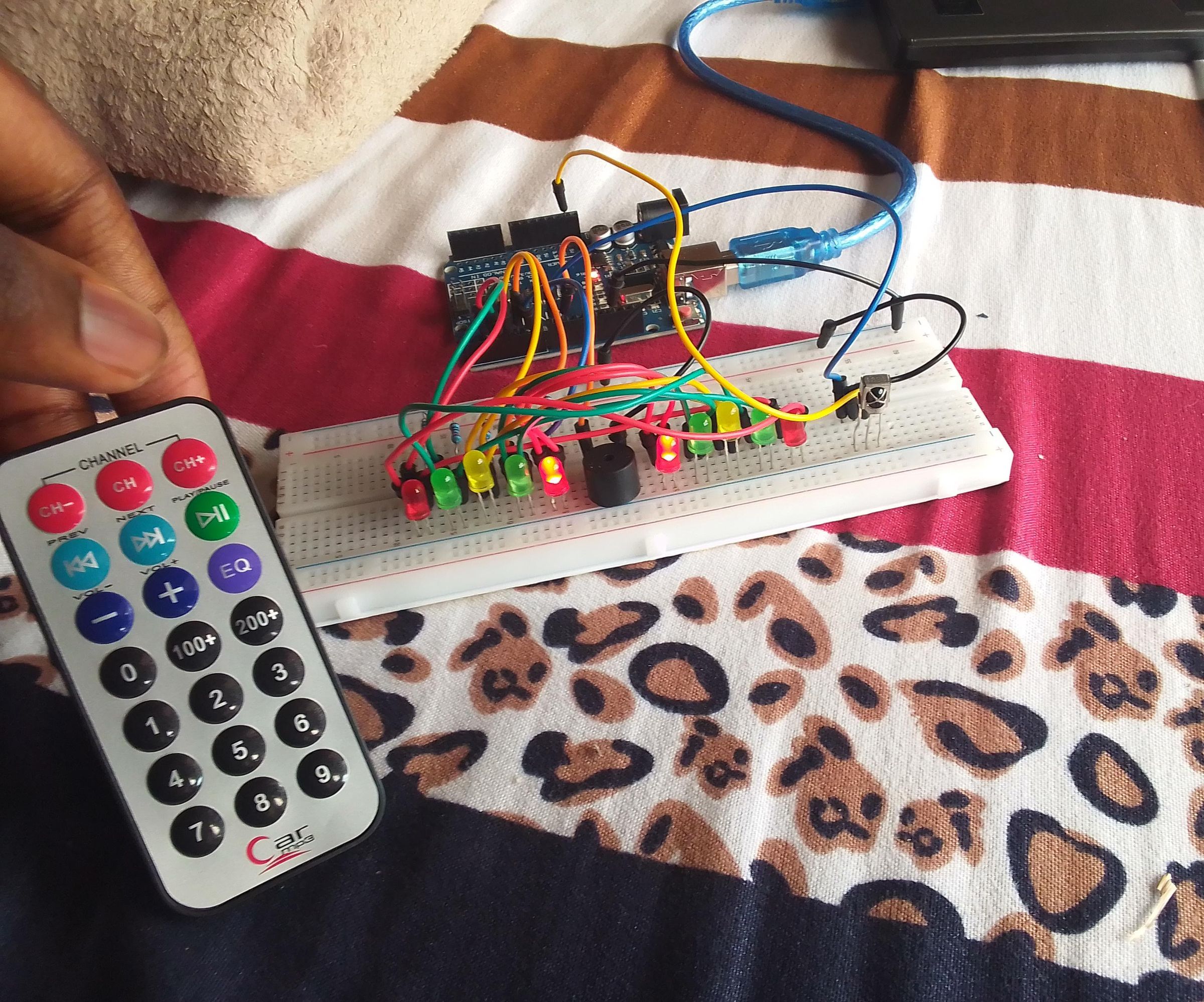

10. Test your remote by monitoring the Serial Output:
  • If you want to view the output from your Arduino, you can open the Serial Monitor.
  • We will access the Serial Monitor either by clicking on the magnifying glass icon or by going to "Tools" and selecting "Serial Monitor."
Button functions
The Serial Monitor, provides the buttons pressed, as seen in a picture some hexadecimal numbers are displayed representing that the 1, 2 and 3 buttons have been pressed earlier.
  • Button 1: The robot buzzes then the hand (servo motor) moves to a 180-degree position, indicating the initiation of the waste disposal process. The bin (stepper motor) moves forward, disposing of waste. After a set period (2 seconds), the bin is moved back to its initial position. The RGB LED changes to green, signaling the successful completion of the waste disposal. The buzzer briefly sounds again, indicating the end of the process. The hand (servo motor) returns to its initial position (90 degrees), marking the completion of the function.
  • Button 2: initiates a greeting, so visitors and passers-by can observe the light show with color changes and a wave action from the hand.
  • Pressing Button 3 activates the alarm feature. The RGB LED will turn red, and the buzzer will produce an alarm sound to get your attention.
NOTE: You may need to change the outcomes in the code for the buttons used in your remote e.g.1, 2 and 3 in case you have a different specification.
The robot should now be operating as expected, hold on, almost finished now!
Now, we have successfully set up the Arduino IDE, installed the necessary library, uploaded the code, and we're now ready to interact with the circuit as described in the code.
