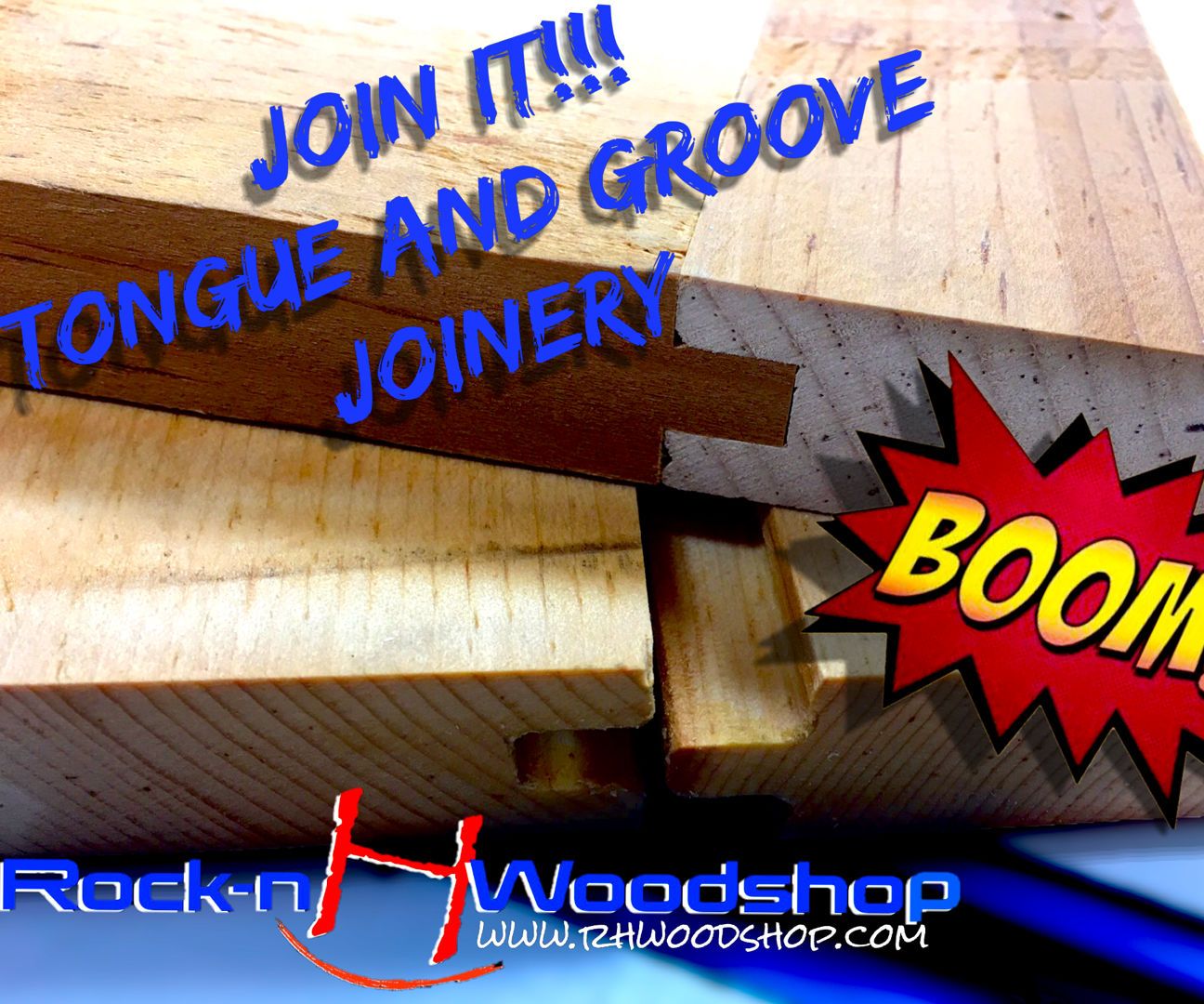

Once all the pieces are cut for the side cabinets, doors and middle cabinet; it is time to break out the dado stack and start batch cutting your grooves and dados. All side pieces of the side and door cabinets will have dados to accept the top brackets and middle brackets. There is also a 1/4" groove ran down the back of the ALL side pieces to accept the mounting cleats. The mounting cleats all have and offset tongue to be accepted into the groove and there will be 4 per cabinet except the center cabinet, which has 3. The top and bottom mounting cleats are also led into the top and bottom of each cabinet with a 1/4" groove to accept it (just like the back groove). These joints will offer great stability for each cabinet.
