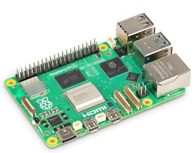

For my instructable, I've gathered up the following things:
  1. my laptop
  2. Raspberry Pi 5
  3. Freenove Projects kit for Raspberry Pi
  4. SD Card 32 Gb
  5. a laundry basket
  6. cooling for the Raspberry Pi
  7. webcam
  8. cables
Step 1: Raspberry Pi and PIR and Camera
The PIR detects a person coming to the laundry basket and records a video of the content of the laundry basket.

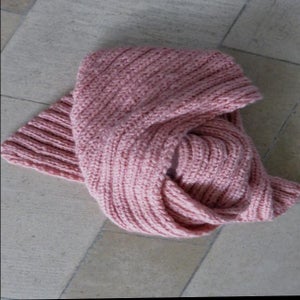

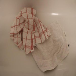

The AI model uses supervised learning and needs photos of the laundry.
Taking photos of the clothes and towels and other garments you throw in the laundry basket. Take several photos of the garment, in different positions.

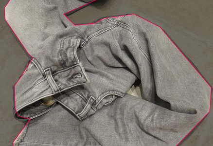

Step 4: Annotate and Train With Roboflow
Make a Roboflow account, upload your photos and start annotating!
Use bounding boxes to indicate where your laundry is and to what class it belongs.
Your model needs this to train well.
Choose the object detection model, augment your data and train your model.

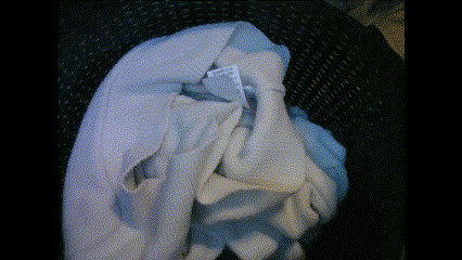

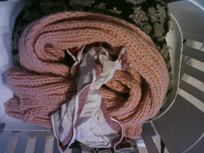

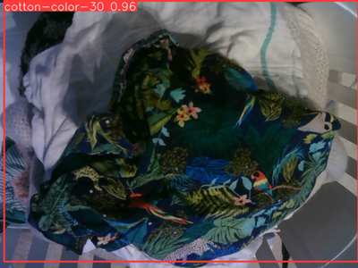

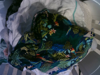

Step 7: Laptop Looks in the Laundry Basket
When the laptop receives the message from the PIR sensor, it takes a photo of the content of the laundry basket.

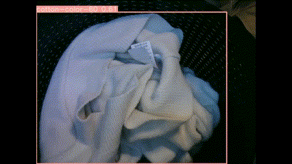

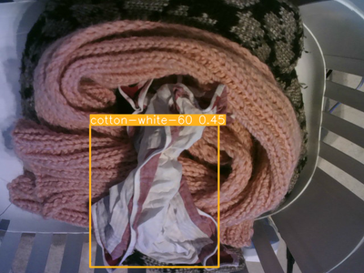

Step 8: Assigning the Laundry to a Washing Program
After the photo is taken, the supervised learning model starts to classify the laundry.
A csv file is created and when a washing program has 10 garments, the laptop sends a message to the LCD display to show the program to start.
Of course the amount of garments can be defined by washing program, depending on the garments and on the washing machine.
