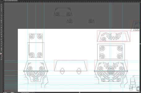

I first outline the object in Adobe Illustrator. I prefer Illustrator over the outline capabilities of 3D modelling tools.
I then export it as an AutoCAD drawing, which allows me to import the vector graphic into SolidWorks.
I then perform the necessary 3D manipulations in SolidWorks.
It is during outlining that I plan the 3D manipulations. One needs to be mindful of the types of vectors needed to perform certain manipulations. It is also during the outlining phase that I plan all the pieces I need. The chest top, bottom, legs, and in inner top lining to house the electronics are all separate pieces, and I need enough vector artwork to model them as separate pieces.

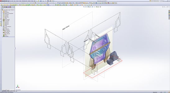

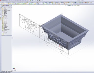

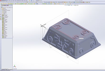

Here, I've already imported the vector artwork into SolidWorks. You can see some of the vector graphics in the screenshots.

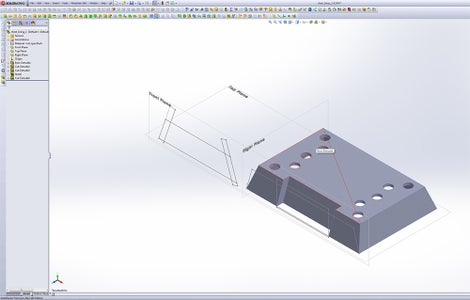

Most of the parts are easily recognizable. The last image is of the inner top lining of the chest. It leaves enough space in the top cavity for the electronics. There's also a notch for the reed switch (which I will talk about later). There are also holes in the lining to allow for sound to escape.

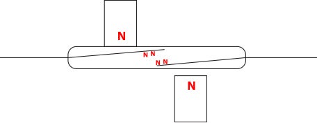

ALL reed switches are NO (normally opened). When you bring it near a magnet, it closes. However, I wanted it to function NC. The magnet would be on the bottom portion of the chest. When the chest is closed, the magnet opens the reed switch. When the chest is opened, the switch will be in it's NC position, triggering the sound module to play.
Note that there are "NC" reed switches, but they're really NO's that's been modified to work as NC. You may try to find those switches, but we can also create our own. Shown in the images below is how we can contruct one. We need some rare earth magnets. By attaching one to the reed switch, we keep the leads constantly magnetized. If we expose the switch with another magnet with the some polarity, we cause one of the leads to become magnetized with the introduced magnet, causing the leads to oppose each other.
