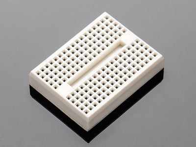

2x | Tiny breadboard

Step 23: Tranmitter Breadboard
We will now be assembling the breadboard for the transmitter.
First you will need to find the transmitter keypad, the one with 4 wires coming out of it.
You will also need a mini breadboard and the RGB Led
Step 24: Placing the Transmit LED
Fit the 4 legs of the RGB LED into the first bread board. Pay special attention to where you put the long leg (3V). See the Image for LED Pin Numbering
Step 25: Wiring the Transmit LED
Plug the Black wire into the breadboard to connect it to Pin 1 on the LED. This is going to be the same column of 5 on the breadboard
Plug the Red wire into the breadboard to connect it to Pin 2 (the long leg) on the LED
Plug the White wire into the breadboard to connect it to Pin 3 on the LED
Plug the Green wire into the breadboard to connect it to Pin 4 on the LED
