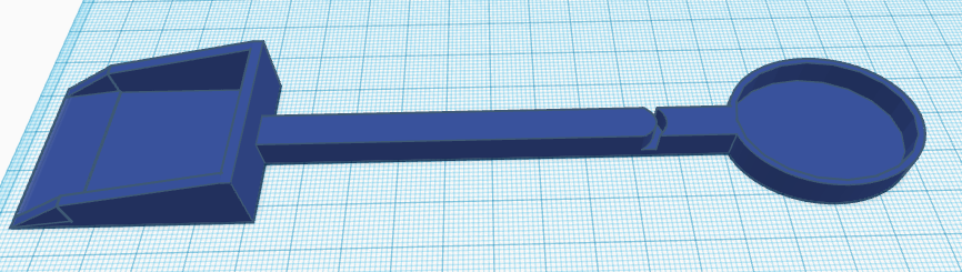

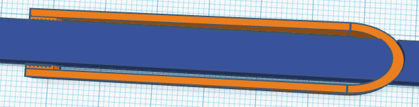

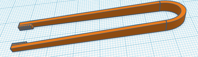

First, I designed a tool that had multiple uses. I wanted to create a tool that could scoop things in my lizard's cage, that could scoop out calcium powder, and that also had tweezers. To do this, I created two ends, one that looked like a spoon, and one that looked like a shovel, creating two sides with 2 different uses (Image 1). Additionally, I also designed tweezers (Image 2) and a gap in the handle of the multitool (Image 3) that could fit the tweezers (Images 4 & 5). The tweezers are slightly smaller than the gap, so they fit well without falling out.

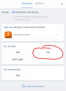

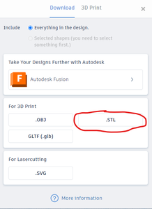

To export the file on Tinkercad, click export at the top left of the screen (Image 1). Then, click STL under "For 3d Print". (Image 2)

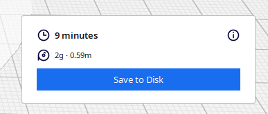

Then, slice it at 20% infill with a 0.2mm layer height and a brim for bed adhesion (Image 3). Then, click slice (Image 4). This results in a GCODE file that can be used on a 3d printer. Then, click "Save To Disc" or "Save To Removable Drive" (Image 5), which saves the file to your computer; or a SD Card, MicroSD Card, or Thumb Drive.

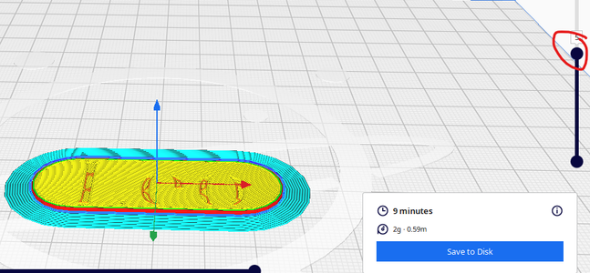

After slicing it, lift the slider until you find the layer that prints right before the letters start printing (Image 4). This was layer 5 for me, but it could be different depending on your settings or design. Then, click "Save To Disc", saving the GCODE file (Image 5).
For Octoprint Users Printing the Nametag in two colors:
Then, open the GCODE in Notepad (on Windows) or TextEdit (on Mac) and find the layer right after the layer you found. (this would be layer 6 for me). Then, right before this layer starts, type @pause (Image 6). This command line pauses the print for people who are using Octoprint.
