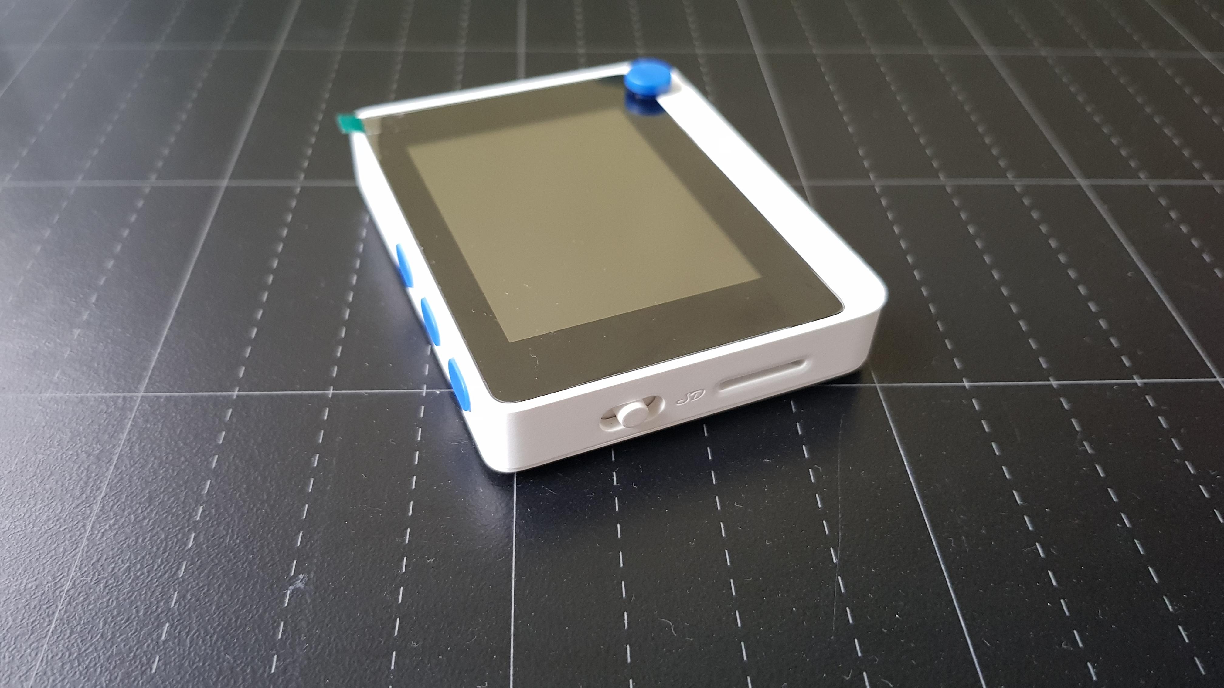

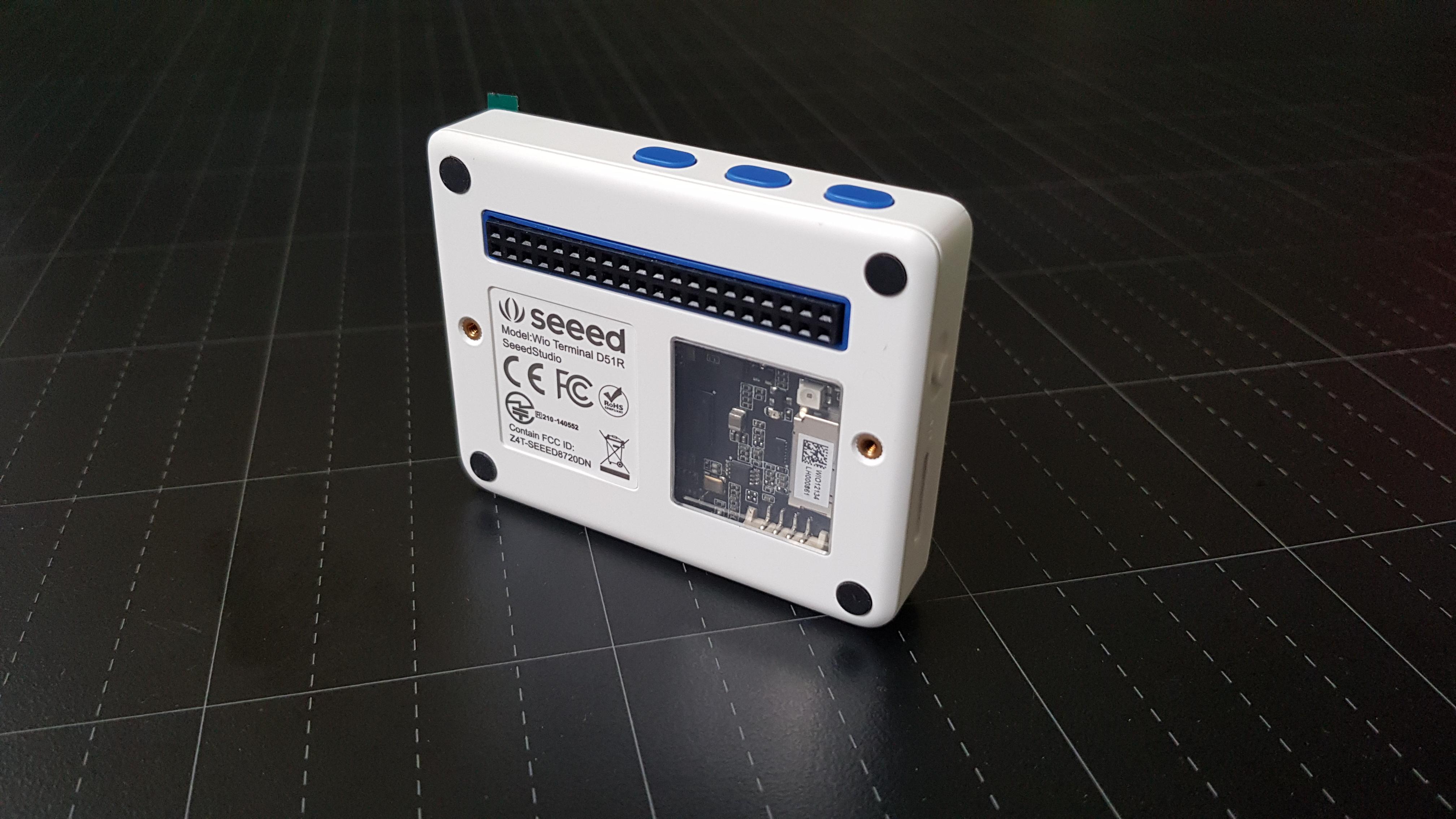

Step 2: Seed Wio Terminal
The Wio Terminal is a SAMD51-based microcontroller with Wireless Connectivity powered by Realtek RTL8720DN that’s compatible with Arduino and MicroPython. It runs at 120MHz (Boost up to 200MHz), 4MB External Flash and 192KB RAM. It supports both Bluetooth and Wi-Fi providing backbone for IoT projects.
The Wio Terminal itself is equipped with:
- 2.4” LCD Screen.
- Onboard IMU (LIS3DHTR).
- Microphone.
- Buzzer.
- microSD card slot.
- Light sensor.
- Infrared Emitter(IR 940nm).
- 5 Way Switch.
- 3 User Defined Button.
- Built-in RTC functionality inside the SAMD51 core.
- And so on.
On top of that, it also has two multifunctional Grove ports for Grove Ecosystem and 40 Raspberry Pi compatible pin GPIO for more add-ons.
Check detail at: https://www.seeedstudio.com/Wio-Terminal-p-4509.html
Wiki page: https://wiki.seeedstudio.com/Wio-Terminal-Getting-Started/

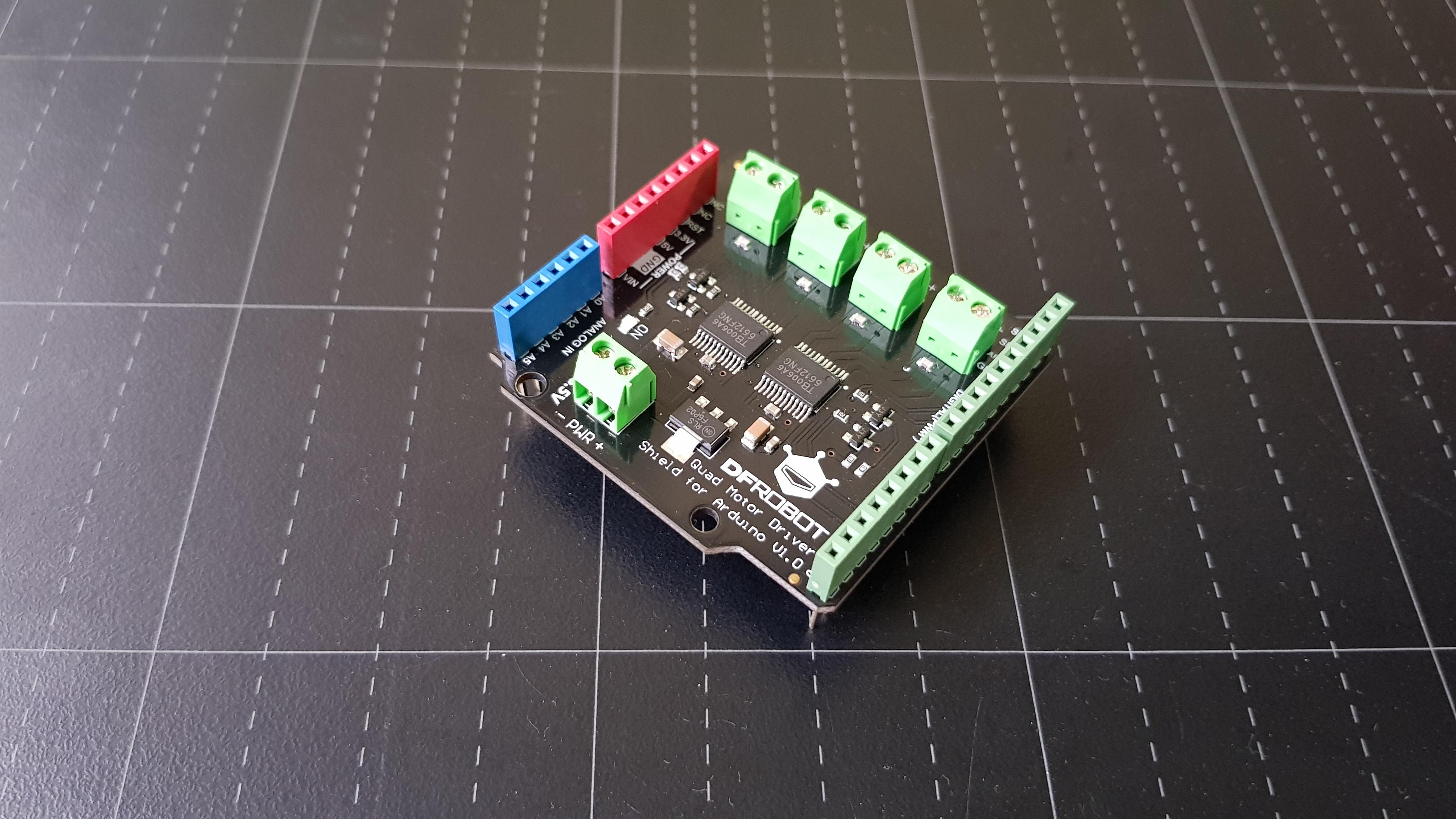

Step 3: DFRobot Quad DC Motor Driver Shield for Arduino
The latest quad motor driver shield for Arduino, compatible with 5V/3.3V Arduino controller, can control up to four DC motors with 8 pins at the same time. The shield supports PWM speed control and direction control.
The driver shield includes two TB6612FNG motor driver chips with maximum output 1.2A continuous current on each channel. The module includes a built-in low voltage detection circuit and thermal shutdown protection circuit, which is safe and reliable.
You can check detail at product link and wiki page.

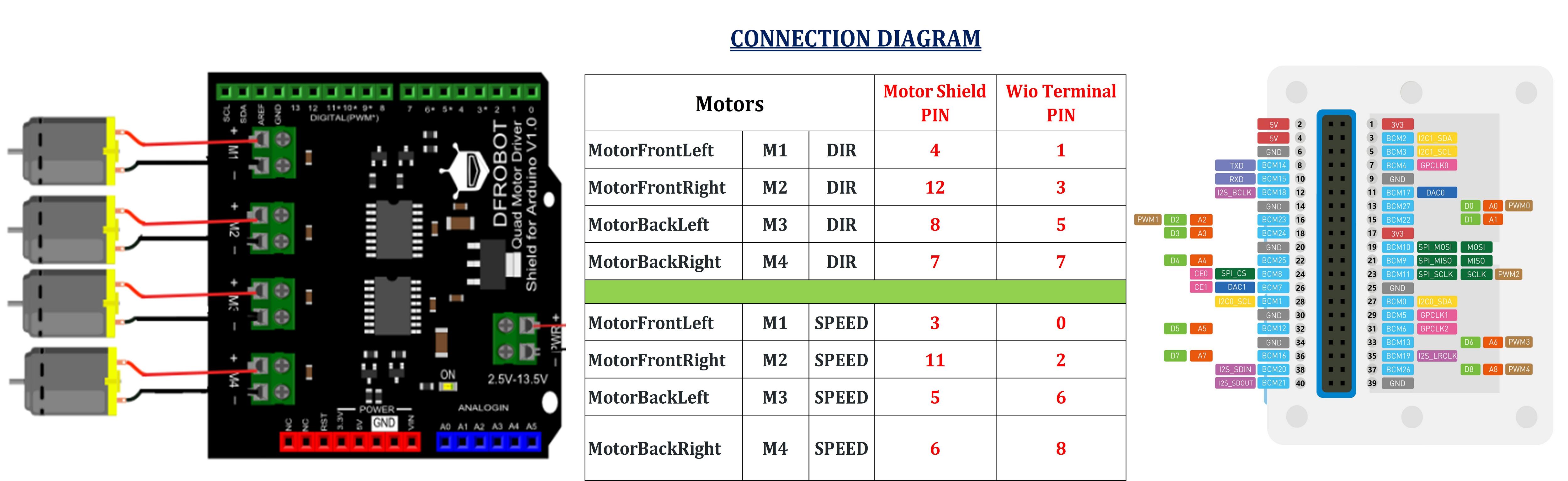

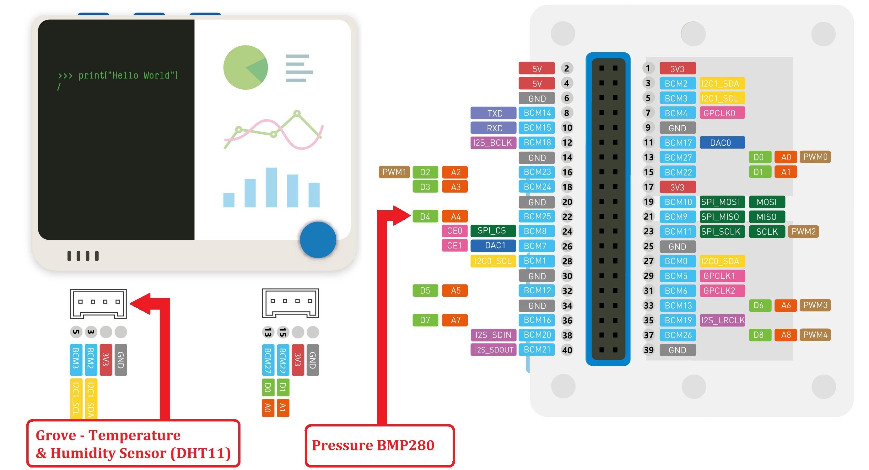

Step 4: Circuit Diagram
The motor connection is shown below:
The quad motor shield need two signals to control one DC motor: DIR & SPEED. And the motor speed signals have to be connect to PWM pins of Wio Terminal, as follows:
- PWM0 (D0/A0).
- PWM1 (D2/A2).
- PWM3 (D6/A6).
- PWM4 (D8/A8).
The DHT11 temperature & humidity sensor is connected to Grove I2C port & BMP280 pressure sensor is connected to pin D4/A4 of Wio Terminal.

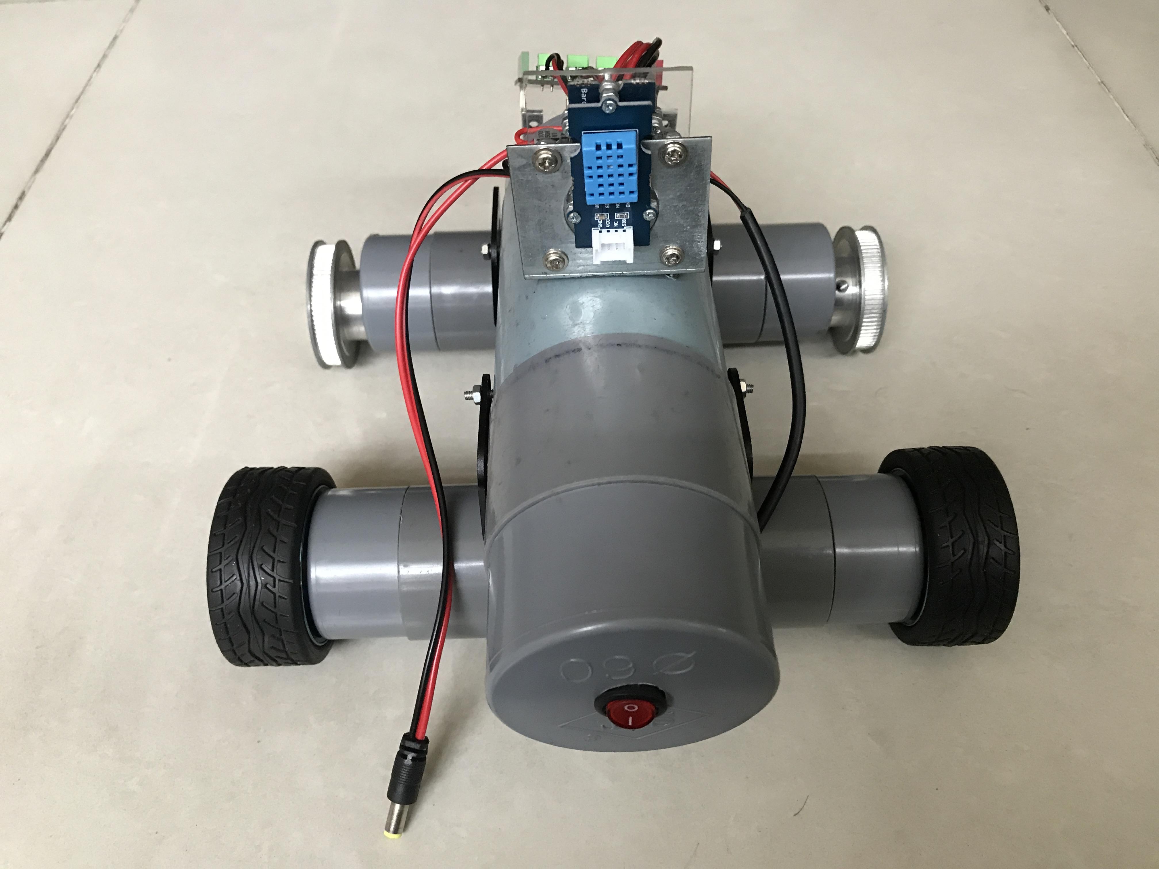

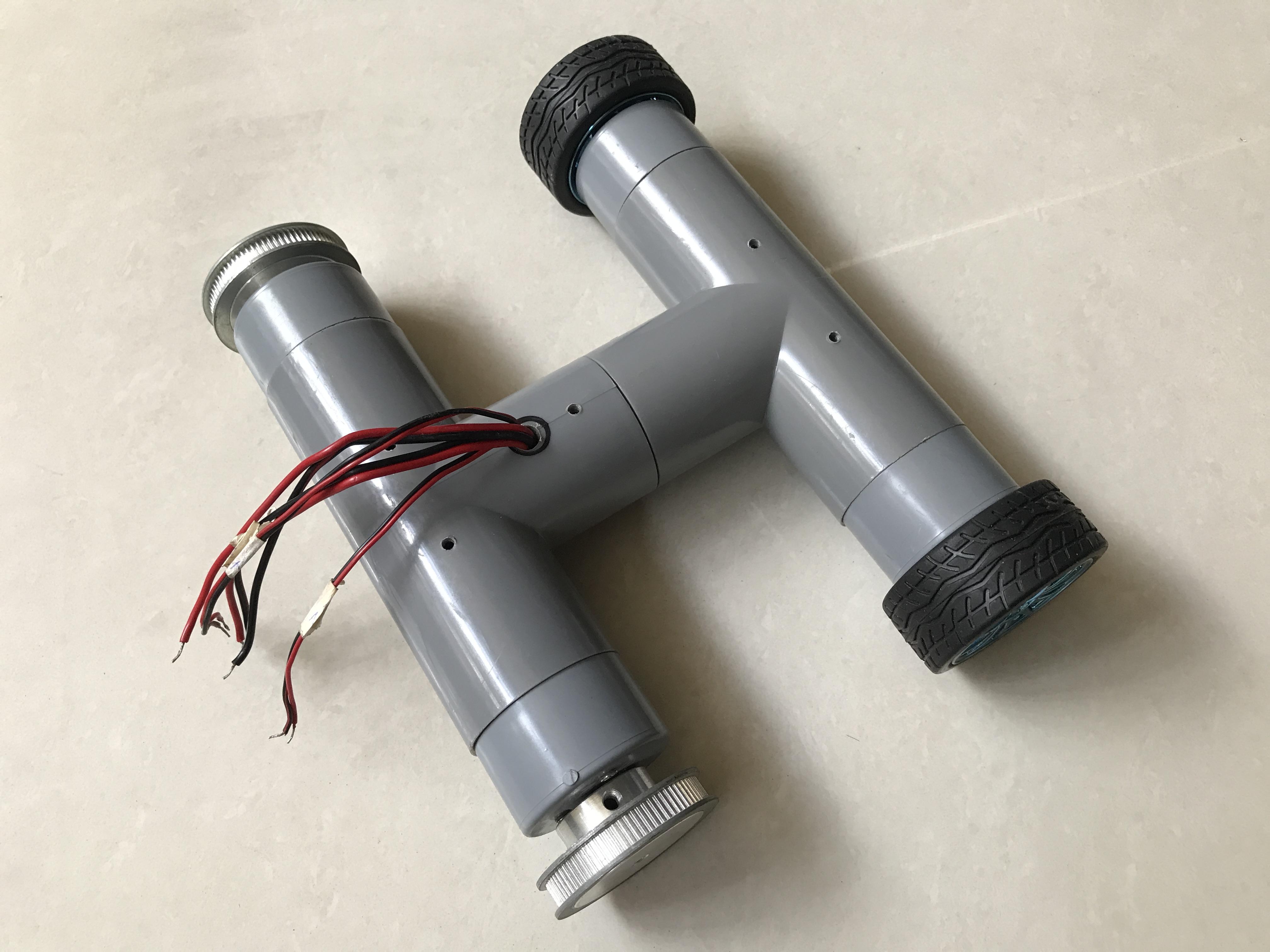

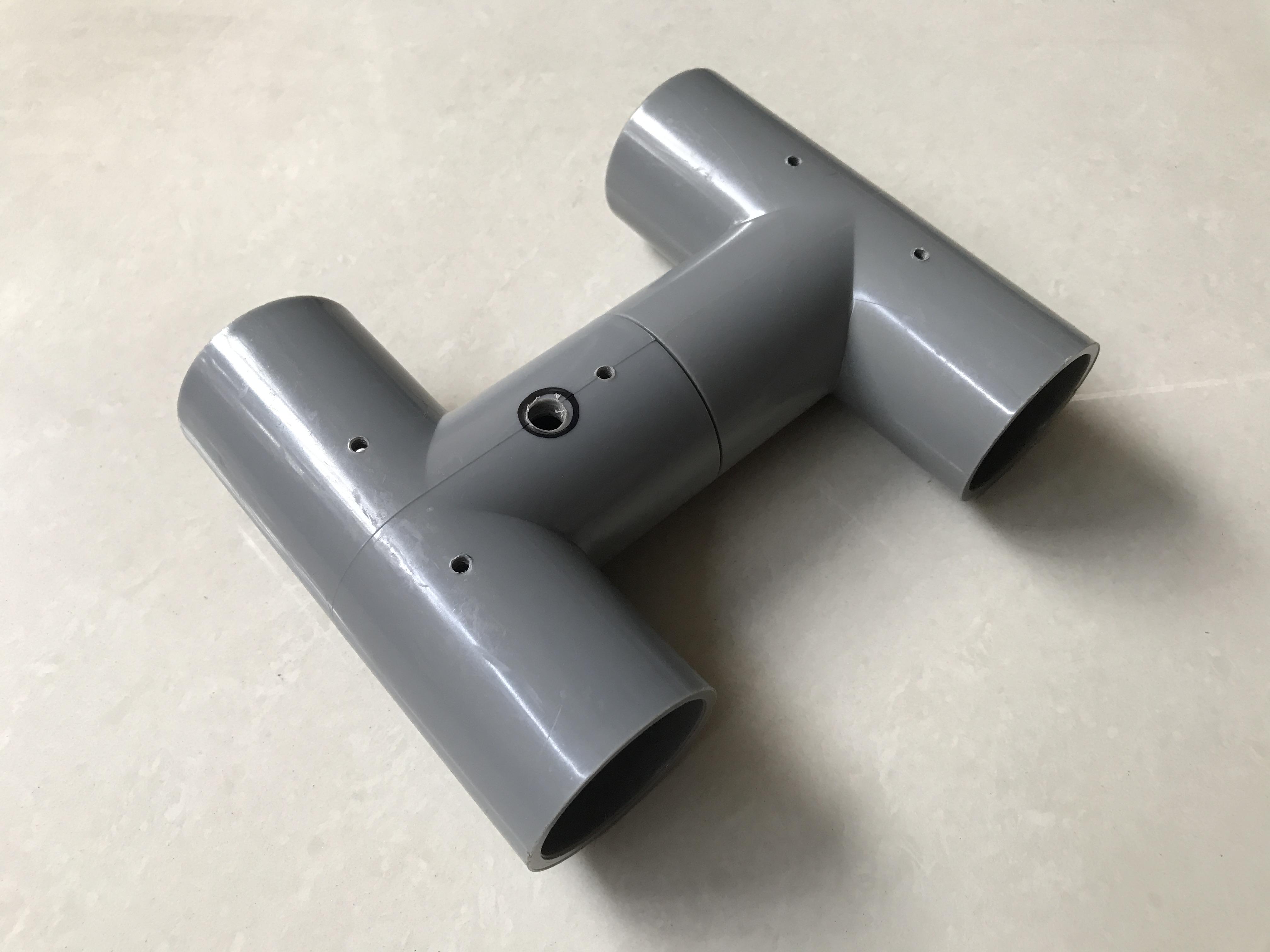

Step 5: Build a Car Chasis

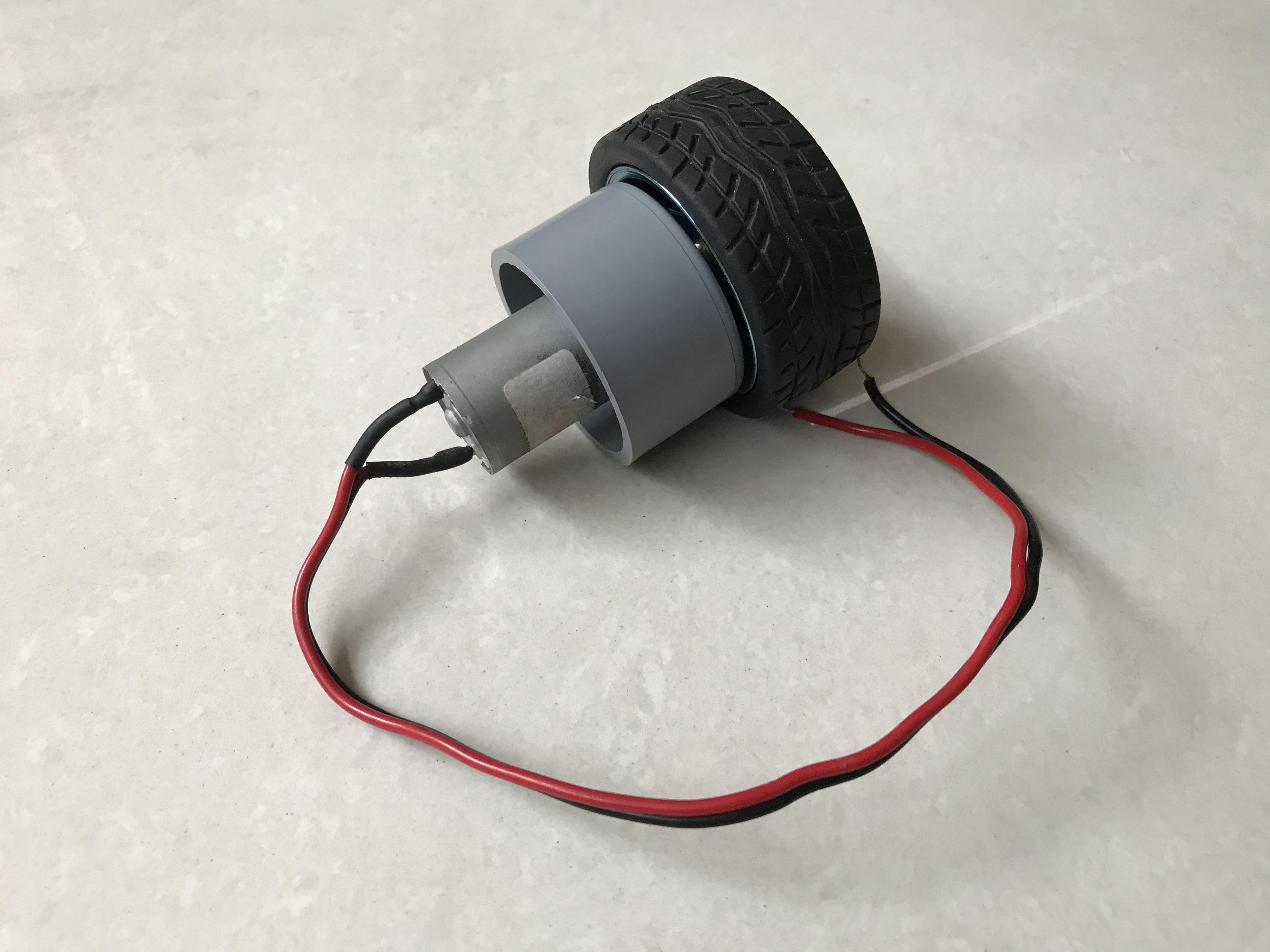

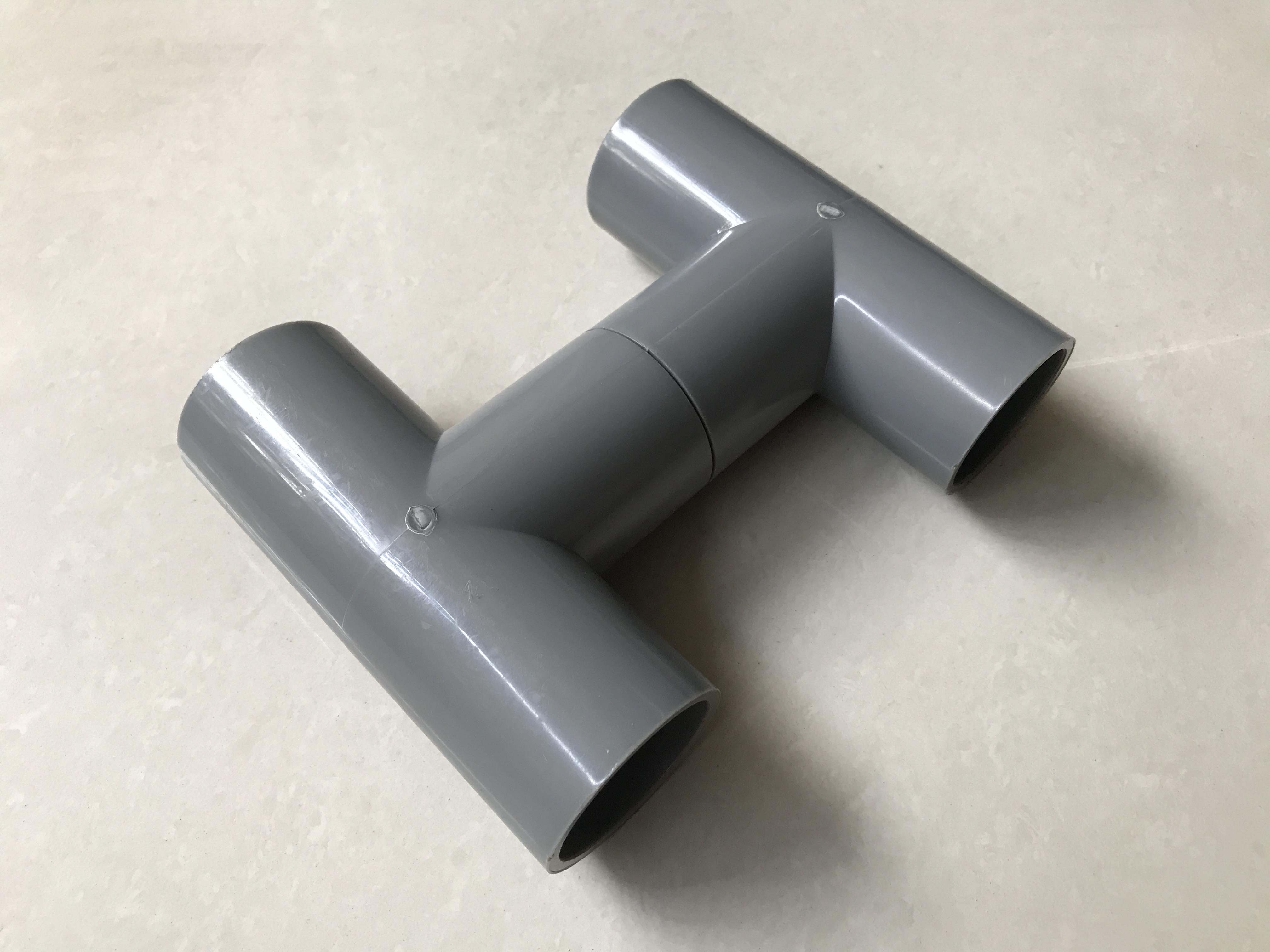

Firstly, I joined 2 pcs x PVC tees Ø42mm together to build a car chassis.
I measured and drilled holes on the 4pcs x PVC end caps Ø42mm which were used as motor supports. I soldered all power cables for 4 DC motors, mounted them on the end caps and attached hexagon motor couplings for wheels.
Drill some holes on the top of PVC chassis to mount battery holder, control boards and DC motor cables.

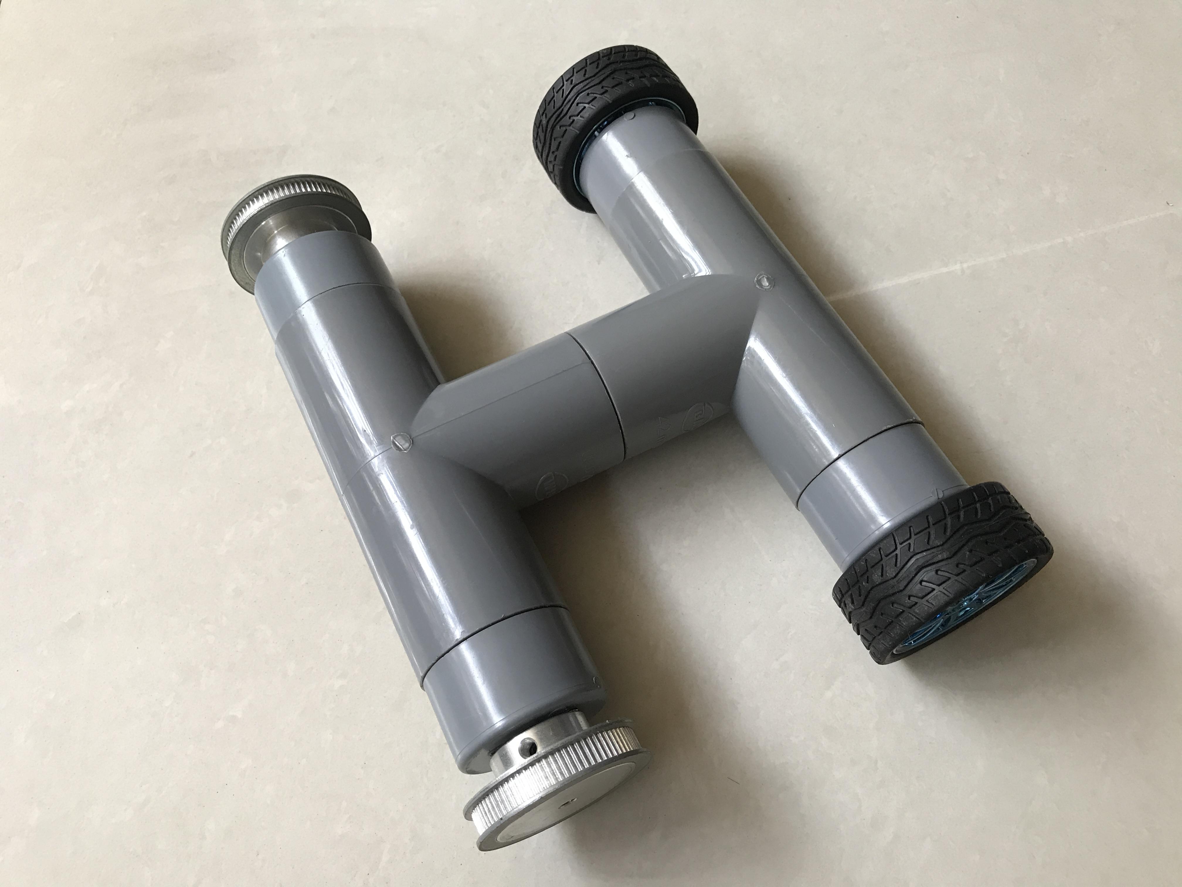

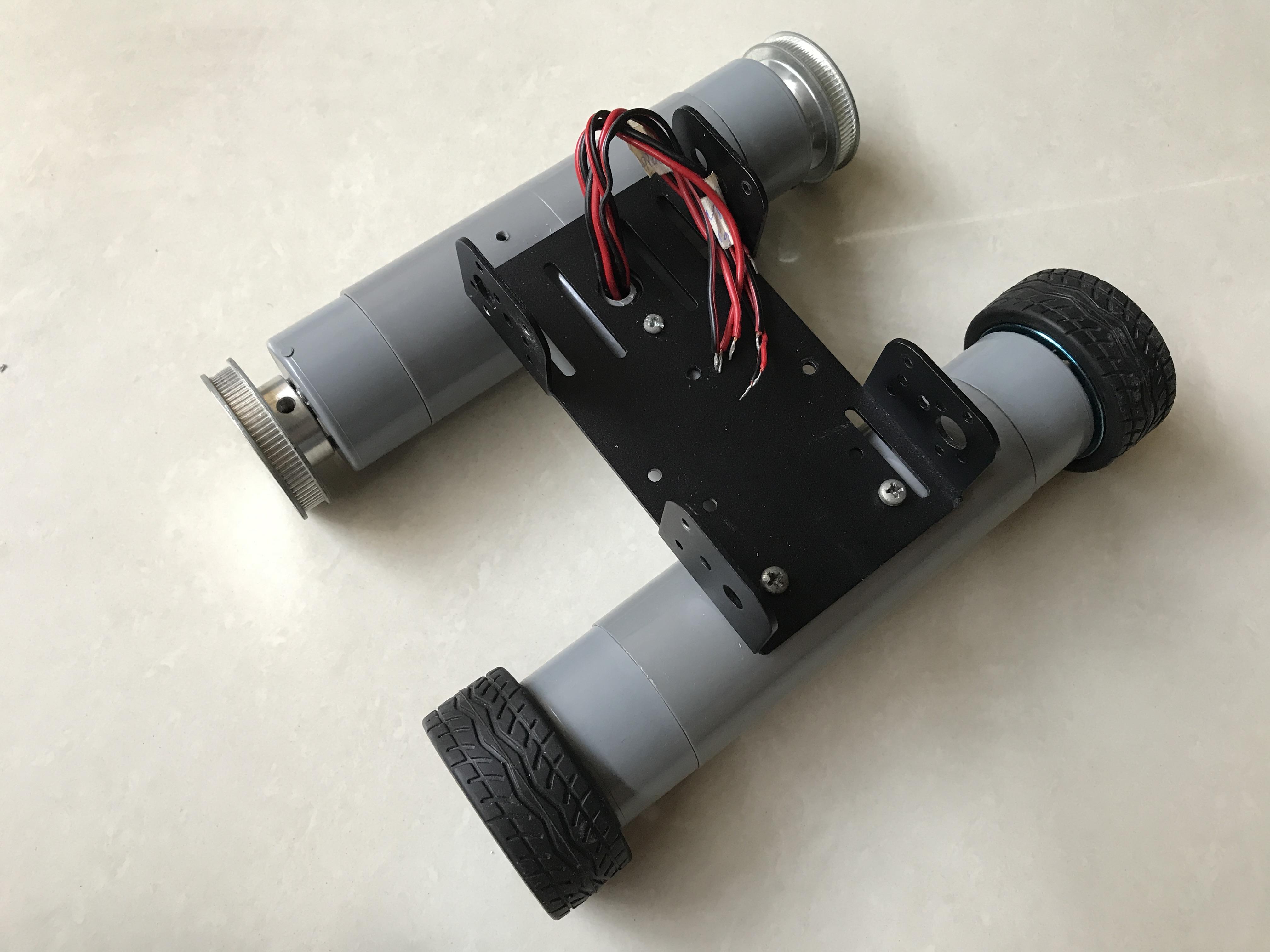

Step 6: Wheel Assembly
I attached all 65mm rubber wheels to motor shafts via hexagon motor couplings.
I didn't have enough 4 wheels so I used 2 pulleys 80 teeth for two front wheels.
Four end caps motor supports were connected to PVC car chassis by 4pcs x pipes Ø42mm, length 65mm.
Thread all motor cables inside the PVC chassis and they come out through an opening drilled.
Install a steel plate between two PVC tees to ensure the chassis stays in place and alignment when it's in operation.

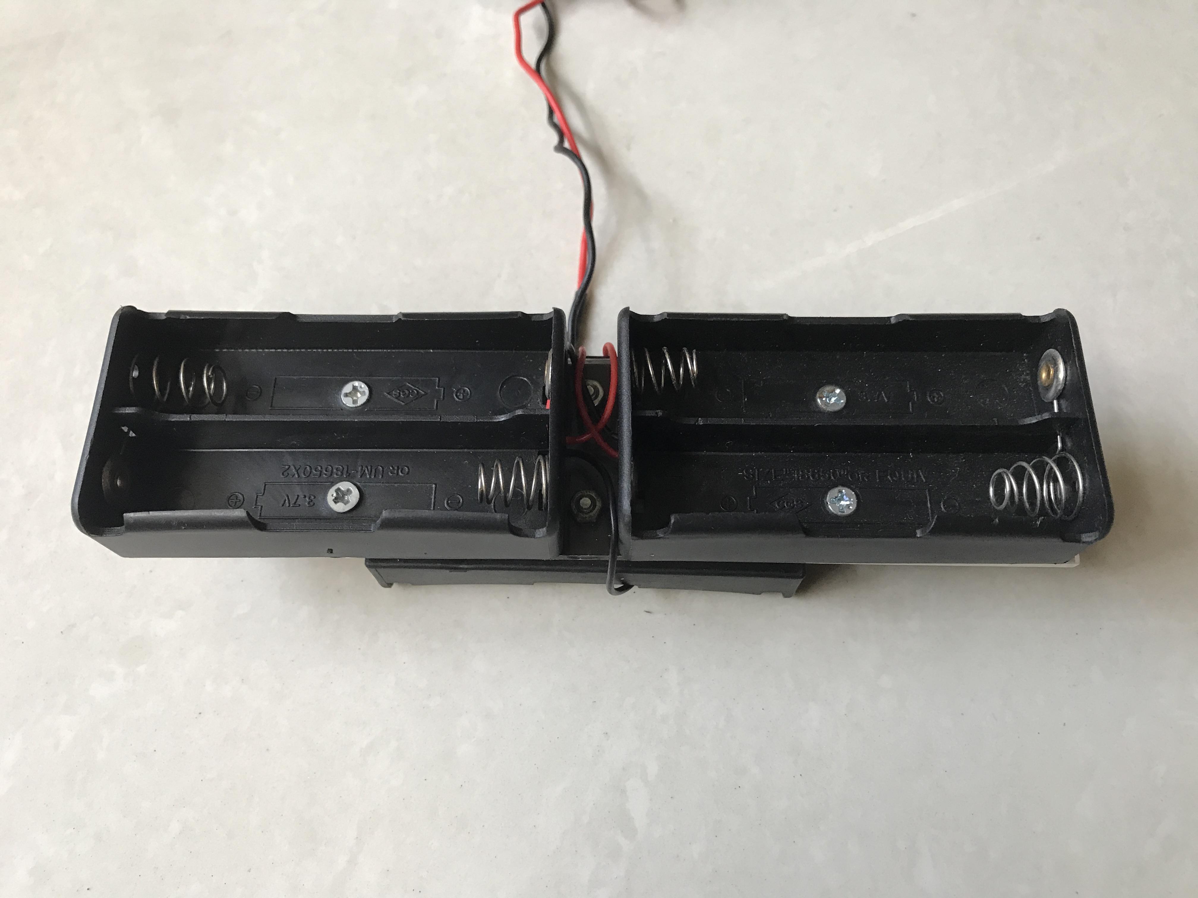

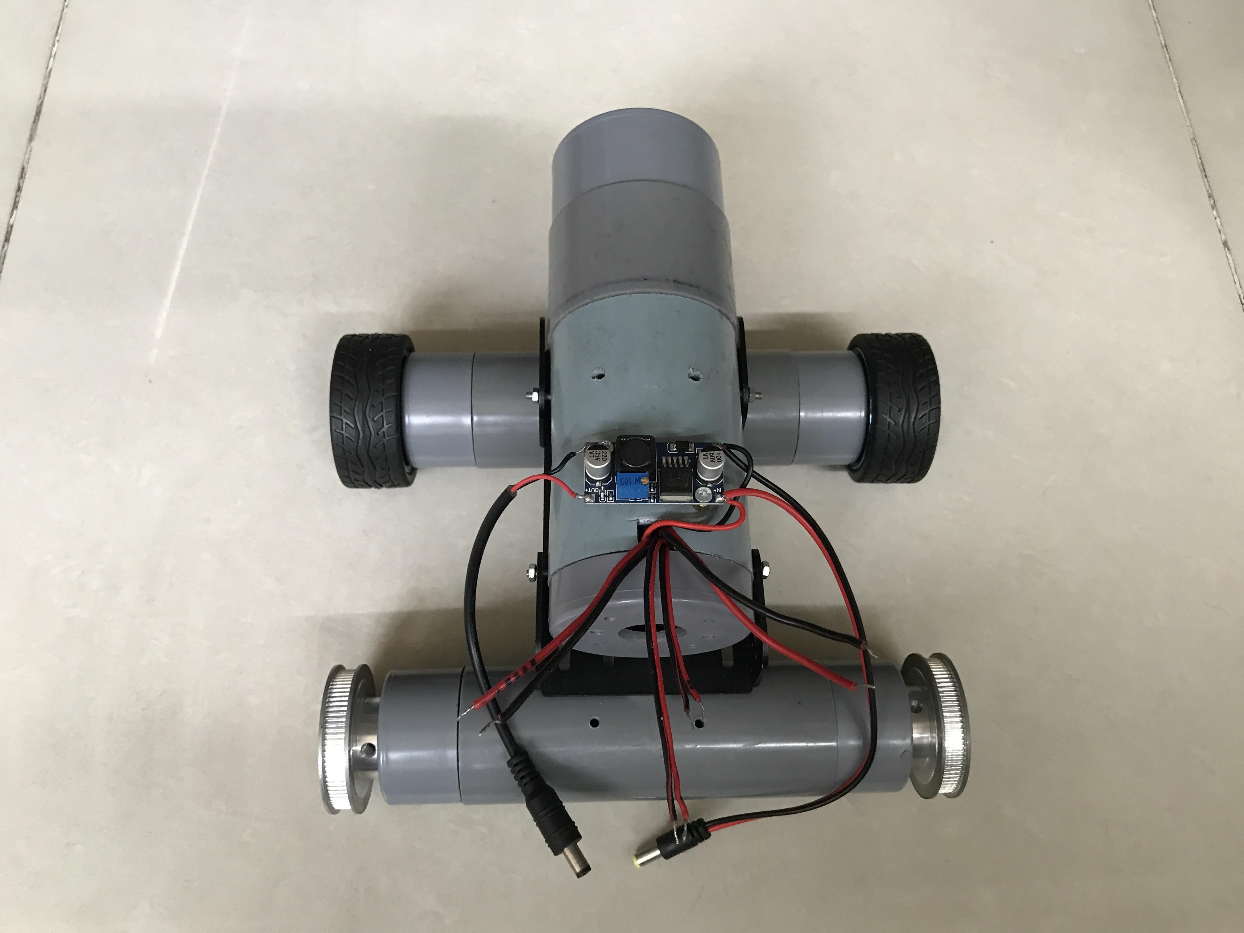

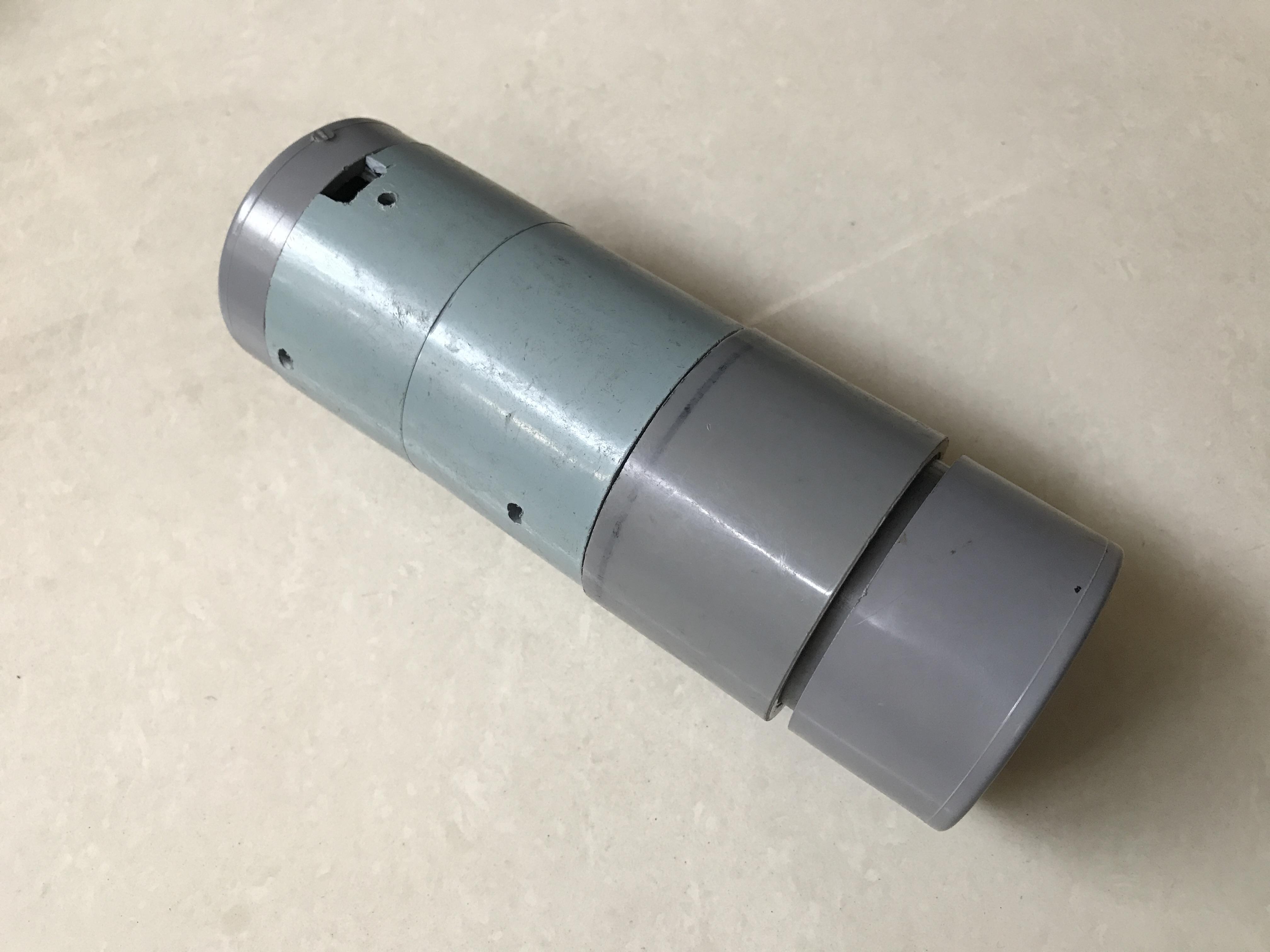

Step 7: Baterry Holder

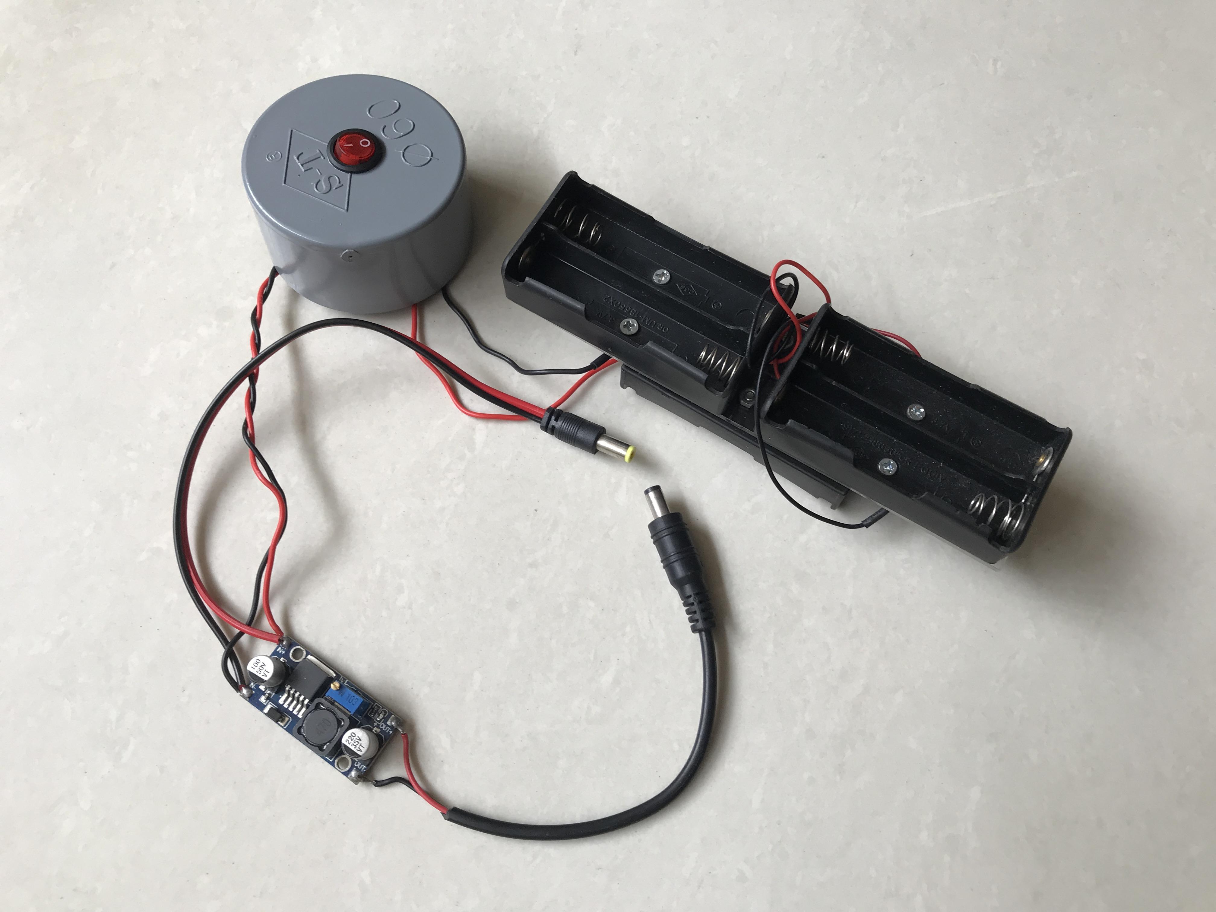

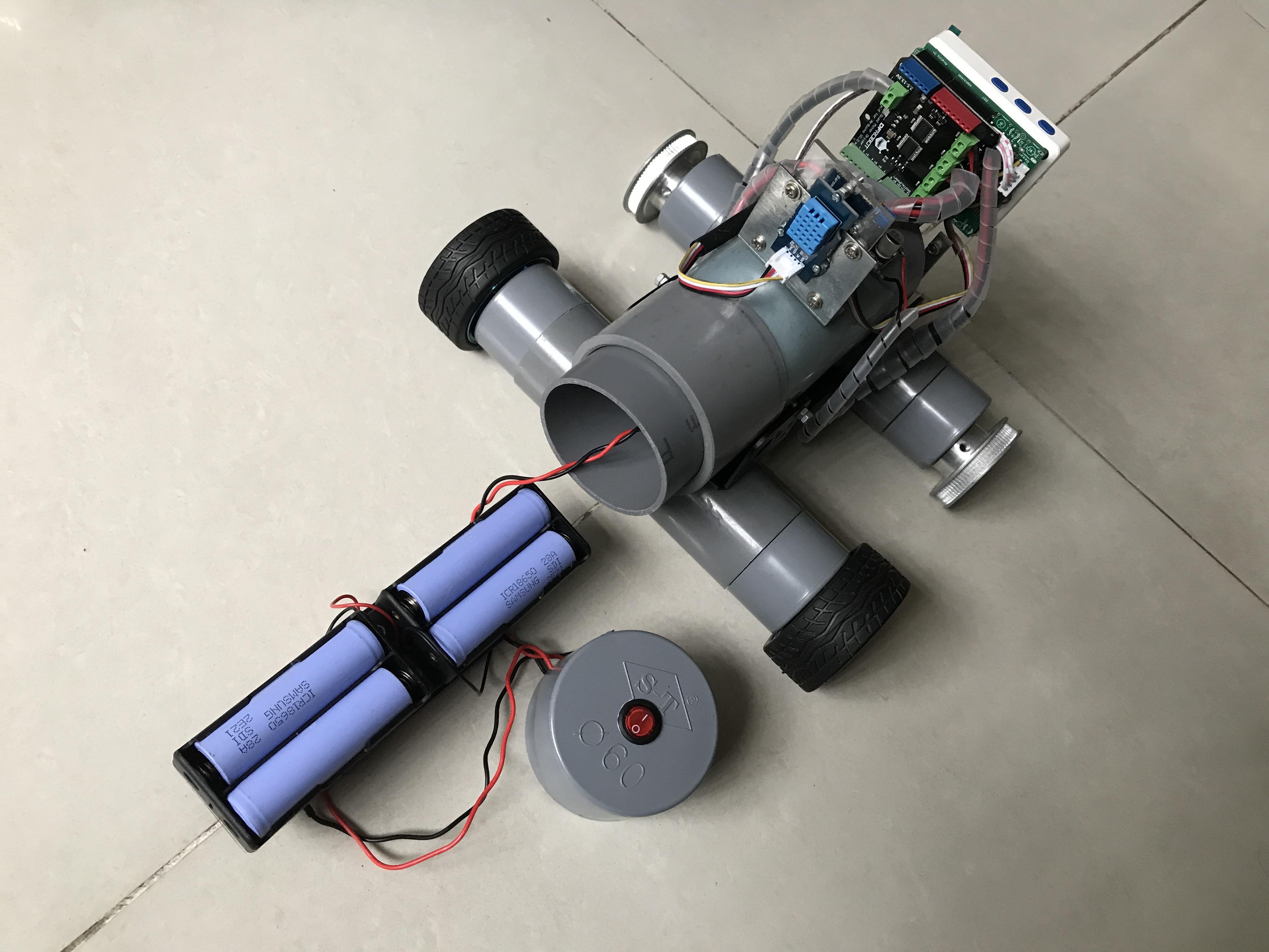

I cut a small acrylic sheet, dimension 180 x 40mm, drilled holes amd mount 2pcs x one slot & two slot battery 18650 holder on it.
All batteries including their plastic holders were hidden inside the PVC straight connector Ø60mm.

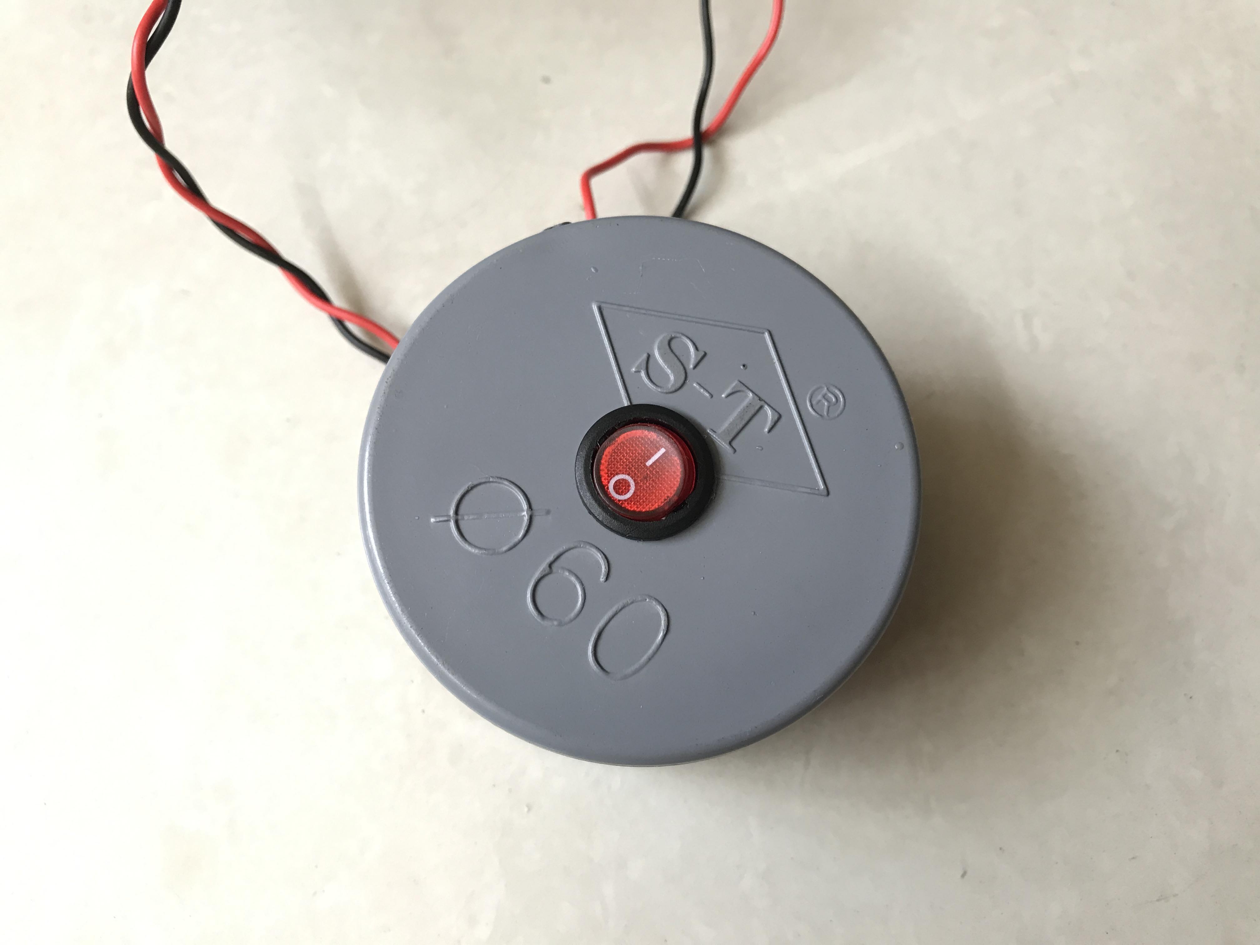

I covered this PVC battery holder by end caps and mounted one ON/OFF power switch at the back of end cap Ø60mm.

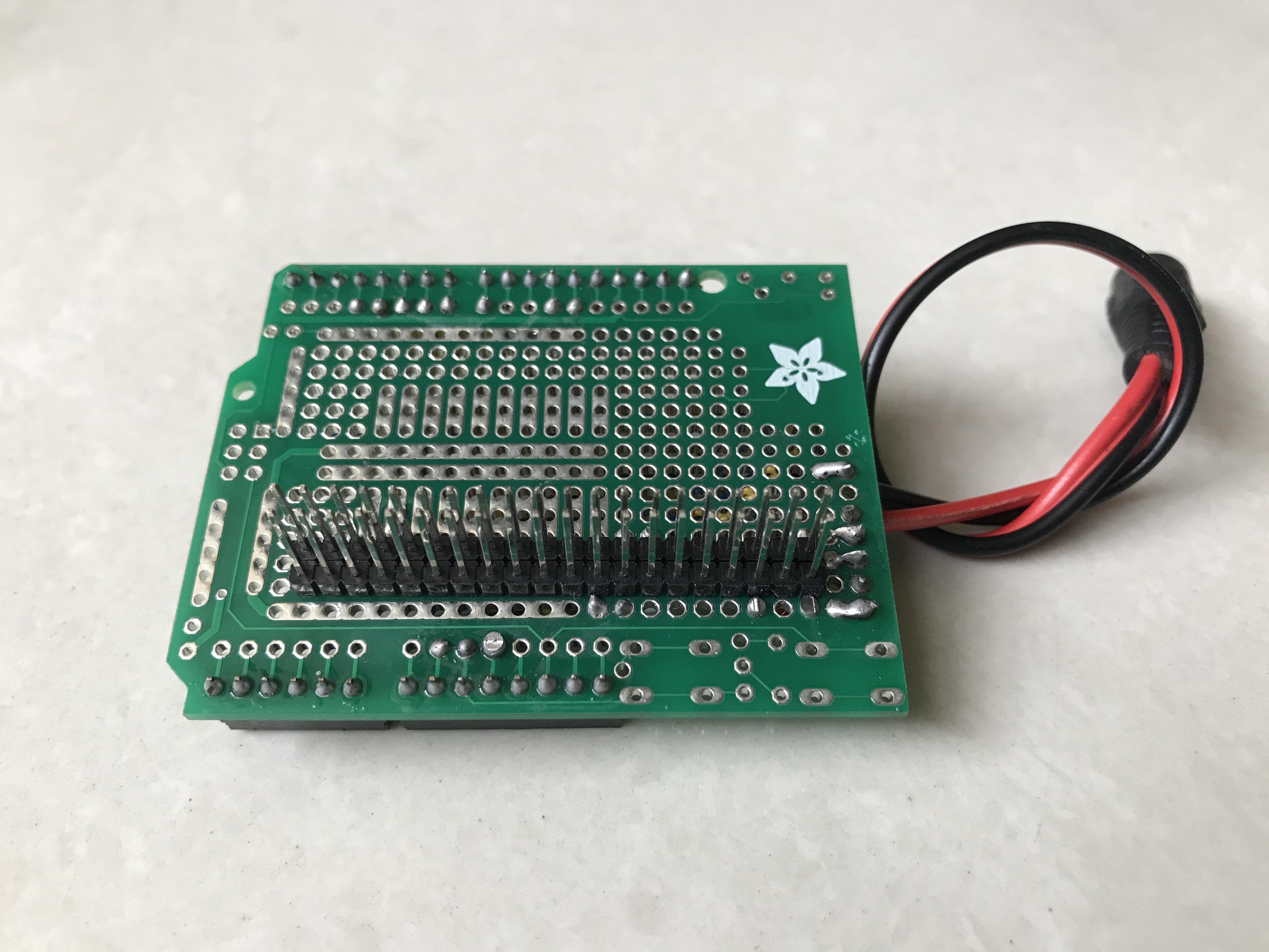

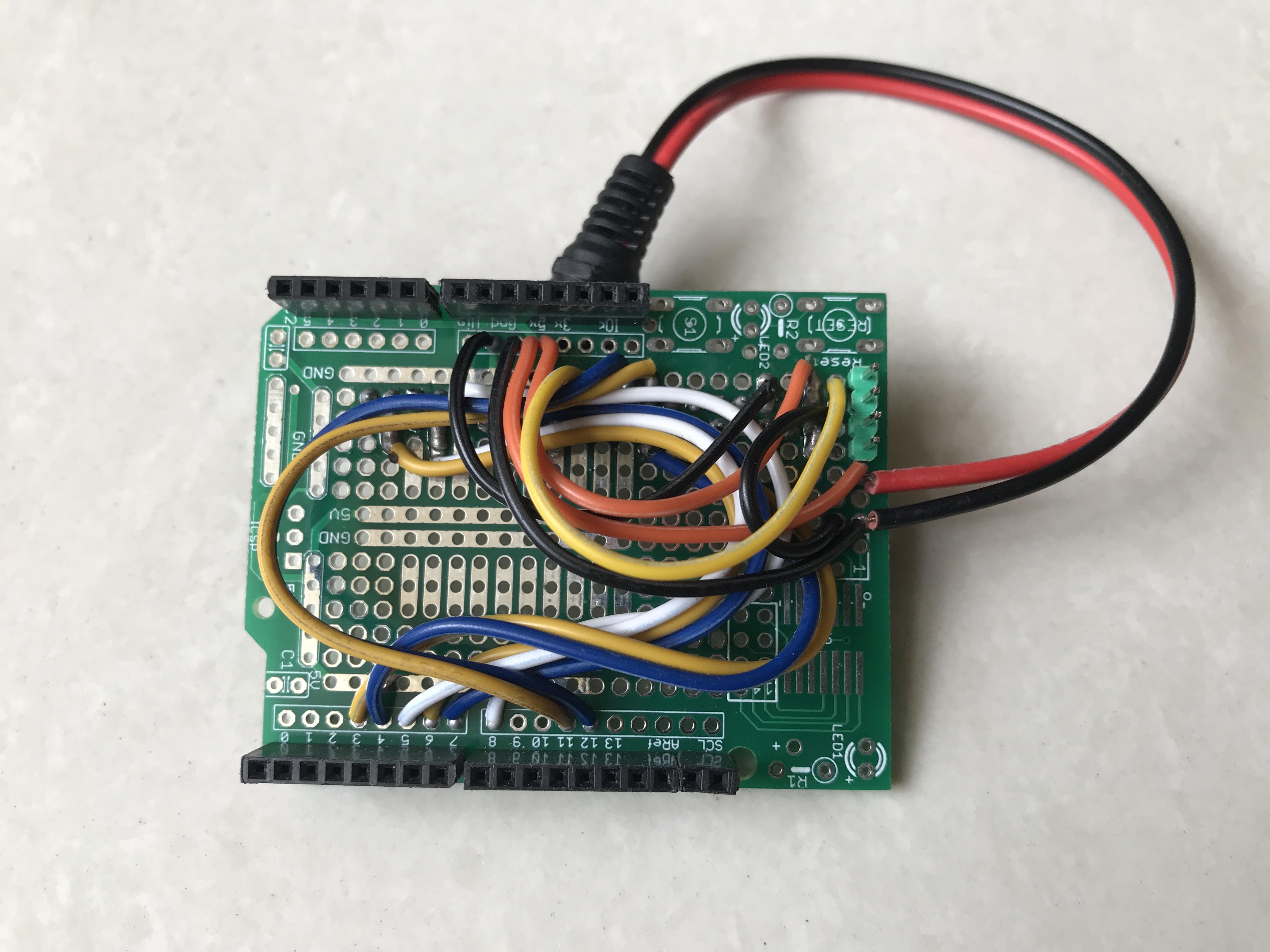

Step 8: Soldering Protoshield and Battery
I soldered 2 row x 20 pin male headers on the Protoshield PCB bottom. It was used to connect to Wio terminal female header.
On the Protoshield top, I soldered all female headers corresponding to the male headers of Quad DC Motor Driver Shield. Then I soldered all control wires from Wio Terminal to the Motor shield following the schematic on the previous step.
Connect Protoshield with Wio Terminal and motor shield. It looks like this.
I used 6pcs x 18650 rechargable batteries which were divided into 2 parallel groups and each group with 3 batteries in series. When fully charged, the output voltage was about 12VDC. To power 5VDC to the Wio Terminal and the motor shield, I used a step-down power supply module LM2596.

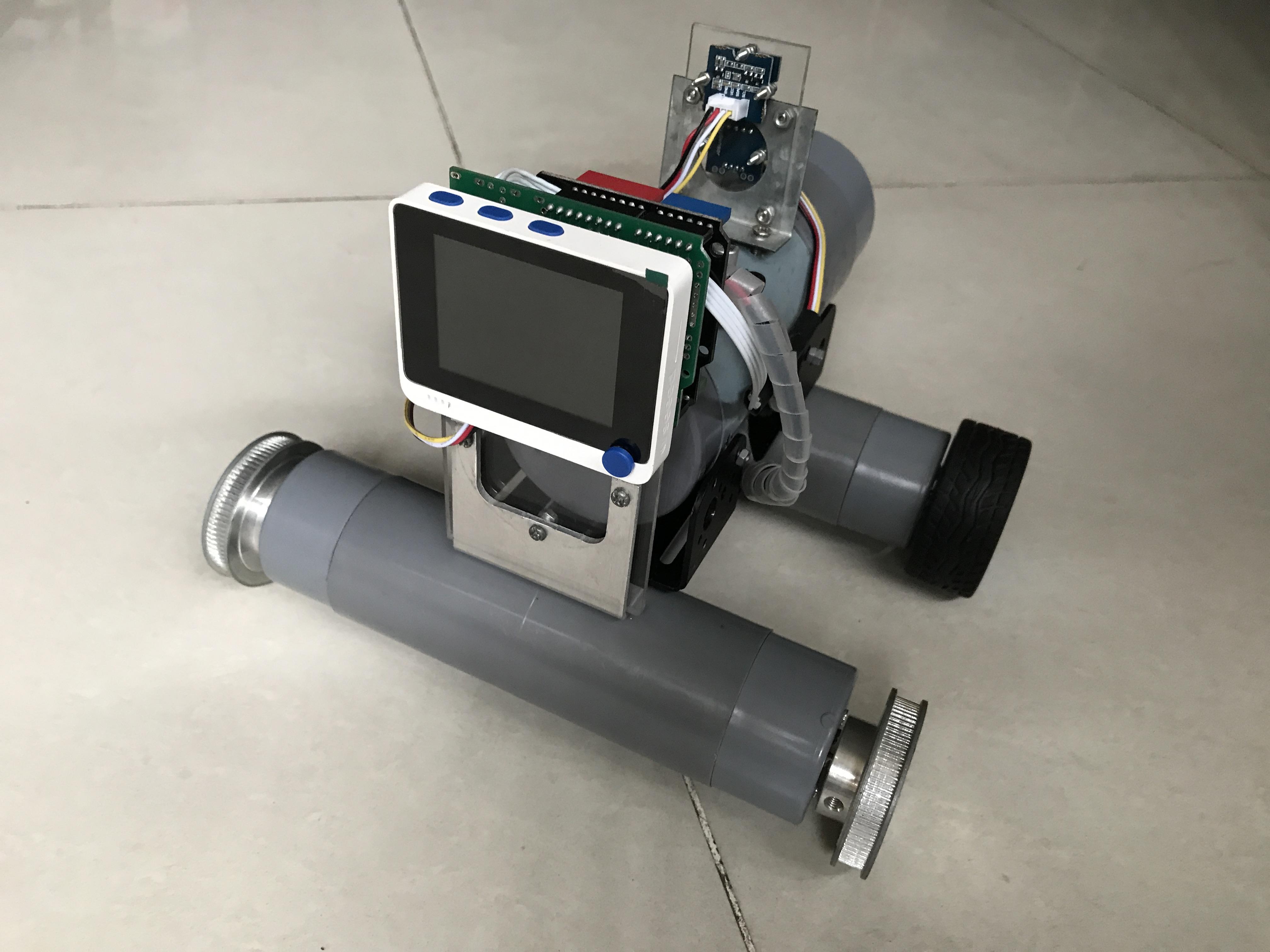

Step 9: Assembly & Connection

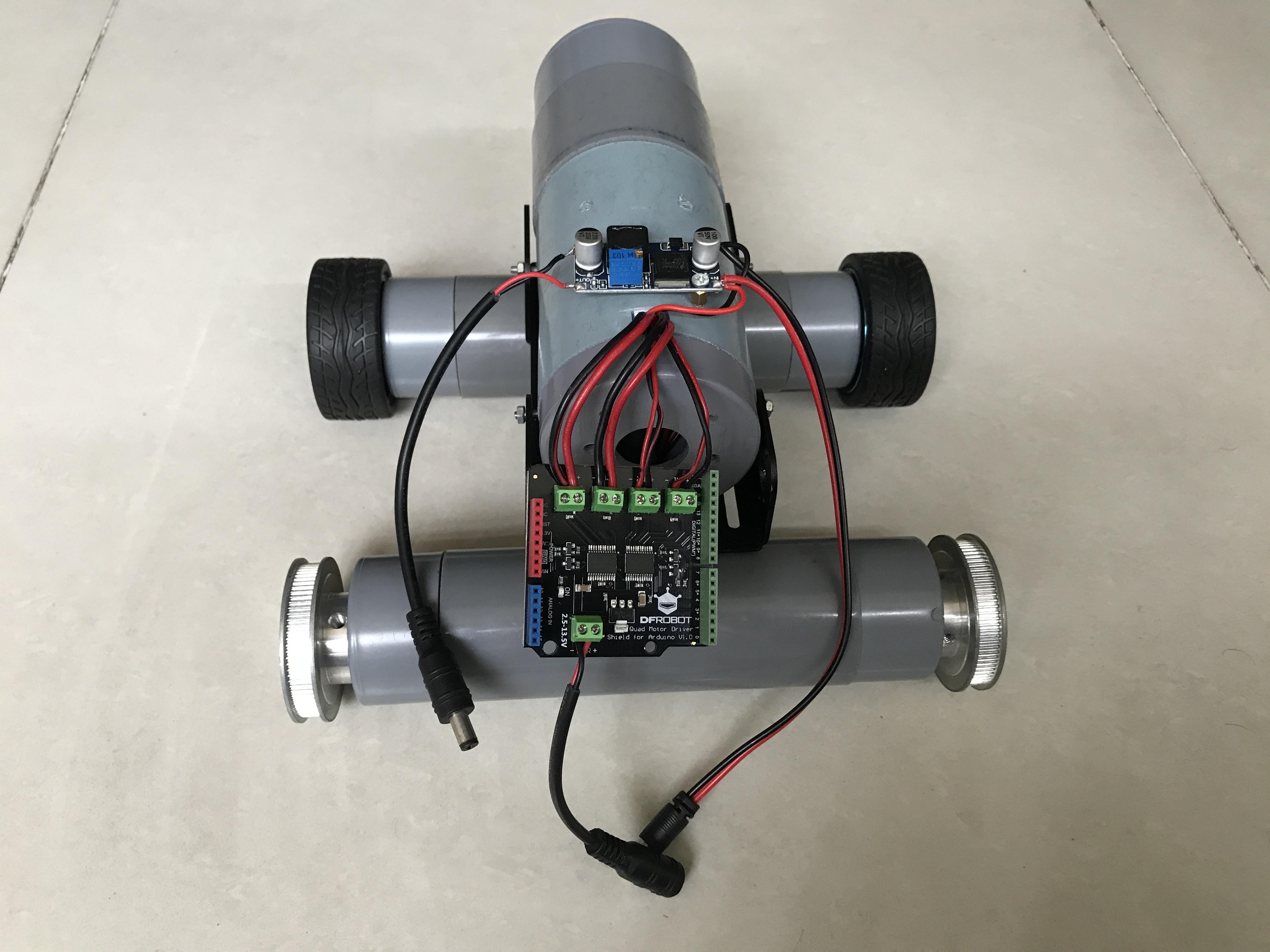

Install battery holder on the chassis and place LM2596 module on top of PVC battery holder.
Connect all motor cables to quad motor shield terminals.

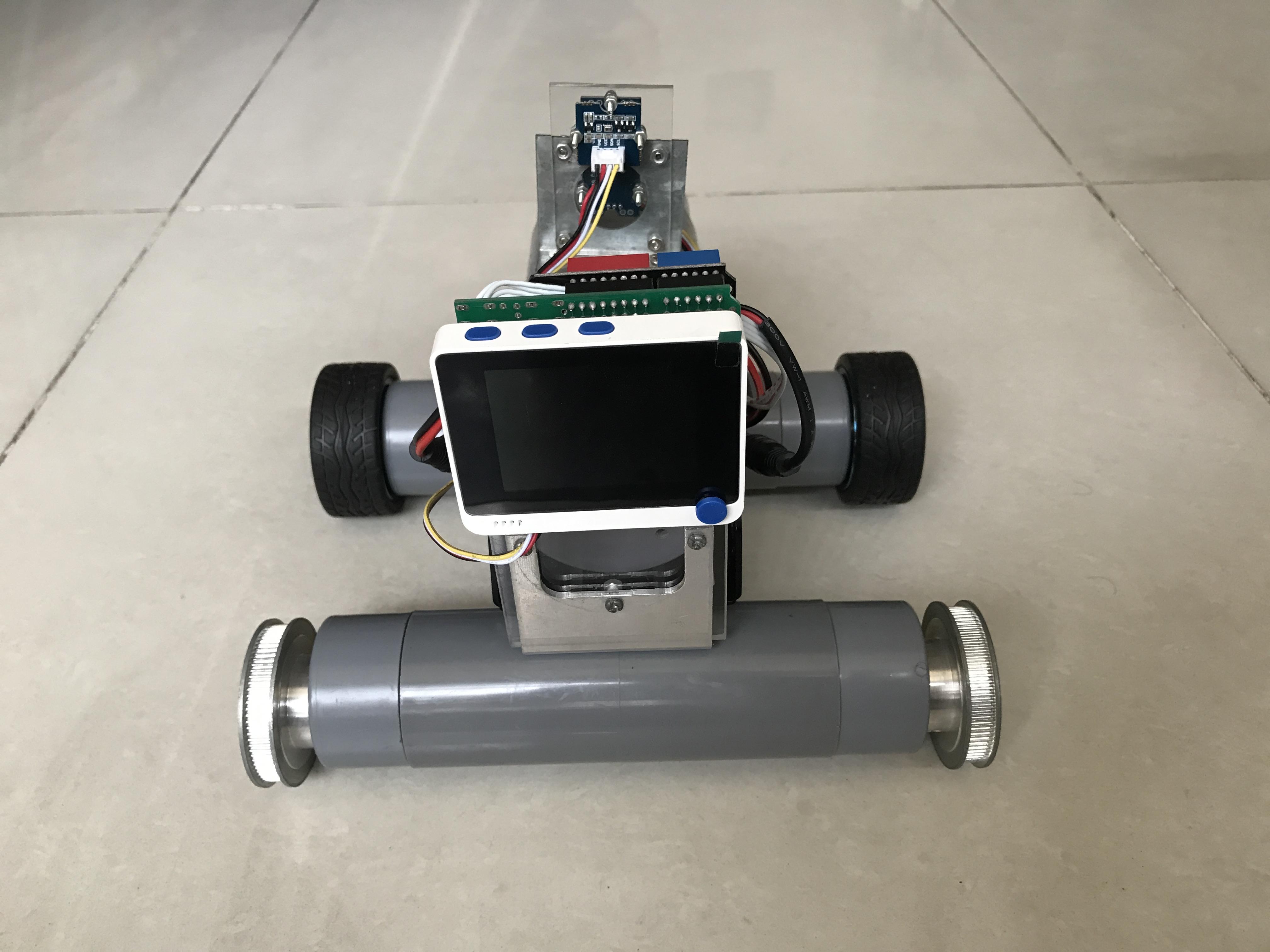

Install DHT11 and BMP280 sensors on the PVC battery holder.
To mount Wio Terminal and motor shield, I used one other aluminium angle and acrylic sheet.
Insert 6pcs x 18650 batteries into their slots.
DONE!

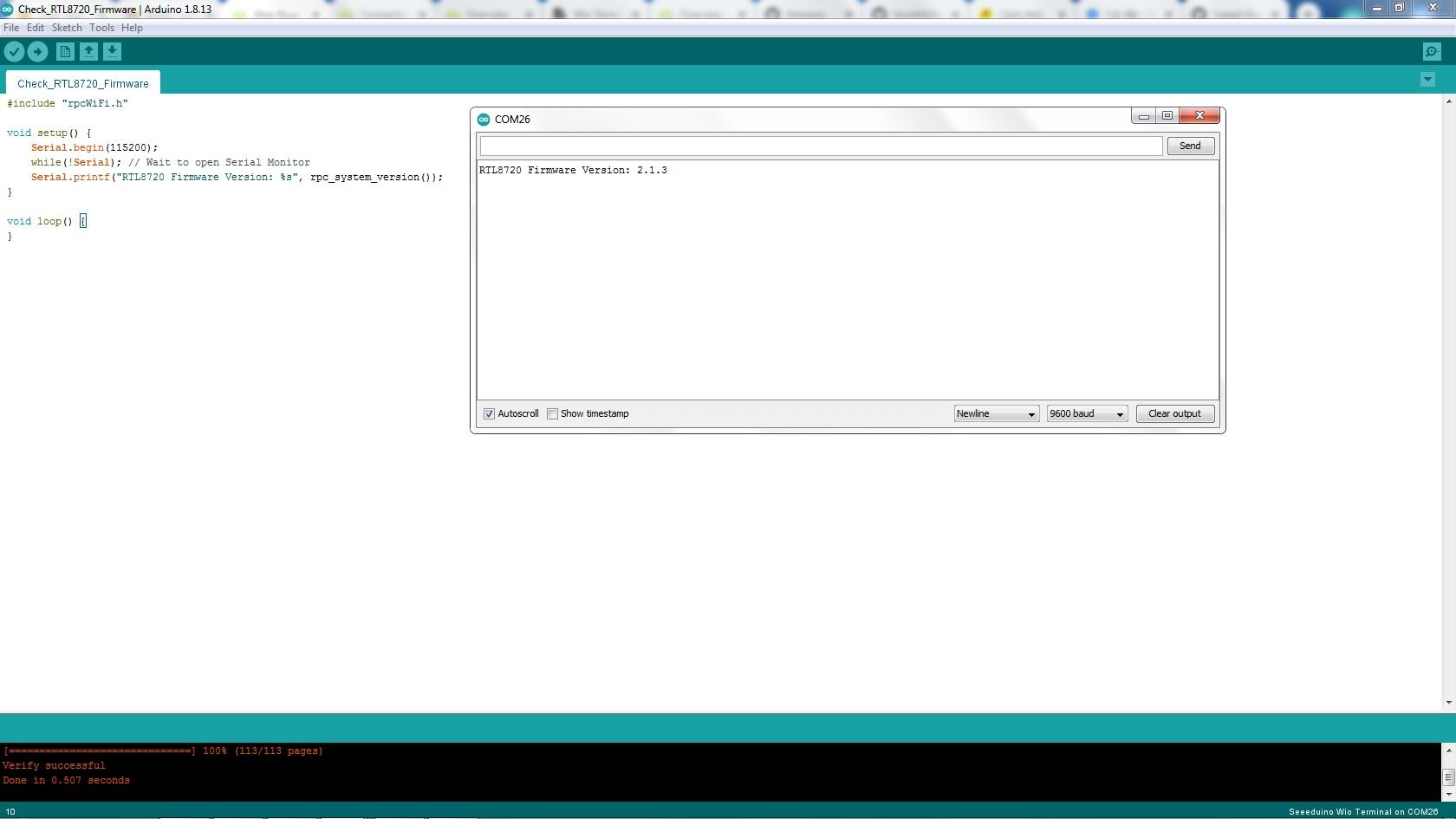

Step 10: Flashing RTL8720 Firmware for Wio Terminal
To update the latest firmware for the Wireless Core Realtek RTL8720 on the Wio Terminal, we can refer to this link:
I have updated RTL8720 firmware to version 2.1.3.
Some libraries for Bluetooth were also installed into Arduino IDE.

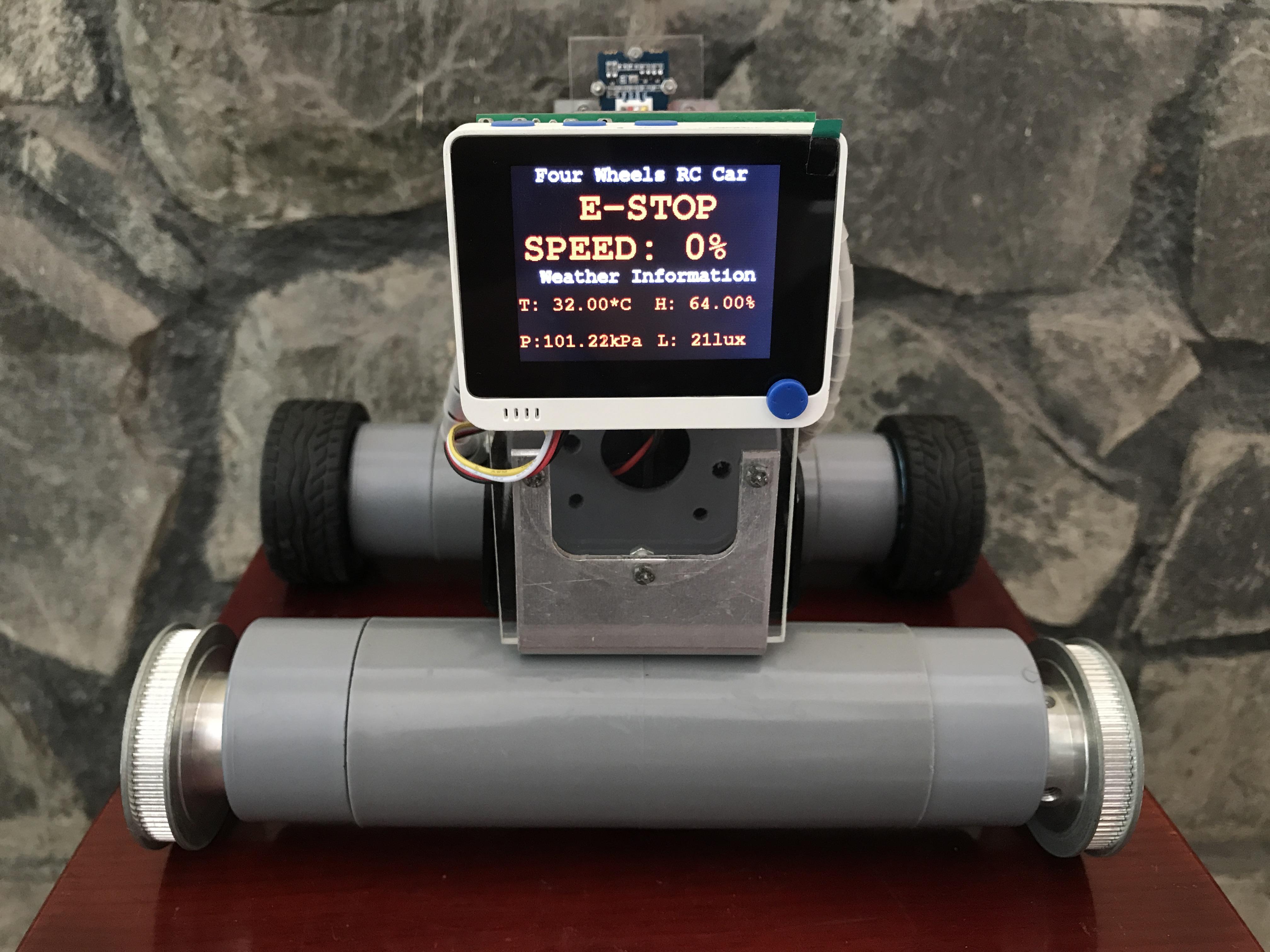

And the movement command is also printed accordingly on the Wio Terminal screen.

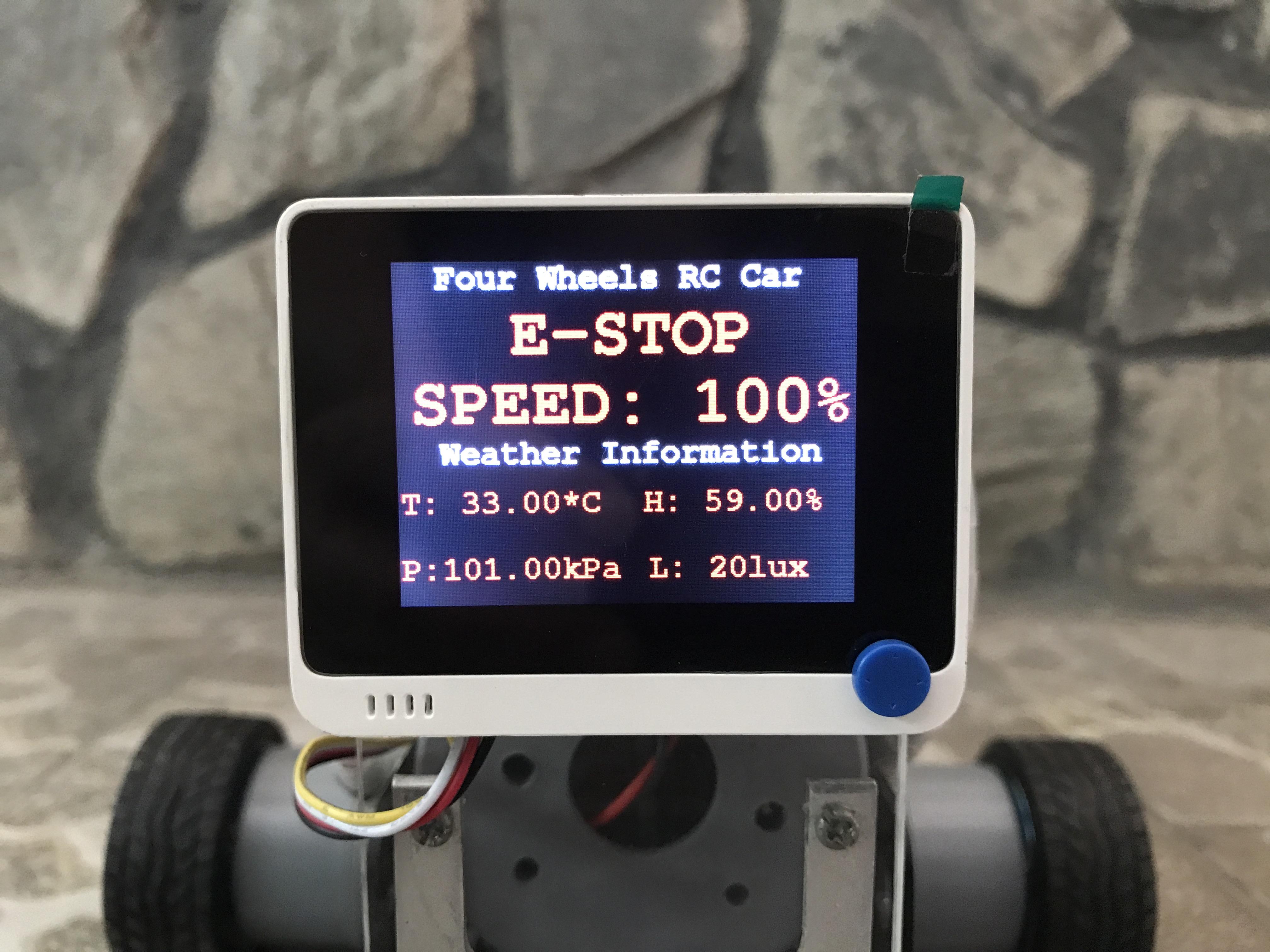

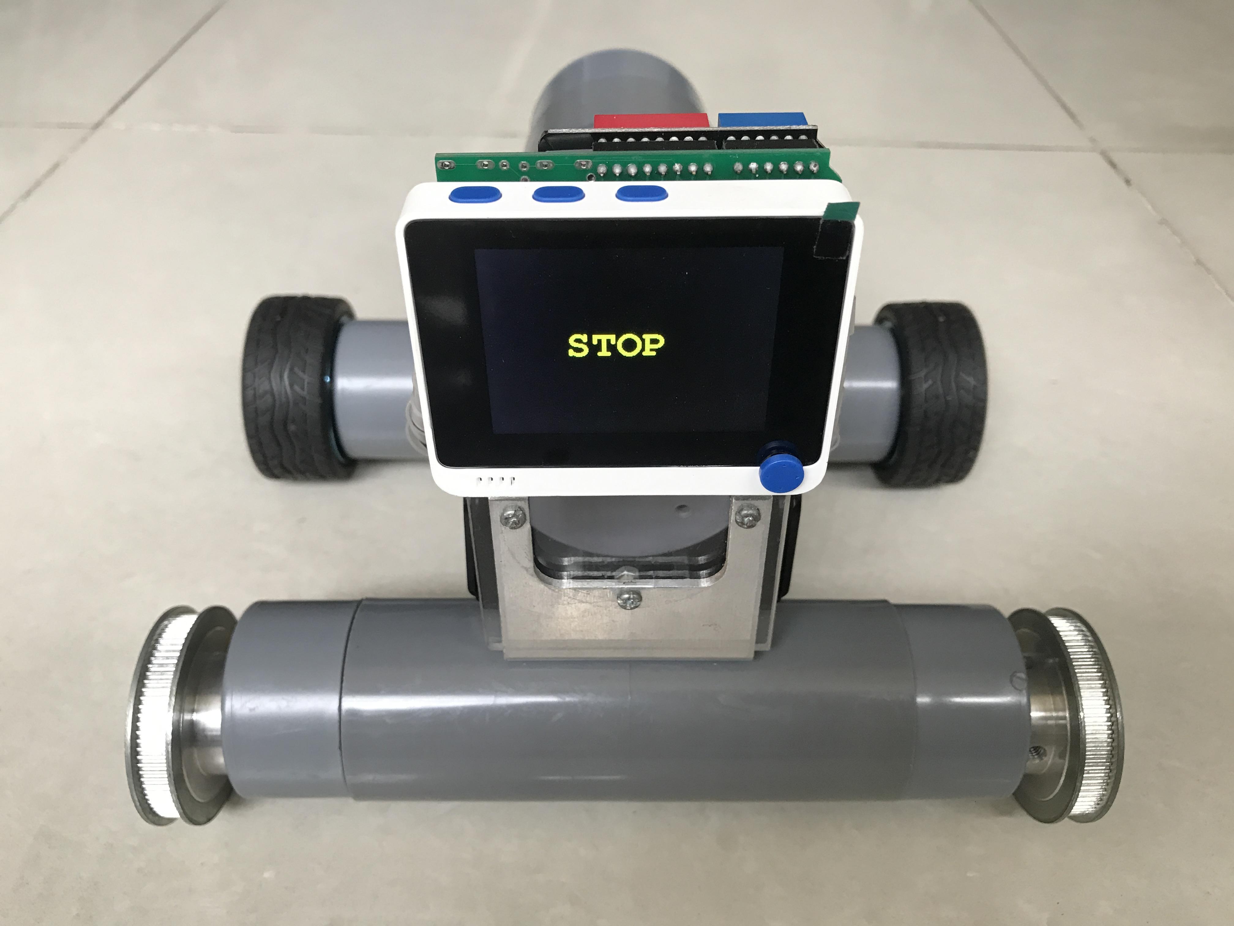

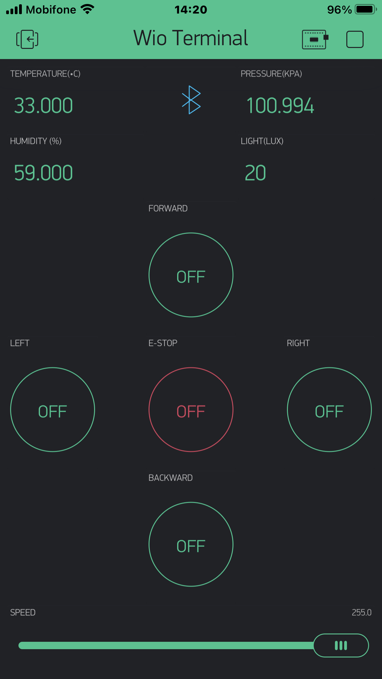

Step 12: Blynk & Wio Terminal Screen
a. Wio Terminal LCD
⦾ Below the header "Four Wheel RC Car", it shows:
- Status of command FORWARD/ BACKWARD/ TURN RIGHT/ TURN LEFT/ STOP / E-STOP.
- Speed indication in percentage.
⦾ Below the header "Weather Information", it shows the following data:
- Temperature (T).
- Humidity (H).
- Pressure (P).
- Light (L).
b. Blynk screen on smart phone.
The Blynk HMI shows weather information and car control commands in a way that correlates with the Wio Terminal screen.
I used virtual pin in Blynk for E-Stop button. But it is better to program one of built-in physical buttons on the Wio Terminal as a E-Stop button, in case something goes wrong.
