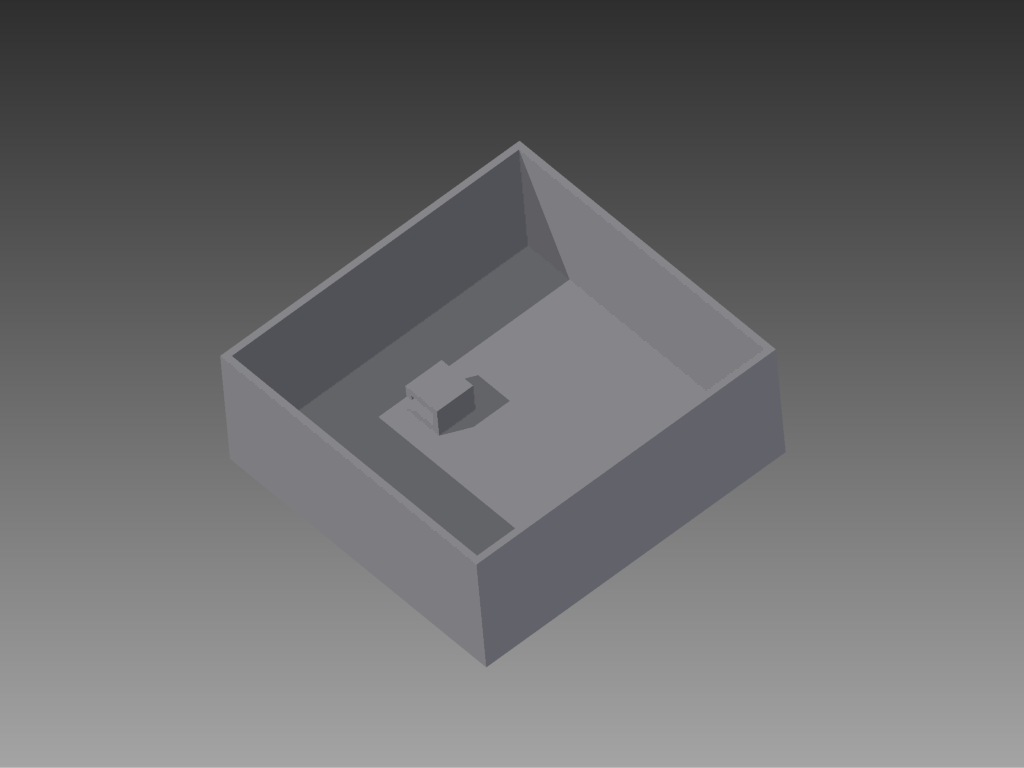

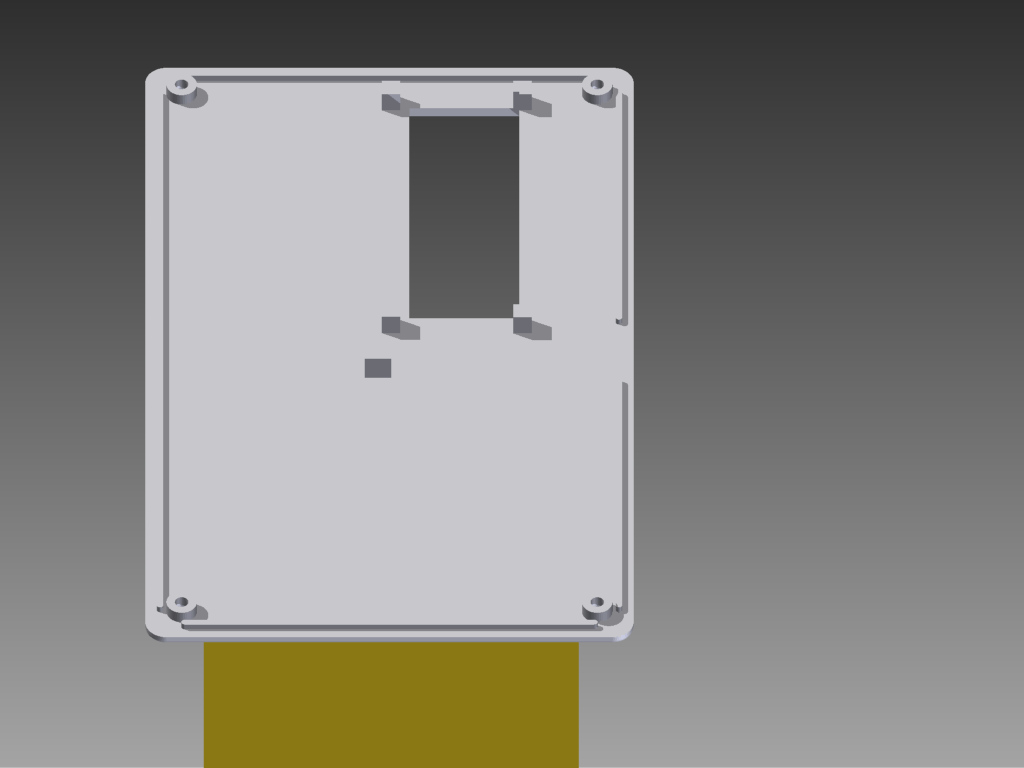

I also 3D printed a lid to fit a box I was given; any 3D part with a Servo holder and the lid of the lock box being bigger will work perfect, also to create supports for the LCD display to be screwed on to be flush with lid. I will post the files for my design feel free to use it as you wish! The software I used was the Arduino IDE and Autodesk Inventor.

Step 2: 3D Printed Parts
All these parts were made using Autodesk Inventor and 3D printed. I included a .zip file of all the parts so as before use it at your desire and make any changes needed. The design is really simple so If you are new to using a CAD software you can try to replicate my design to learn! As in my pictures on the inside of the lid is a lip to act as a key hole that the servo will be able to go in and lock. Also on the inside of the actual lock box a support is needed to hold the servo motor in place!
