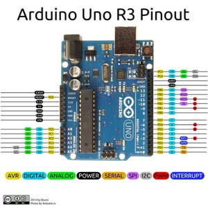

Step 1: Ardiuno Board
Here are some photos of the pin guide as well as what I used for my project. My pins are identicle to the pin out guide, if yours isn't then you will need to ensure which ever pins you use, have the same properties.

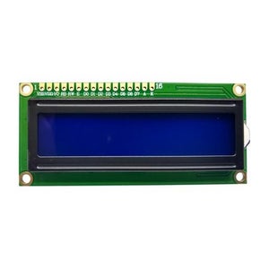

LCD Display
- The first part we will do is the backlight for the lcd screen. By adding on a variable resistor, you can vary the brightness of the screen to how you would like it.
- In the image the yellow wire is soldered onto the third from the right pad (I'll call it pad 3) and the leg by itself for the Potentiometer (POT).
- The left and the right legs of the POT are soldered to the ground (black) and power (red) of channel 2 on the arduino board (if you are using a different board, make sure that your pins are the equivalent to the one I'm using.
- You will need 3 black wires (the colours don't matter but I like to use black for earth) and connect them to LCD pads 1, 5 and 16 (labelled VSS, RW and K. These can go to any black pins as they all earth together.
- Add a red (power) lead to LCD pad 2 (VDD) and connect that to the red pin on channel 0 on the arduino board
- We are going to add a switch which will allow us to turn off the display, which will help save power if you want to run this datalogger out in the field for a few days/weeks
- Run a wire (blue/green in the photo) from LCD pad 15 (A) to a small resistor and then that to one end of the slide switch. To the middle pin of the slider switch connect a wire and run that to the power pin on channel 4 on the Arduino board

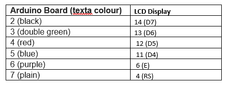

- Next you will need 6 wires and these are outlined where they need to go in the LCD Wiring table
(when I set this up it used a guide from another website - https://create.arduino.cc/projecthub/ThomTronics/easily-wire-a-16x2-lcd-222328)

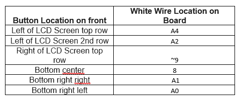

Step 5: Buttons
Buttons
- The buttons had a straight forward layout. On one side of the buttons there are 2 legs and I wired in a white wire, on the other side there are 2 legs, one wire got a power (red) and the other had a ground (black) with a 100k ohm resistor between it and the button
- The reds (5v) can attach to any 5v power location, the black can go to any GND location but the white wires go to the following places
The Wiring table can be found here

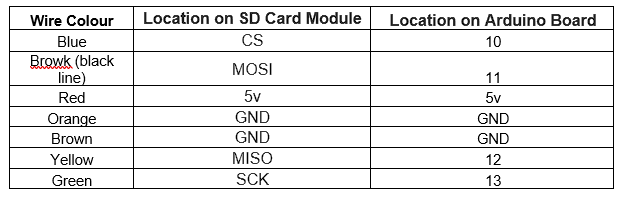

Step 6: SD Card Reader
SD Card Reader
- Similar to the other parts above. The SD card reader has the following pinout guide
