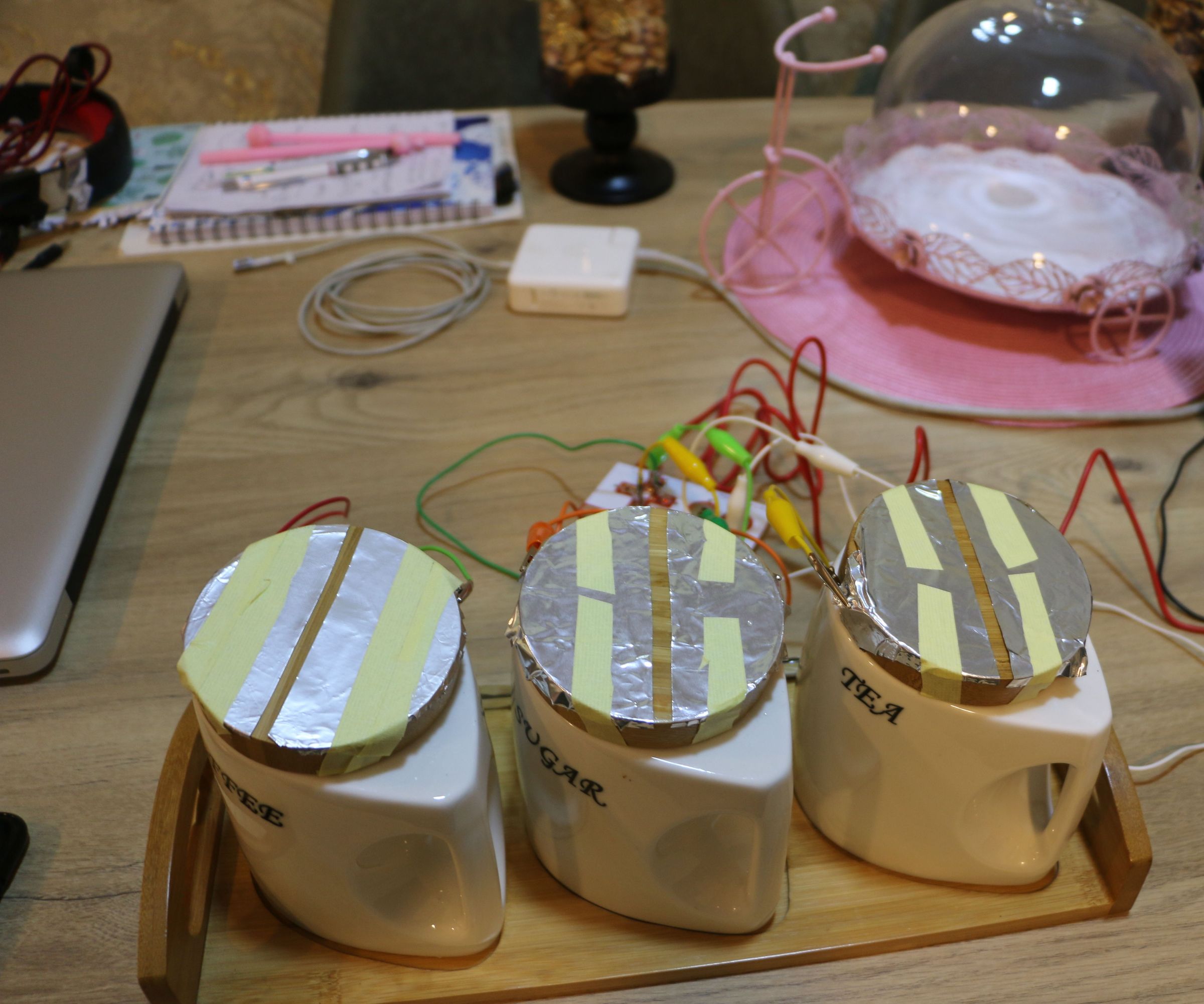

1- aluminum foil
2- tape (duct tape, masking tape, or scotch tape)
3- scissors
4- cardboard
Step 2: Design Stage

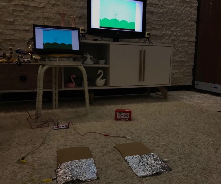

The first step in this stage wrap the aluminum foil around the cardboard As shown in the picture 1. This aluminum foil is a good Conductive material. Then make some Tape up the aluminum foil To ensure that it does not move.
The second step in this stage Install the two pieces of cardboard on the ground by the tape As shown in the picture 2 and 3.
The third step of this stage join the MakeyMakey hardware with the two pieces of cartoon by the wires As shown in the picture 4 and 5. and join the space port in the MakeyMakey with the upper cardboard from the side that warp by aluminum and join the earth port in the Makeymakey with the another cardboard so from the side that warp by aluminum.

Step 4: The Test Stage
The final stage is test the project
The first step
connect the MkaeyMakey hardware with computer by USB cable and open the Scratch 3 then press the green flag button in the scratch platform the by feet press on the upper cardboard and make it touch with the second cardboard from the aluminum side then we will see the open and when we We pull our feet from the cardboard the door closed. as shown in the video
