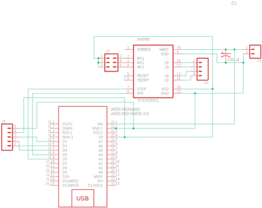

The logical choice to do this is to use a small and cheap microcontroller like the arduino nano, a stepper motor Nema 11, a simple stepper driver like the A4988 and a rotary encoder, in this case I chose the KY-040 as it comes mounted on a board. which includes two resistors.
  • Arduino nano
  • A4988 stepper driver
  • KY-040 rotary encoder
  • 100 µF electrolytic capacitor
  • 2 pin screw terminal block
  • 5 pin Dupont terminal
  • some male and female pin header

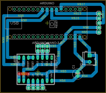

Step 1: The Board
This is one of my first jobs with eagle so I apologize for any mistakes I may have made. You can build the circuit on a breadboard a perfboard or make your own board with the gerber files from my github Gerber files
Step 2: Building It Up
I have a CNC router that I built myself so I made my own board. The arduino and the driver are mounted on pin headers, also the rotary encoder to test it, then I use that pin header to plug in a cable and mount the rotary encoder on a wooden base and also the hand crank.
The circuit board is mounted on the back of the automaton next to the nema 11 stepper motor. I used a single layer board so the only connection that goes through the upper side is made with this red wire.
