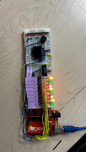

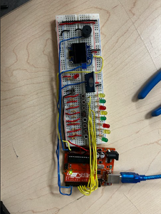

Step 1: Adding Components to the Breadboard & Wiring
Above is an image of how the breadboard should look

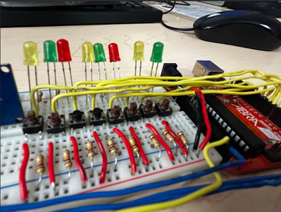

1.Like the image above, you want to start off by adding all the components that are needed onto the breadboard and spacing them accordingly (follow the image above)
  1. Make sure the Anode side of the LED is in the same line as the power going into the push button - this will allow the LED to get the power from the push button
  2. Also make sure that the Cathode side of the LED is NOT connected to the negative side of the push button
  3. Follow these steps carefully so that there is conflicting current! (which could cause a short circuit)
2.Add the power wires (positive) to one side of each push button going into the positive rail on the breadboard. Likewise, add 10k Ω resistors to the negative side of each push button going into the negative rail on the breadboard (like the one in the image).
3. Add a 330k Ω resistor to each of the negative sides of the LED's which has the other side of the resistor going into the negative rail on the other side of the board.
4.Connect the ground wire to one of the pins on the slide switch and have another black wire which goes from the middle pin of the switch to the negative rail on the board - this creates the on/off system for the piano.
5.Connect the wires for the touch sensor:
Vvc --> positive rail
Gnd --> negative rail
Sig--> connecting to pin 2 on Arduino
6.Connect wires for OLED display:
Vdd --> positive rail
Sck --> connecting to pin A5 on Arduino
Sda --> connecting to pin A4 on Arduino
7.Connect wires for buzzer:
Gnd --> Negative rail
Positve --> Connecting to pin 3 on Arduino

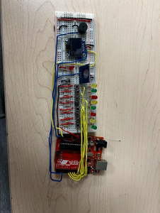

8.Lastly, connect a power wire from the Arduino (5.5V) to the positive rail on the board so that the circuit can get power to run.
  1. Don't forget to add a positive and negative wire on the last lane on the breadboard so that power can be running throughout the circuit/board.
Step 2: Wiring the Push Buttons to the Arduino
Now that you have all the components on the breadboard and the wires for the other components are connected to the Arduino pins, the last part of the wiring is to connect the push buttons to the Arduino Pins. Make sure the wires are connected between the LED and the push button; with the wire connecting to the output side of the push button and not the negative side of the LED to ensure there is no conflicting current.
Listed below are all the Arduino Connections for the push buttons.
Button 1 = 12
Button 2 = 13
Button 3 = 11
Button 4 = 10
Button 5 = 9
Button 6 = 8
Button 7 = 7
Button 8 = 6
